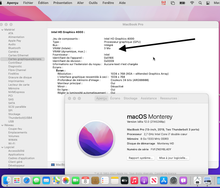

chris1111 Posted June 8, 2021 Share Posted June 8, 2021 20 minutes ago, pompis12 said: Hello... I have managed to install Monterrey on a Lenovo T430 kext AirportItlwm_v1.3.0_stable_BigSur does not work Bluetooth I had to deactivate it in bios but it does not reach the installation screen And obviously the intel HD4000 iGPU doesn't work either (((( It works because I have put in EFI / OC / Kext / -AppleIntelFramebufferCapri.kext -AppleIntelHD4000Graphics.kext But only partially))) How could I put the Big Sur Intel HD4000 drivers in this version of MacOS ??? I leave some captures: Reveal hidden contents If you find the solution let me known same issue on my Probook 6570 b Apple Drop support HD 4000 1 2 Link to comment https://www.insanelymac.com/forum/topic/348725-pre-release-macos-monterey/page/5/#findComment-2760232 Share on other sites More sharing options...

miliuco Posted June 8, 2021 Share Posted June 8, 2021 40 minutes ago, chris1111 said: If you find the solution let me known same issue on my Probook 6570 b Apple Drop support HD 4000... Yes Chris it seems that it isn't working with Intel HD4000 At least for now. 39 minutes ago, PMheart said: In my opinion, please use the current release with beta flag, until 2021.07 has been released in July. Thanks for the recommendation. 1 Link to comment https://www.insanelymac.com/forum/topic/348725-pre-release-macos-monterey/page/5/#findComment-2760237 Share on other sites More sharing options...

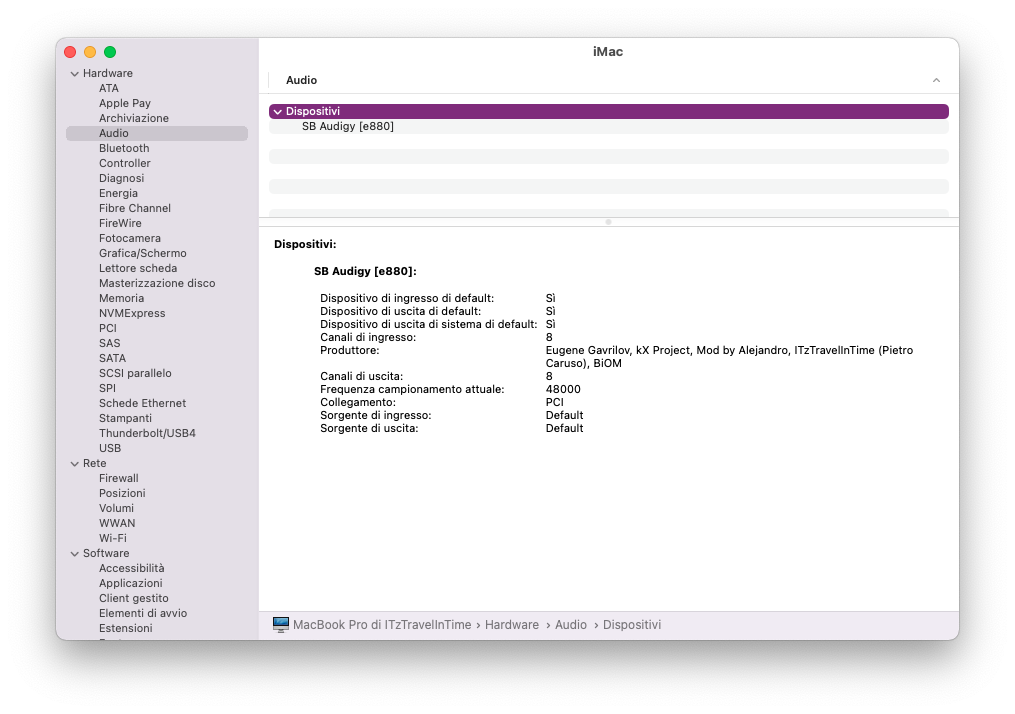

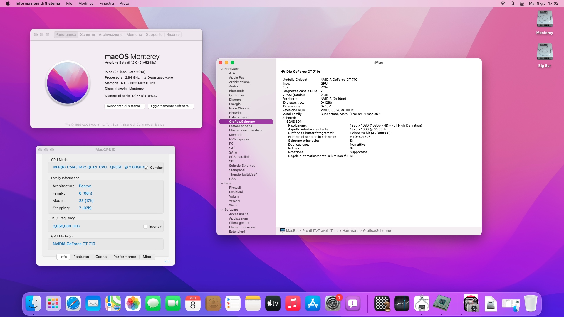

ITzTravelInTime Posted June 8, 2021 Share Posted June 8, 2021 (edited) Here we go, socket 775 with nvidia kepler GPU still working here, it seems that not so much has changed under the hood, but i still having problems with HID devices like in Big Sur. Also by installing the driver in /Library/Extensions the kXAudioDriver still works and so my SB audigy works too. Spoiler Edited June 8, 2021 by ITzTravelInTime 2 Link to comment https://www.insanelymac.com/forum/topic/348725-pre-release-macos-monterey/page/5/#findComment-2760239 Share on other sites More sharing options...

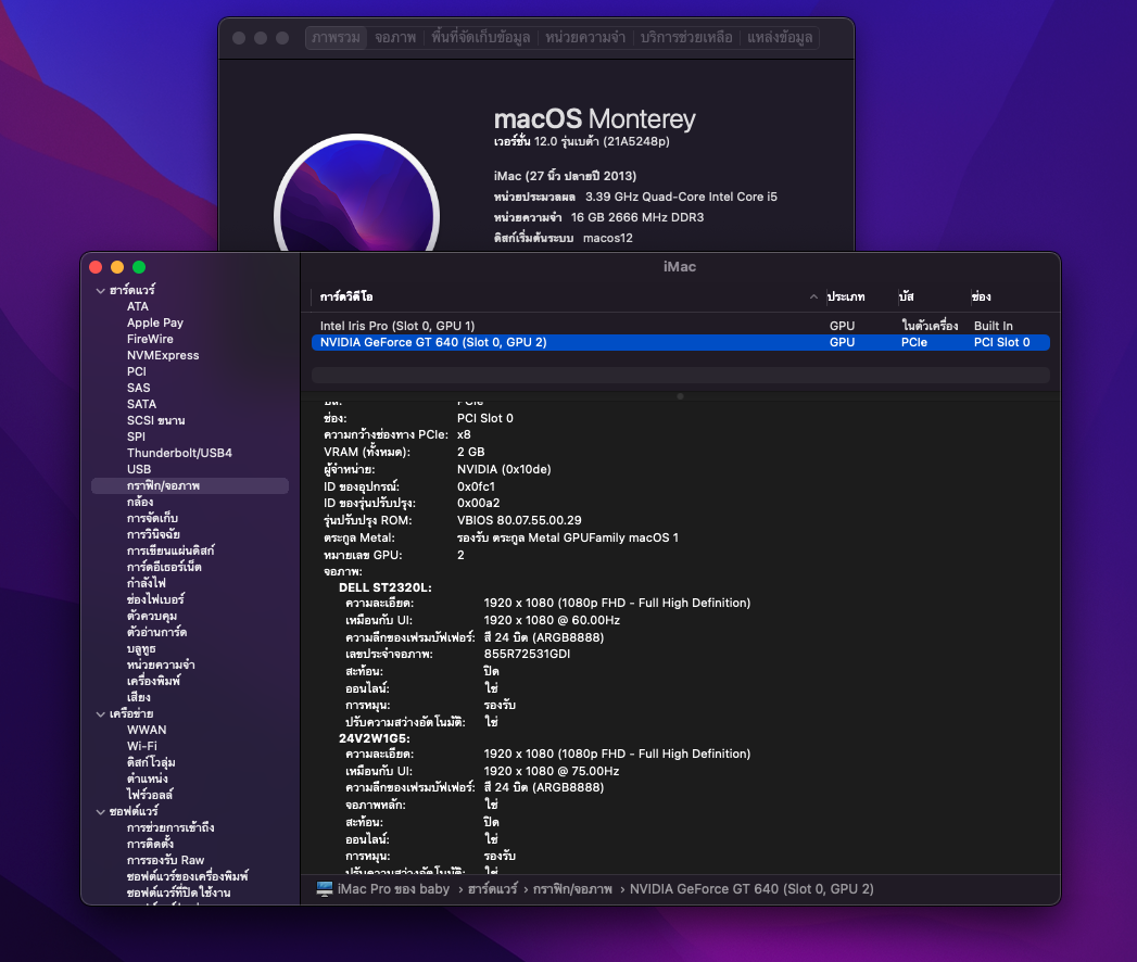

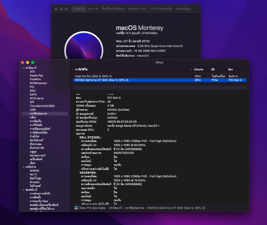

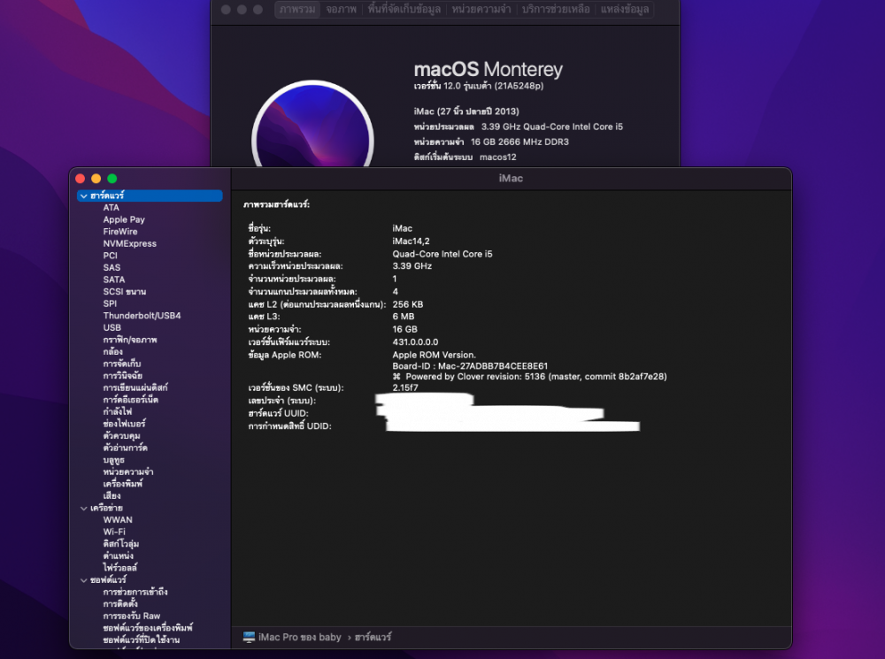

naiclub Posted June 8, 2021 Share Posted June 8, 2021 (edited) 2 hours ago, 1Ale1 said: Hi, I'd like to inform everybody that even though Apple reports that the minimum iMac version for Monterey is iMac16,1 (Late 2015, with Broadwell or later), Azul graphics drivers are still present in macOS 12, and the only parameter necessary to boot the system is -no_compat_check And then the installer works perfectly, does not complain about iMac15,1 SMBIOS which I am currently using.😁 The repository can be found here: https://github.com/1alessandro1/HP-Prodesk-600-G1-SFF-macOS I'll soon merge the 0.7.0 branch to master Thank you give me more lively. Now I can boot the iMac14.2 smoothly. Plus, the sound is very complete. Edited June 8, 2021 by naiclub 3 Link to comment https://www.insanelymac.com/forum/topic/348725-pre-release-macos-monterey/page/5/#findComment-2760244 Share on other sites More sharing options...
HenryV Posted June 8, 2021 Share Posted June 8, 2021 (edited) 17 hours ago, Hervé said: 'found that WEG's -wegbeta boot arg was also necessary to avoid KP on wake on my SKL HD520 laptop. Do you have HDMI audio and can you please post the config.plist for intel 520 Skylake? 2 hours ago, pompis12 said: Hello... I have managed to install Monterrey on a Lenovo T430 kext AirportItlwm_v1.3.0_stable_BigSur does not work Bluetooth I had to deactivate it in bios but it does not reach the installation screen And obviously the intel HD4000 iGPU doesn't work either (((( It works because I have put in EFI / OC / Kext / -AppleIntelFramebufferCapri.kext -AppleIntelHD4000Graphics.kext But only partially))) How could I put the Big Sur Intel HD4000 drivers in this version of MacOS ??? I leave some captures: Reveal hidden contents Have had trouble with the AirportItlwm.kexts loading in Open Core, switched to Clover and working for 3165 both Big Sur and Catalina. Edited June 8, 2021 by HenryV Link to comment https://www.insanelymac.com/forum/topic/348725-pre-release-macos-monterey/page/5/#findComment-2760245 Share on other sites More sharing options...

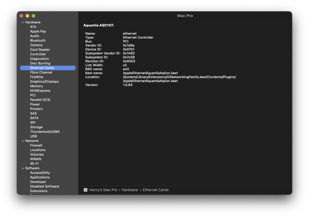

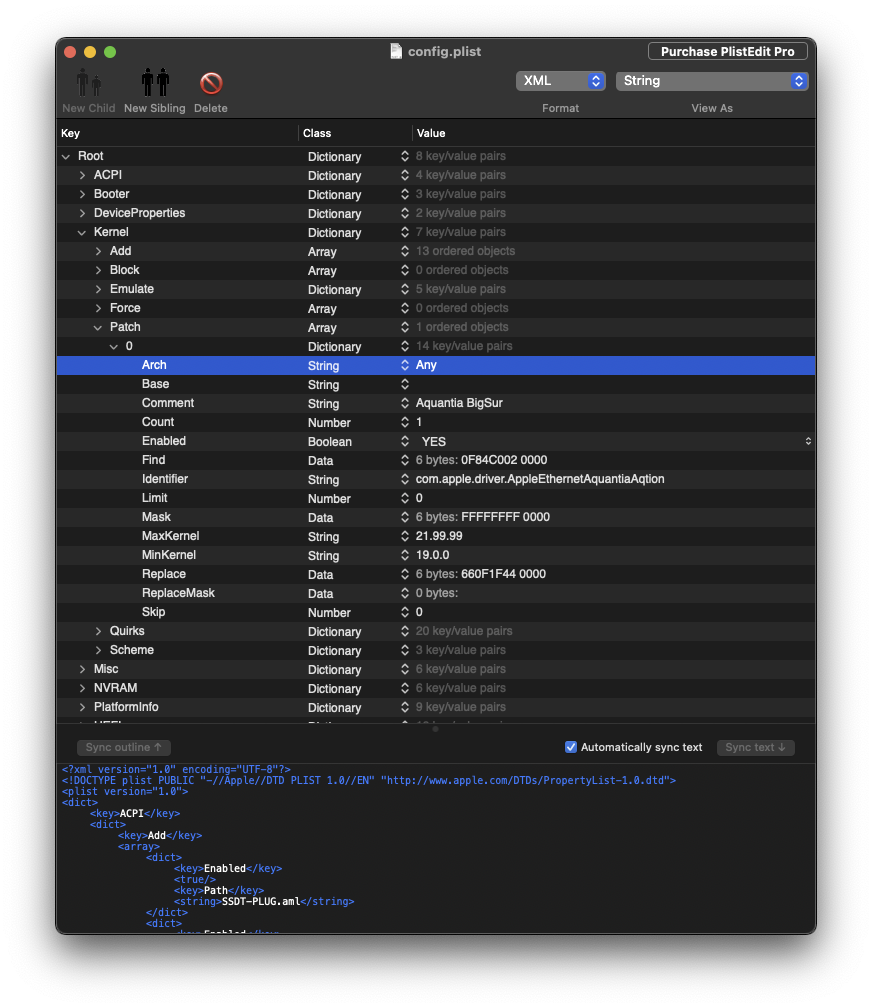

yapan4 Posted June 8, 2021 Share Posted June 8, 2021 (edited) 3 hours ago, iTTT said: hello guys, does AQC107 works on new beta? thanks. No, probably new patch is needed. Look appropriate topic https://www.insanelymac.com/forum/topic/330614-marvell-aquantia-10-gb-ethernet-support-thread/page/15/#elControls_2760169_menu Update: This patch works https://www.insanelymac.com/forum/topic/330614-marvell-aquantia-10-gb-ethernet-support-thread/?do=findComment&comment=2760231 Edited June 8, 2021 by yapan4 1 Link to comment https://www.insanelymac.com/forum/topic/348725-pre-release-macos-monterey/page/5/#findComment-2760249 Share on other sites More sharing options...

Pavo Posted June 8, 2021 Share Posted June 8, 2021 24 minutes ago, yapan4 said: No, probably new patch is needed. Look appropriate topic https://www.insanelymac.com/forum/topic/330614-marvell-aquantia-10-gb-ethernet-support-thread/page/15/#elControls_2760169_menu Working fine for me! 3 Link to comment https://www.insanelymac.com/forum/topic/348725-pre-release-macos-monterey/page/5/#findComment-2760254 Share on other sites More sharing options...
yapan4 Posted June 8, 2021 Share Posted June 8, 2021 4 minutes ago, Pavo said: Working fine for me! Hi, @Pavo OOB? The "old" patch or "new" one? Or some other fix? Link to comment https://www.insanelymac.com/forum/topic/348725-pre-release-macos-monterey/page/5/#findComment-2760255 Share on other sites More sharing options...
Pavo Posted June 8, 2021 Share Posted June 8, 2021 4 minutes ago, yapan4 said: Hi, @Pavo OOB? The "old" patch or "new" one? Or some other fix? Same patch as always. 2 Link to comment https://www.insanelymac.com/forum/topic/348725-pre-release-macos-monterey/page/5/#findComment-2760256 Share on other sites More sharing options...
