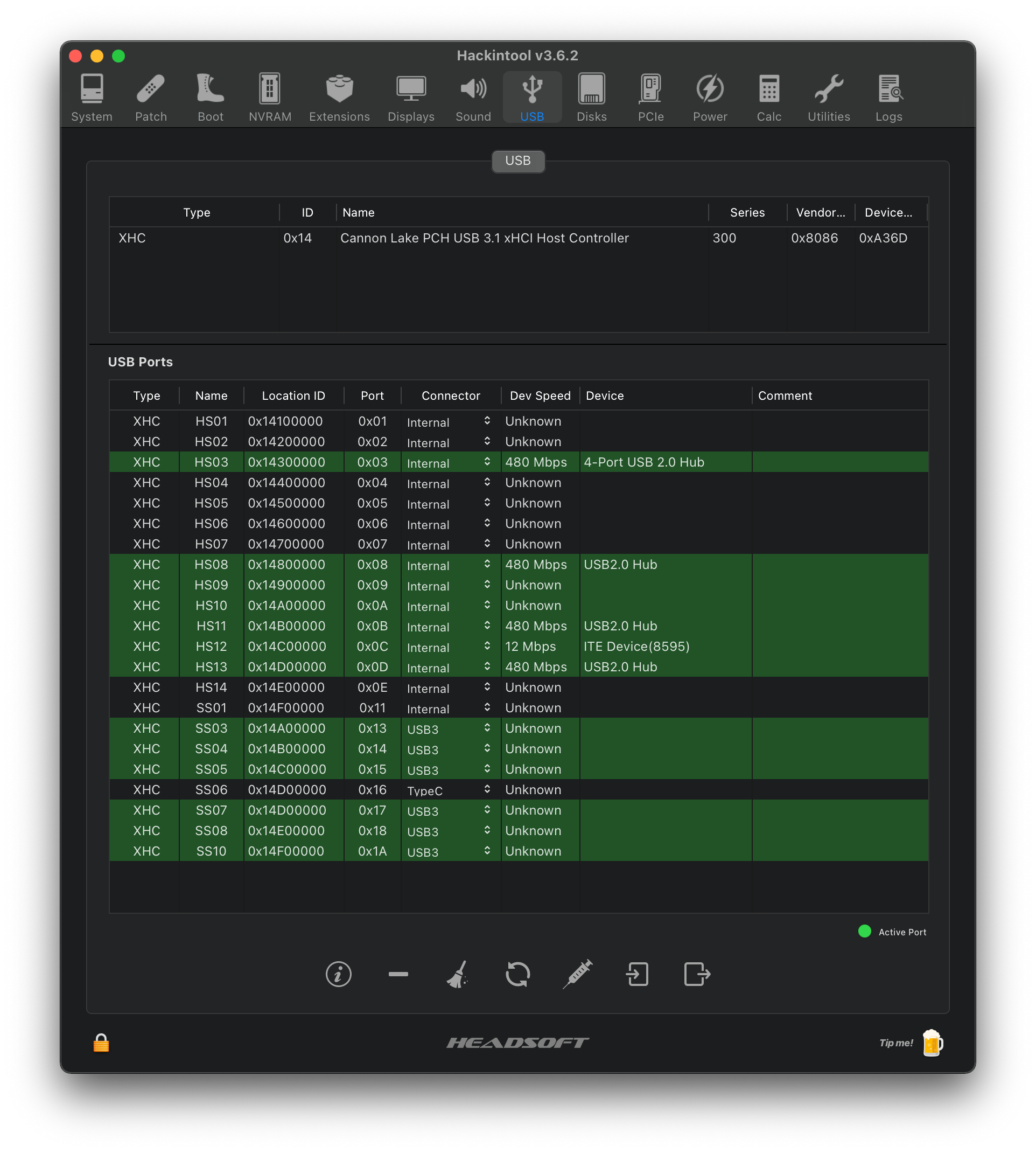

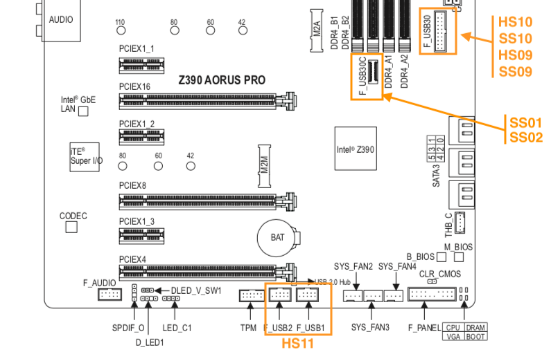

AudioGod Posted May 24, 2021 Author Share Posted May 24, 2021 (edited) 5 minutes ago, eSaF said: Ok B - I wasn't sure how his setup is whether he's using the builtin one or an independent card either way how much would it hurt for him to try it one way or another? At this stage, nothing to lose but in reality he should try and map his USB layout for a better result. All you got to do is disable your current USBMap.kext (use injectall or enable the quirk) restart the system and enable the internal WiFi card then boot back up and use hackintool to export the map with the Bluetooth USB port now enabled then open the newly created kext and find the extra port, copy it and paste it into your current kext and done. It will then work. There’s no other way if it’s not mapped in the first place though bud. Edited May 24, 2021 by AudioGod 1 Link to comment Share on other sites More sharing options...
eSaF Posted May 24, 2021 Share Posted May 24, 2021 2 minutes ago, dsynos80 said: Wow that was fast!! Thank you both! esaf your usb map didnt work for me. it also disabled my top usb2.0 ports. And yes i have the Wifi Version and trying to use the intel CNVi. Ah, i see you use 1.1 i use 19.1 Yes my setup is based on the 1.1 pro also as I stated I am using a compatible OS X WIFI/B-Tooth card, sorry it didn't work out for you. Have a go at mapping your USB outlay it's not that hard. Good luck. Link to comment Share on other sites More sharing options...
AudioGod Posted May 24, 2021 Author Share Posted May 24, 2021 6 minutes ago, dsynos80 said: Wow that was fast!! Thank you both! esaf your usb map didnt work for me. it also disabled my top usb2.0 ports. And yes i have the Wifi Version and trying to use the intel CNVi. Ah, i see you use 1.1 i use 19.1 Give me a few mins and let me see if I can work out what port to add to get the Bluetooth working. Shouldnt be that hard to figure out. BRB 1 Link to comment Share on other sites More sharing options...
AudioGod Posted May 24, 2021 Author Share Posted May 24, 2021 I think it’s HS14 Link to comment Share on other sites More sharing options...
eSaF Posted May 24, 2021 Share Posted May 24, 2021 2 minutes ago, AudioGod said: I think it’s HS14 That's correct B Link to comment Share on other sites More sharing options...
dsynos80 Posted May 24, 2021 Share Posted May 24, 2021 No problem esaf, your info and effort has been very helpful to me in the past. i dont see HS14 in hackintool. Wifi card is enabled and working in Osx, in windows it also works and blueooth too. Link to comment Share on other sites More sharing options...
eSaF Posted May 24, 2021 Share Posted May 24, 2021 Just now, dsynos80 said: No problem esaf, your info and effort has been very helpful to me in the past. i dont see HS14 in hackintool. Wifi card is enabled and working in Osx, in windows it also works and blueooth too. You need to enable all ports for it to show up as AG suggested. Link to comment Share on other sites More sharing options...
AudioGod Posted May 24, 2021 Author Share Posted May 24, 2021 @dsynos80 Try this USBMap.kext.zip 1 Link to comment Share on other sites More sharing options...
eSaF Posted May 24, 2021 Share Posted May 24, 2021 1 minute ago, AudioGod said: @dsynos80 Try this USBMap.kext.zip 2.71 kB · 0 downloads Don't forget to clean NvRAM at reboot. 1 1 Link to comment Share on other sites More sharing options...
dsynos80 Posted May 24, 2021 Share Posted May 24, 2021 (edited) I did it guys! It was HS14! I pressed inject at hackintool and it showed up. Then i exported usbports kext and got the info to put on Usbmap kext! All good to go so many thnx guys! OC is Nuke Tech for me now, as was moving from Chameleon to Clover. a question if you please... what about all the other ports that showed up on hackintool when i pressed inject? I know about the 15 port limit, but should i add the missing ones too? i think all my ports are working now. Edited May 24, 2021 by dsynos80 Link to comment Share on other sites More sharing options...
