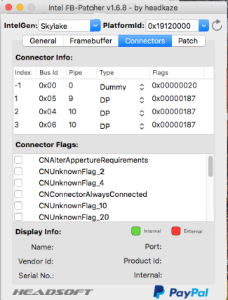

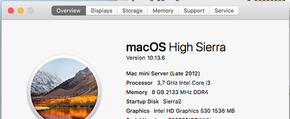

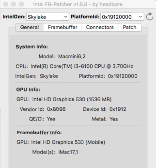

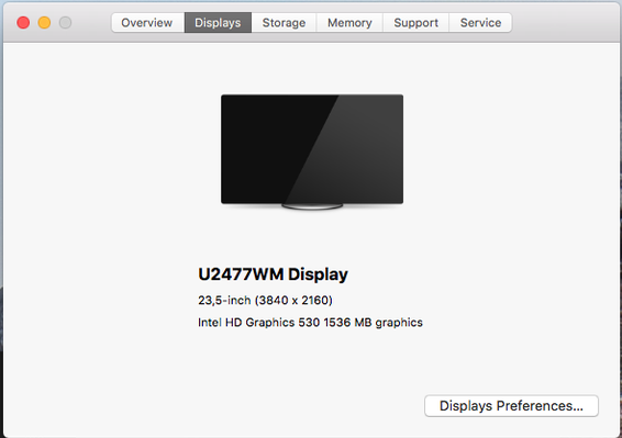

vzmr82 Posted January 2, 2019 Share Posted January 2, 2019 (edited) I have been trying to get my 2 years hold hackintosh, now at 10.13.6, properly updated to fully accelerated graphics. Specs: Asus H110T, i3-6100, 8GB RAM, SSD 500Gb. Connected to a 4k AOC U2477PWQ display through DP. I get acceleration OK, but no video signal on my display. The connectors as shown by FB-Patcher are: Running /System/Library/Extensions/AppleGraphicsControl.kext/Contents/MacOS/AGDCDiagnose -a I get the information that the display is connected to Port 2: AGDCDiagnose Version: 3.20.13 ## ScanPort - Start ## [1] IOService:/IOResources/AppleGPUWrangler Vendor: Apple [0000106b]: AppleGPUWrangler [8 10000] (0) [2] IOService:/AppleACPIPlatformExpert/PCI0@0/AppleACPIPCI/IGPU@2/AppleIntelFramebufferController/IntelFBClientControl Vendor: AppleIntelFramebufferController [0000106b]: IntegratedGPU [1 10000] (0) FBs: 3 Ports: 0xe mst:0x1c ddc:0x1c aux:0x1c Streams: dp:0 dvi:0 mst:2 max:3 FB: 00 : Group: 0 Address[ 0.0], Flags:[offline ], Stream:N/A FB: 01 : Group: 0 Address[ 0.0], Flags:[offline ], Stream:N/A FB: 02 : Group: 0 Address[ 0.0], Flags:[offline ], Stream:N/A Port: 01 : empty Port: 02 : device present [TMDS] Port: 03 : empty ## Register Dump Port 2 - Start ## Error: AUX CMD: 0,16 = Error, 2 Error: AUX CMD: 20,3 = Error, 2 What should I be doing regarding the Connectors and their flags, to get a video signal on the monitor? Thanks in advance. Update: With 0x193B0000 platform-id and connected through DP, sometimes I can image on my display. Usually, after booting, there is no signal. I log in remotely - using a KVM switch, I use a different computer with Screen Sharing, sharing the same monitor. Switching back to this Hackintosh, as I say, sometimes I get signal on the monitor, sometimes I don't. In this case, going to System Preferences / Display and pressing "Detect Displays", (through Screen Sharing, of course), usually I get signal back - but not always. Which indicates that maybe 0x193B0000 this isn't the right platform-id... If I try with 0x193B0005, I also get this result, but the display is mapped as an internal display... Any ideas and comments are welcome. Thanks. Edited January 6, 2019 by vzmr82 Further experiments results... Link to comment https://www.insanelymac.com/forum/topic/335018-hackintool-v3xx/page/9/#findComment-2656867 Share on other sites More sharing options...

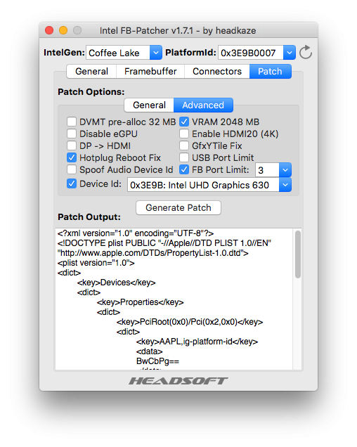

Deibu Posted January 11, 2019 Share Posted January 11, 2019 I've been trying to get an internal display working of a device that has an Intel m3-8100Y (Amber Lake) CPU with UHD615 graphics. As Amber Lake isn't an option in FB Patcher, would there be an alternative I can use, or perhaps specify a custom ID somewhere (and if so, which custom ID) to try to get it to work? A bit of background; The internal display shows something when I don't configure the IGPU, so there's no hardware acceleration and it only has a few MB of vram, but when I configure it so far I'm only able to get it to work if an external (HDMI over USBC) display is plugged in, the internal screen always stays black. I feel like I'm so close to getting it to work, but I'm missing one thing! The patch I'm able to create with fb-patcher is most definitely missing something due to the Amber Lake thing. (In case you need more info, I've shared some logs and whatnot here). Thank you! Link to comment https://www.insanelymac.com/forum/topic/335018-hackintool-v3xx/page/9/#findComment-2658453 Share on other sites More sharing options...
headkaze Posted January 11, 2019 Author Share Posted January 11, 2019 (edited) 1 hour ago, Deibu said: would there be an alternative I can use, or perhaps specify a custom ID somewhere (and if so, which custom ID) to try to get it to work? Try using Kaby Lake or Coffee Lake with Patch->Advanced->Device Id to spoof an IGPU. Edited January 11, 2019 by headkaze Link to comment https://www.insanelymac.com/forum/topic/335018-hackintool-v3xx/page/9/#findComment-2658469 Share on other sites More sharing options...

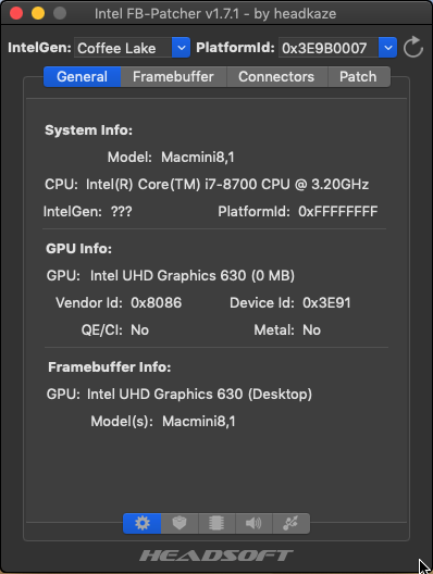

jamvybz Posted January 14, 2019 Share Posted January 14, 2019 (edited) can someone help me i keep getting a back screen when i try to boot i can only boot up using -igfxvesa config.plist Send me HPs-Mac-mini.zip Edited January 14, 2019 by jamvybz adding other files Link to comment https://www.insanelymac.com/forum/topic/335018-hackintool-v3xx/page/9/#findComment-2658990 Share on other sites More sharing options...
