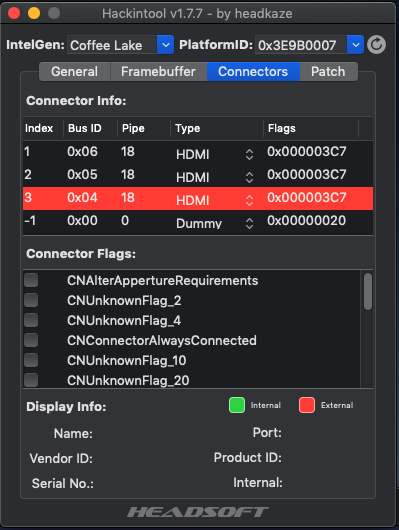

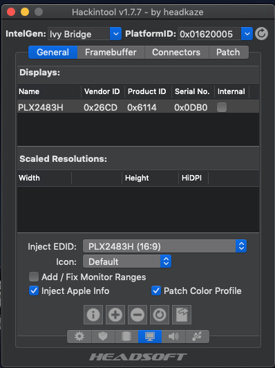

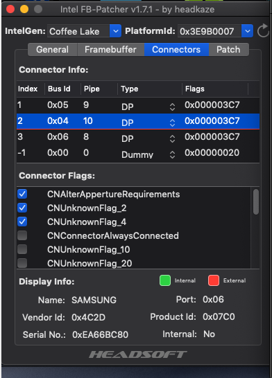

Matgen84 Posted January 18, 2019 Share Posted January 18, 2019 Hi I don't know there isn't Display name for HDMI Intel in General panel. Because my monitor is connected on Nvidia Card, Right? No Display info for HDMI Intel and Nvidia HDMI card in Connector panel. Sorry for my bad english Link to comment https://www.insanelymac.com/forum/topic/335018-hackintool-v3xx/page/14/#findComment-2659766 Share on other sites More sharing options...
headkaze Posted January 18, 2019 Author Share Posted January 18, 2019 6 minutes ago, Matgen84 said: Hi I don't know there isn't Display name for HDMI Intel in General panel. Because my monitor is connected on Nvidia Card, Right? No Display info for HDMI Intel and Nvidia HDMI card in Connector panel. Sorry for my bad english Only displays attached to the Intel video device will show up in the Connectors panel. The General->Display tab will show all displays connected. 1 Link to comment https://www.insanelymac.com/forum/topic/335018-hackintool-v3xx/page/14/#findComment-2659768 Share on other sites More sharing options...

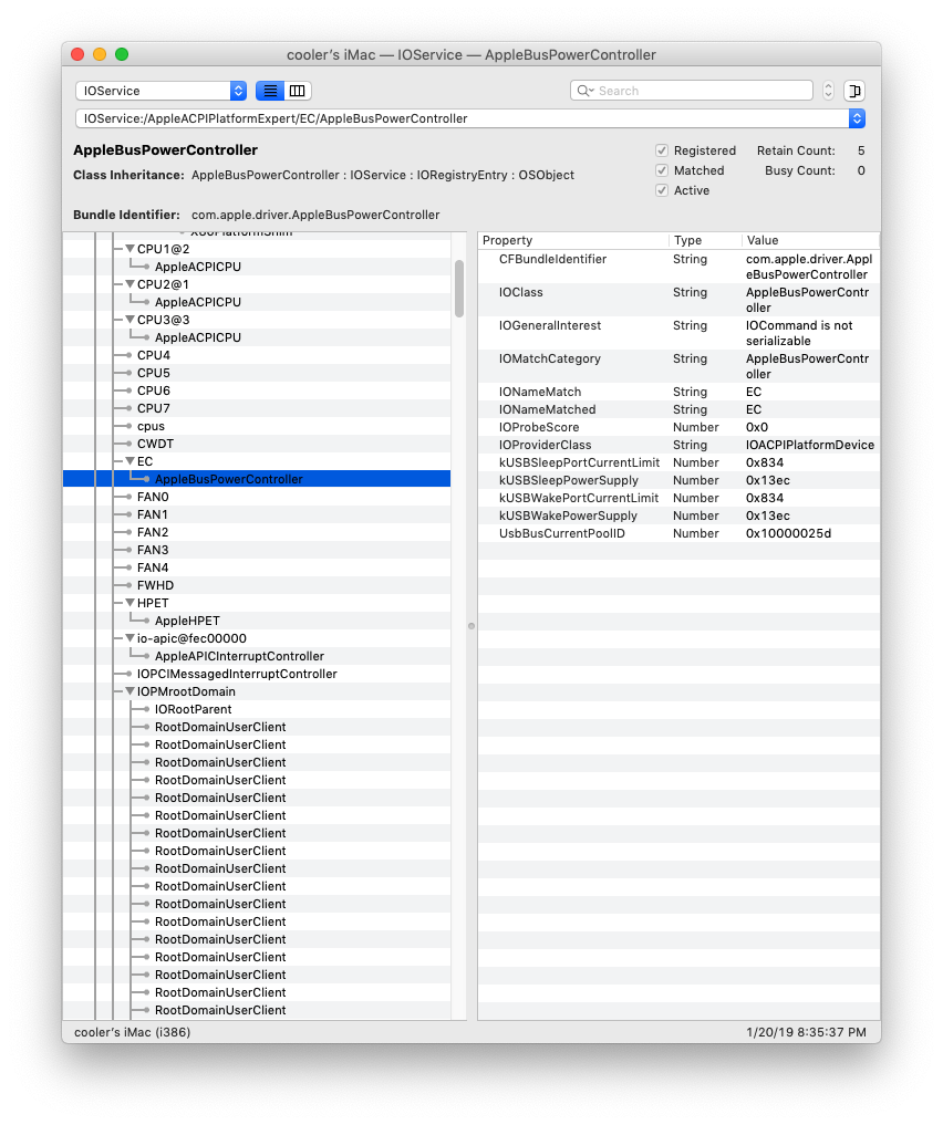

CMMChris Posted January 20, 2019 Share Posted January 20, 2019 @headkaze Those properties provide AppleBusPowerController with necessary information for USB Port power supply. Without those properties ports might not deliver more than 500mA. In addition for it to work the EC device needs a proper ACPI rename. If no EC is precent on the motherboard or the device returns zero, some fake EC device needs to be injected via SSDT. Google it up, there is plenty of information out there. Link to comment https://www.insanelymac.com/forum/topic/335018-hackintool-v3xx/page/14/#findComment-2660057 Share on other sites More sharing options...

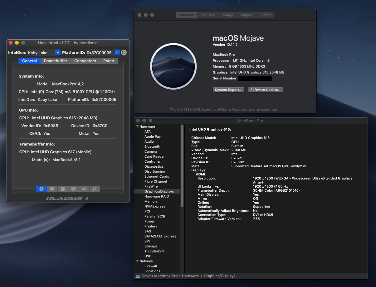

headkaze Posted January 21, 2019 Author Share Posted January 21, 2019 (edited) 23 hours ago, Deibu said: Hi Headkaze! I was wondering; If you use spoofing for the GPU/CPU, should the CPU/GPU information in "About This Mac" or System Information show the spoofed information, or is it normal if it still shows the real hardware there? It's showing the Device ID as 0x87c0 in System Information which means the injection worked. It is showing that the KBL framebuffer loaded correct and you have 2048 MB of VRAM. So that actually looks like it works. Is everything performing okay for you? Edited January 21, 2019 by headkaze Link to comment https://www.insanelymac.com/forum/topic/335018-hackintool-v3xx/page/14/#findComment-2660337 Share on other sites More sharing options...
stehor Posted January 21, 2019 Share Posted January 21, 2019 headkaze there is an app that loads EC AppleBusPowerController called USBMmap that works maybe you can contact the dev corpnewt for help. i have his permission to post this here. https://github.com/corpnewt/USBMap as you can see it works. 1 Link to comment https://www.insanelymac.com/forum/topic/335018-hackintool-v3xx/page/14/#findComment-2660344 Share on other sites More sharing options...

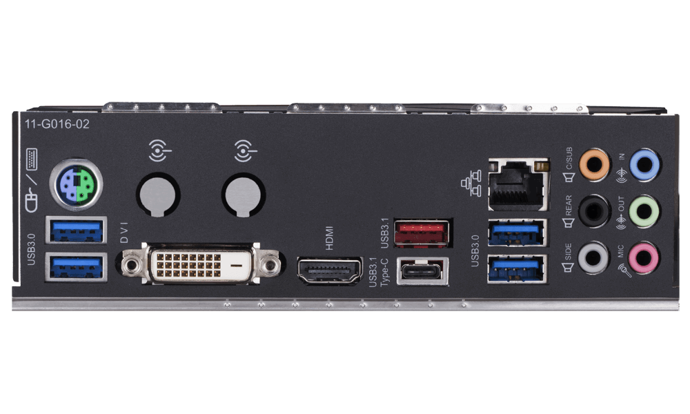

Baio77 Posted January 23, 2019 Share Posted January 23, 2019 (edited) I have the Desktop configuration in signature. https://www.gigabyte.com/Motherboard/Z390-M-GAMING-rev-10#kf my Mobo Originally only video on DVI connector output from the integrated, with the patch I managed to get now I have videos on HDMI connector PERFECT in SMBios Macmini 8.1 and IMac18.1 , with IMac 18.3 screen cursor mouse white color ok and screen Black Gigabyte GA Z390 M Gaming UHD630.zip Without any patches out video DVI only With applied patch out video HDMI only Edited January 23, 2019 by Baio77 Link to comment https://www.insanelymac.com/forum/topic/335018-hackintool-v3xx/page/14/#findComment-2660822 Share on other sites More sharing options...

Deibu Posted January 24, 2019 Share Posted January 24, 2019 On 1/21/2019 at 11:15 AM, headkaze said: It's showing the Device ID as 0x87c0 in System Information which means the injection worked. It is showing that the KBL framebuffer loaded correct and you have 2048 MB of VRAM. So that actually looks like it works. Is everything performing okay for you? Ah I see! Unfortunately not, in this scenario the internal display refuses to show anything, it's not even recognized as being present in macOS, whether I check in display preferences or by using IORegistryExplorer. I was able to get the screenshot made by using an externally plugged in display, which works in this setup when it is plugged in from boot. What would be the best way to debug the internal display not being recognized in this scenario? Link to comment https://www.insanelymac.com/forum/topic/335018-hackintool-v3xx/page/14/#findComment-2660933 Share on other sites More sharing options...

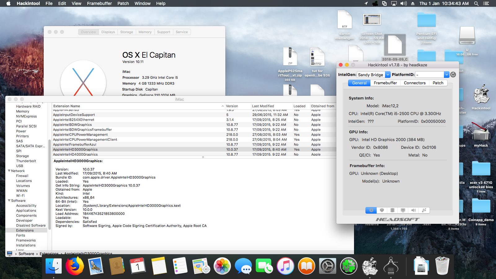

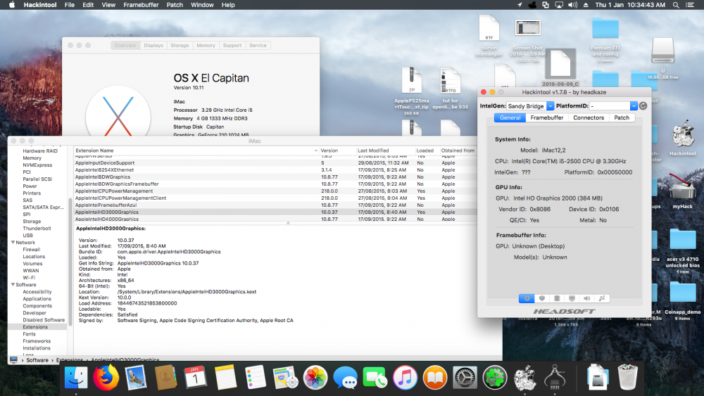

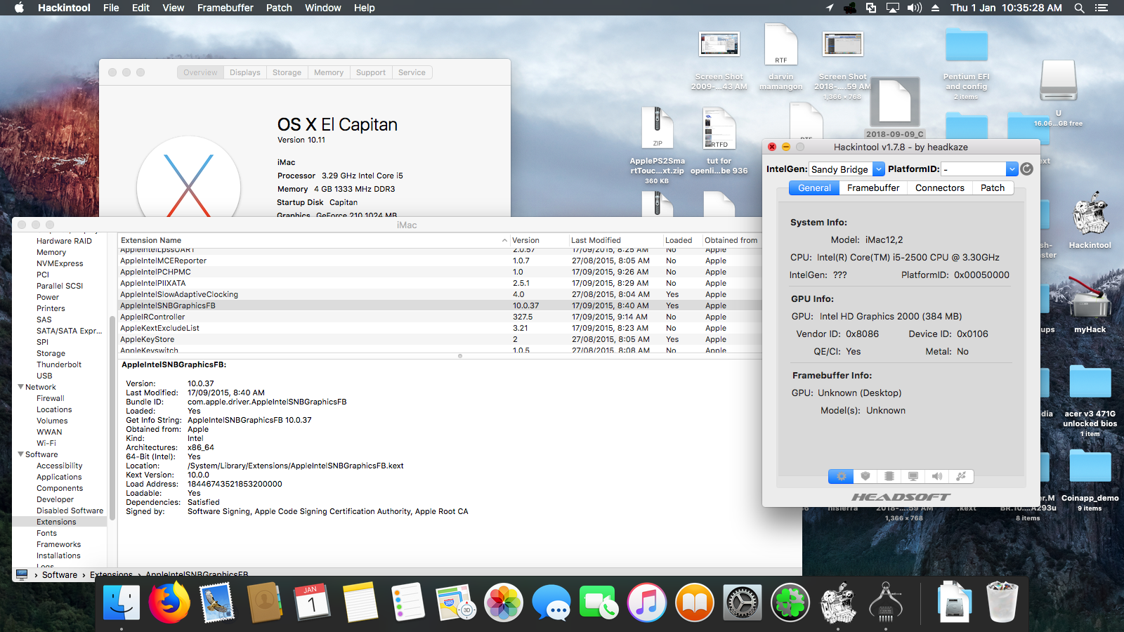

Mc Jacej Posted January 27, 2019 Share Posted January 27, 2019 @headkazecan you check if my intel hd 2000 is working?anyway im using a 7th series asus motherboard iMac.zip Link to comment https://www.insanelymac.com/forum/topic/335018-hackintool-v3xx/page/14/#findComment-2661493 Share on other sites More sharing options...

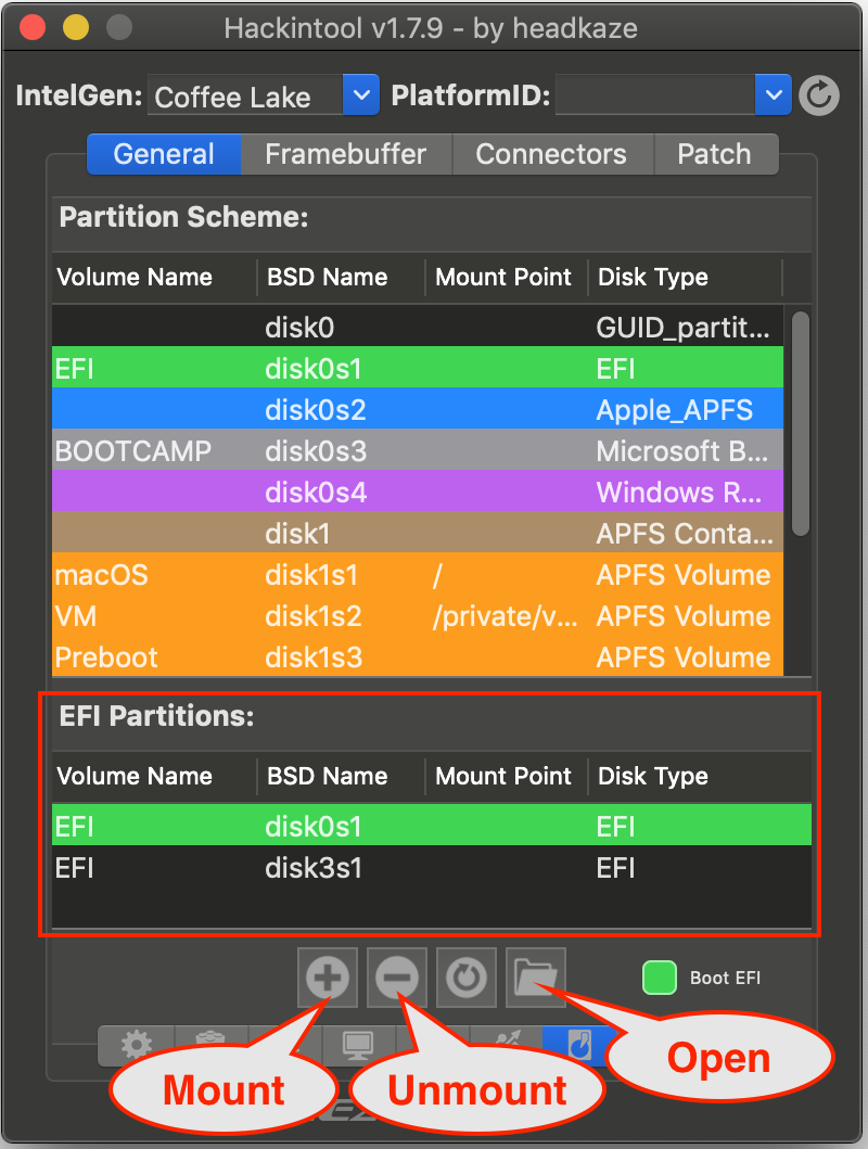

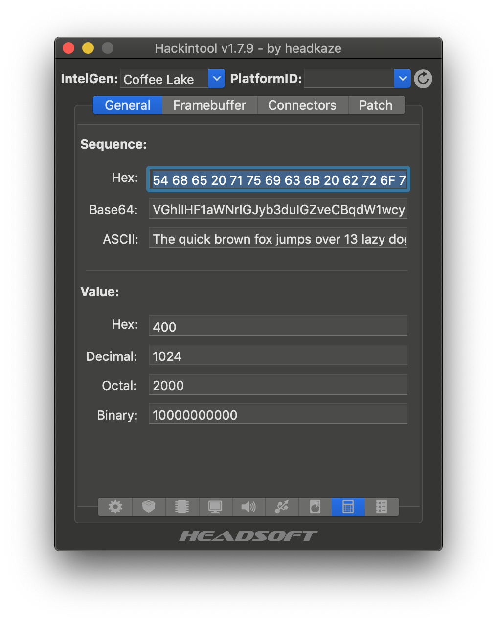

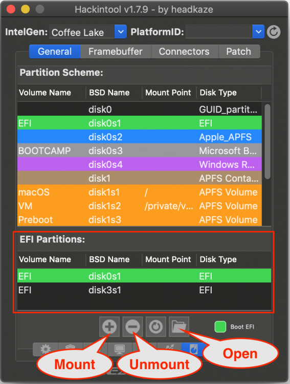

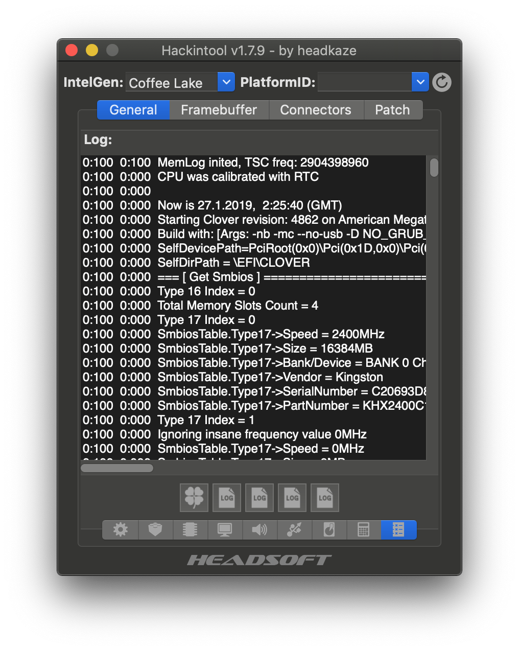

headkaze Posted January 27, 2019 Author Share Posted January 27, 2019 Hackintool v1.7.9 Released - Added USB power export, EFI partition mounting, calculator and log viewer 3 Link to comment https://www.insanelymac.com/forum/topic/335018-hackintool-v3xx/page/14/#findComment-2661539 Share on other sites More sharing options...
headkaze Posted January 27, 2019 Author Share Posted January 27, 2019 (edited) On 1/18/2019 at 6:33 AM, CMMChris said: @headkaze You should add an option to include the USB power properties into the Kext - or did I miss this? USB power data is automatically exported now. If you get a chance can you test it? Edited January 27, 2019 by headkaze 1 Link to comment https://www.insanelymac.com/forum/topic/335018-hackintool-v3xx/page/14/#findComment-2661542 Share on other sites More sharing options...

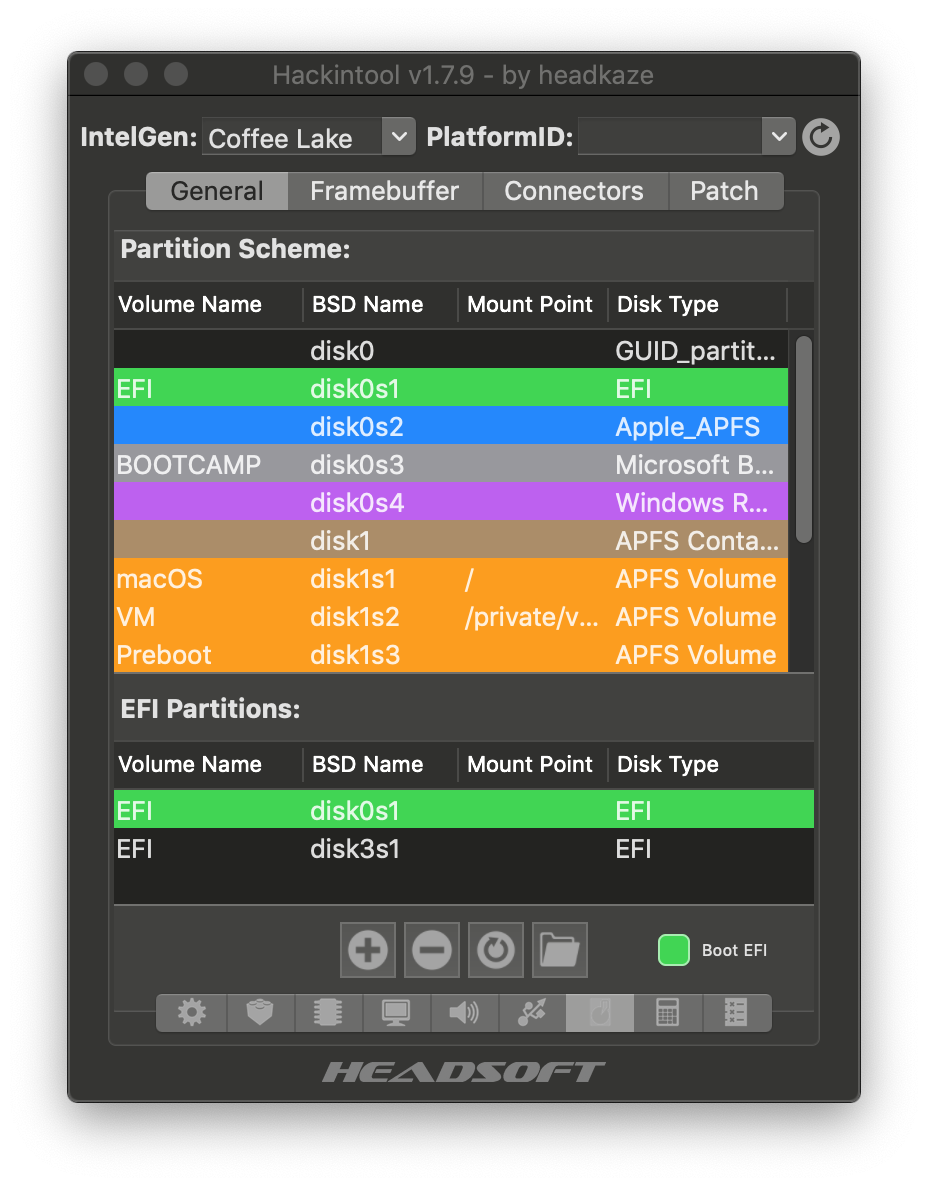

headkaze Posted January 28, 2019 Author Share Posted January 28, 2019 14 minutes ago, meaganmargaret said: Just out of curiosity, I downloaded your tool and was playing with it and I was looking for the EFI mounting utility and it was hard to find. I thought I found it, but it didn't seem to work too well. Does it work on systems with multiple macOS efi partitions? Yes it should work with multiple EFI partitions. You need to select one from the "EFI Partitions" table and then select one of the buttons for Mount, Unmount or Open. Let me know if there are any issues. Link to comment https://www.insanelymac.com/forum/topic/335018-hackintool-v3xx/page/14/#findComment-2661659 Share on other sites More sharing options...
