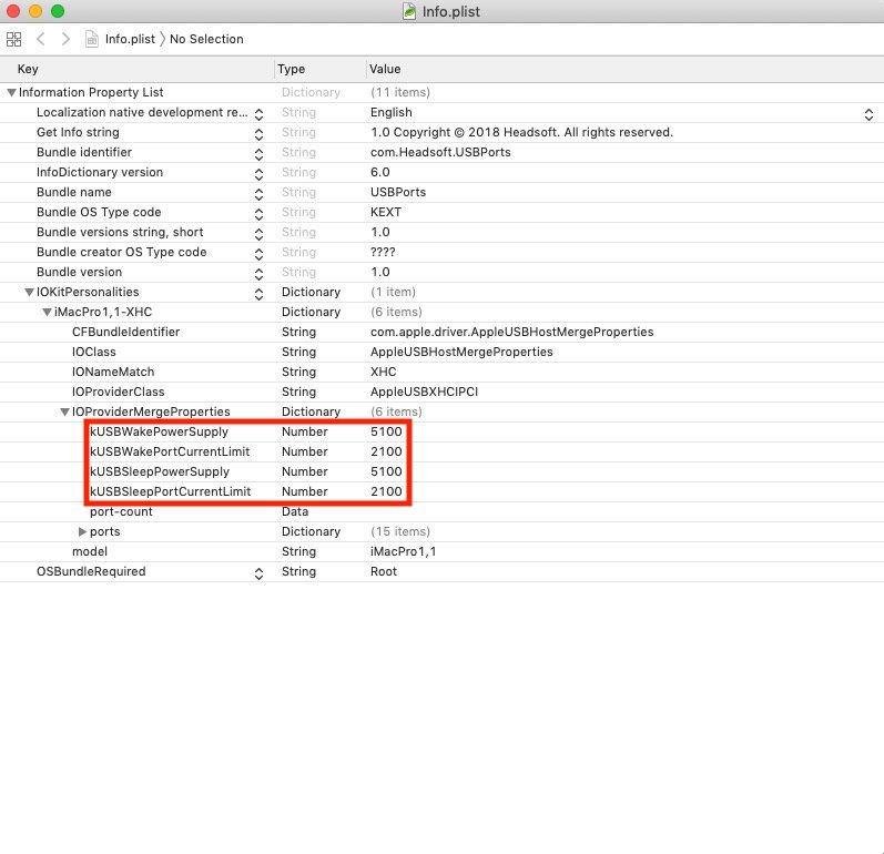

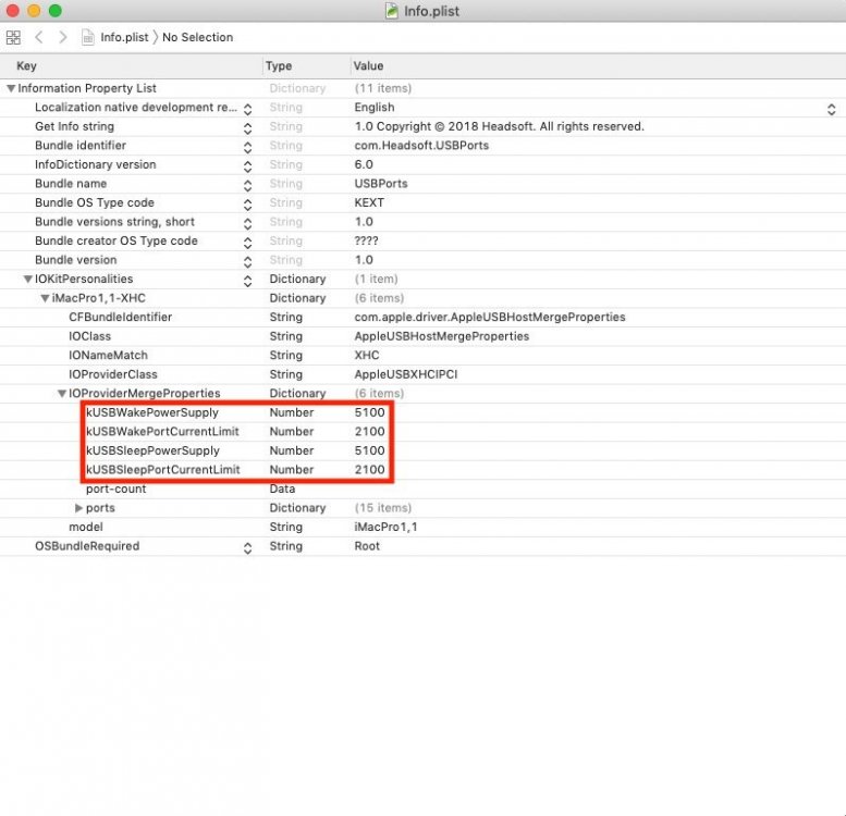

I say right if I say that one port 3.0 deals 2 slot of the 15? (one 2.0 and one 3.0?)
I always thought USB 3.0 ports counted as 2. 1 HS for USB 2 functionality and 1 SS for USB 3.0 functionality.
You might be right. If all of his 22 ports are on the one controller then it will be over the limit.
Edited by headkaze
3 hours ago, ruglau said:
yes I do, I think the problem is that if I keep all 2.0 (HSXX) and 3.0 (SSXX) I exceed the limit of 15...
You could be right actually. Can you please download Hackintool v1.7.5 and try again? I've updated the instructions too so let me know if it's easier to follow. Is there anything else you think I should change or add?

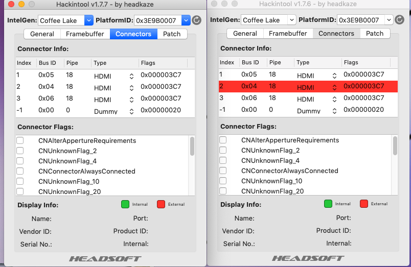

1 hour ago, headkaze said:
@Allan @jamvybz and anyone else suffering from a black screen on boot please read the [GUIDE] General Framebuffer Patching Guide (HDMI Black Screen Problem). I haven't looked through it yet but it does appear to be helping some people.
this a is what ive been trying to understand with the kackintool why is it that non of the rows are highlighted for my system if i was get the highlights on my system my system i don't think that i would still be having this problem, i could just see the Connectors that i need to change to hdmi and vga

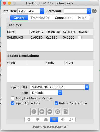

3 minutes ago, Ukr55 said:
I think the issue is you have an AMD video card. I would love to support it but I just don't have the hardware. If there is anyone who is a coder with an AMD card willing to add support I'm more than happy to add it to Github. The reason it's not on there right now is because I don't see the point in making the source public until there are people who are willing to contribute.
My screen turns black if I don't have EDID injection in Graphics/EDID or Devices/Properties/PciRoot~ AAPL,override-no-edid(no-connect). I was wondering if Hackintool would do something, so with EDID injected, I ran this app and have installed the exported kext/DisplayVendorID folder separately, but I still get a black screen without EDID injection in clover. Is Hackintool incompatible with manually injected edid? Am I missing something?
Maybe this help.
4 minutes ago, Ukr55 said:
Maybe this help.
Not really as the EDID code is already based on Andy Vandijck's FixEDID the difference is I gather the EDID data directly from IORegistry and his utility requires a dump from DarwinDumper. Again it's probably not alot of work to add support for AMD I just don't have the time or inclination to do it right now.
