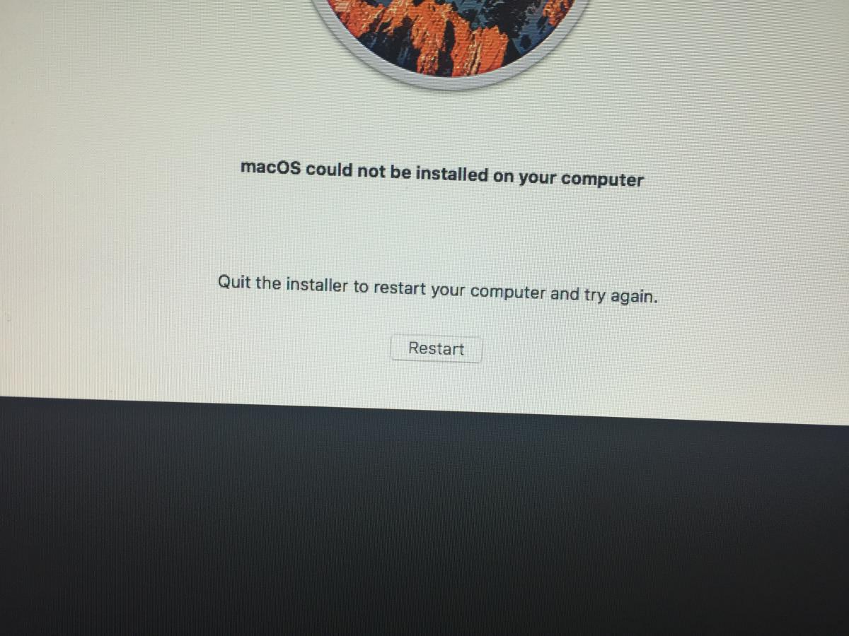

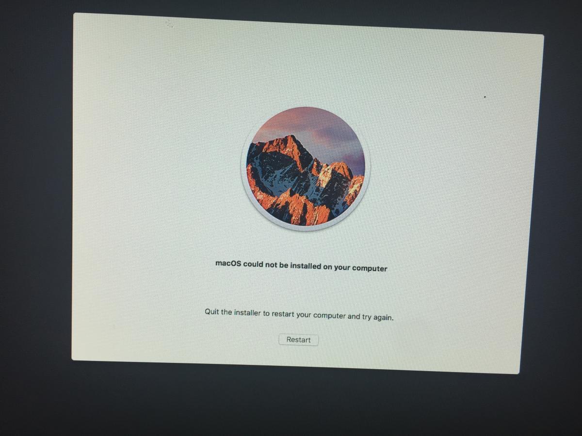

Im trying to Install macOS High Sierra on my Intel NUC D34010UWYK 4th Gen i3 4010u HD 4400 Graphics. I keep getting a screen which says macOS could not be installed to this computer please restart and try again?! Ive got my config.plist attatched could someone please take a look and help me out? :)
Im Using Clover r4081 Latest FakeSMC and using Prelinked kernel from this thread but im still getting this error? My SMBIOS is set to MacBook Pro 11,1 so its compatble its 2013 and for High Sierra you need a MacBook Pro 2010 or later? But i havent used the firmware code because it hasnt given me any firmware issues? also my Disk Utility is stuck on the spinning forever, and the Install macOS in the Menu takes like 15 Whole Minues to load and open, even then the whole thing is so darn slow??!
Someone please help me out id be extremley gratefull!!!!!!!! :)

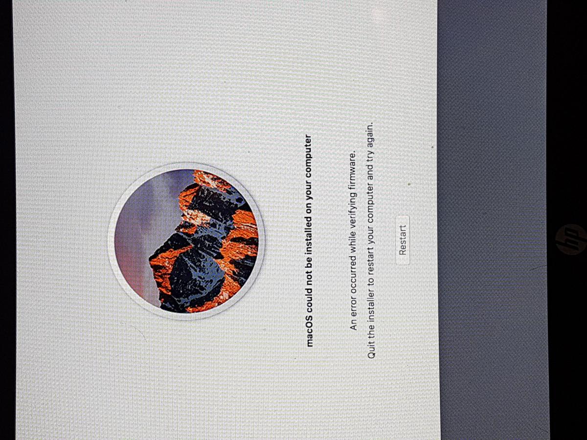

OK so I tried adding the firmware features and tried the in-place upgrade from 10.12.5 and still won't install. The below happens no matter install from USB installer or from installer within my 10.12.5 partition
- After files copy from the installer the computer will reboot
- Clover shows the install partition which I select
- After everything loads, the installer says "Installing 35 minutes remaining"
- Within a few seconds it will go back and forth between 35 minutes and 34 minutes remaining
- After a few more seconds the installer says "calculating time remaining" for which the computer just reboots
If I run the "install from" partition to try again, the above happens the same except after "calculating time remaining" I get the attached error that macOS could not be installed "An error occurred while verifying firmware". I was able to install every other Mac OS versions so it's weird if now it's unable to proceed further. I currently use "MacBookPro11,1" SMBIOS with my Intel i7 4700 Envy j series laptop with serial number generated by Clover Configurator.

I created a USB with the createinstallmedia command and installed Clover_v2.4k_r4084.pkg to it and used my original CLOVER folder with no changes except to BIOS Version and BIOS release date and  -alcbeta -lilubeta for audio, i didnt add Firmware Features. I booted the install from the downloaded Install macOS 10.13 Beta.app, then when laptop rebooted i booted from the USB and chose the High Sierra partition to continue the install, this method has worked on my Laptop without any firmware errors or OSInstall error which yes i did get.
