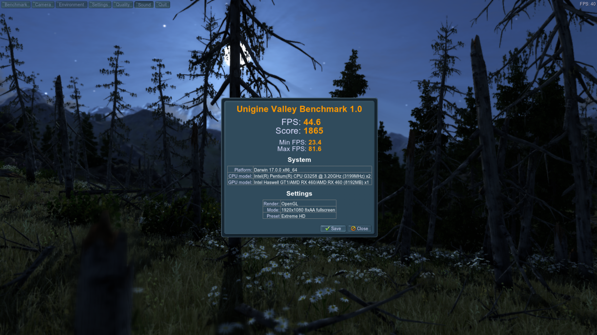

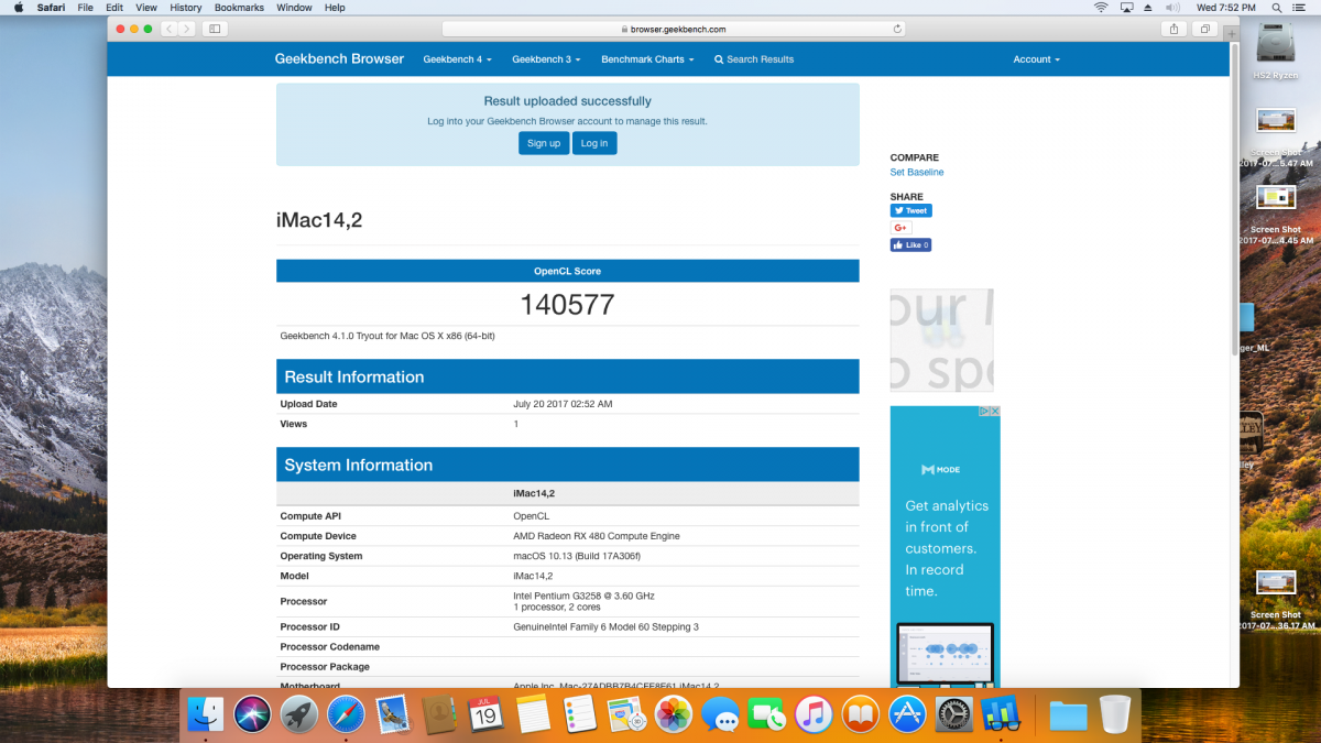

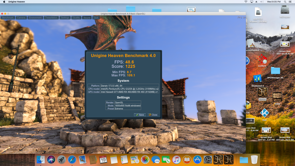

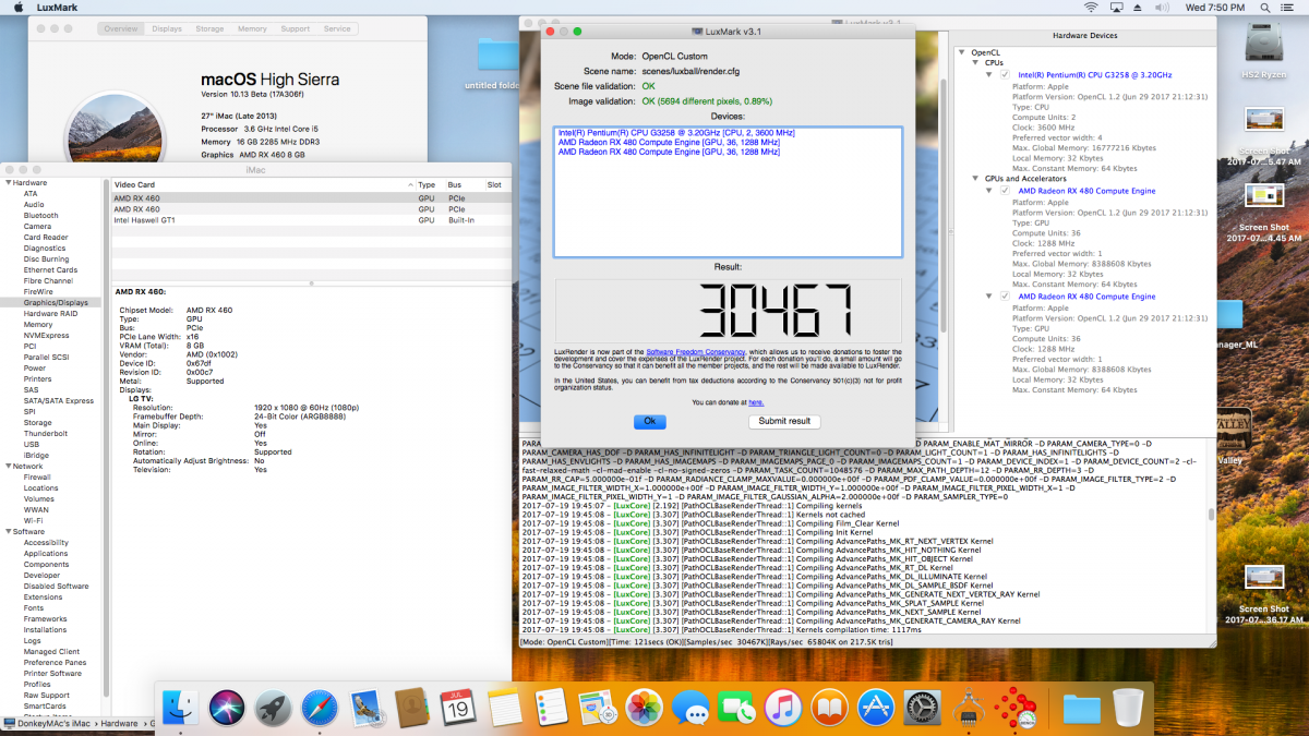

Gigamaxx Posted July 20, 2017 Share Posted July 20, 2017 High Sierra with a Haswell Pentium G3258 with Dual RX 480s. Note: I edited the 9500Kext for my RX 460 which is normally in the system so it shows 2 RX 460s but they are 480s. EFI.zip. HFS mode. 2 Link to comment Share on other sites More sharing options...
