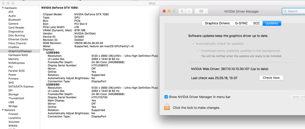

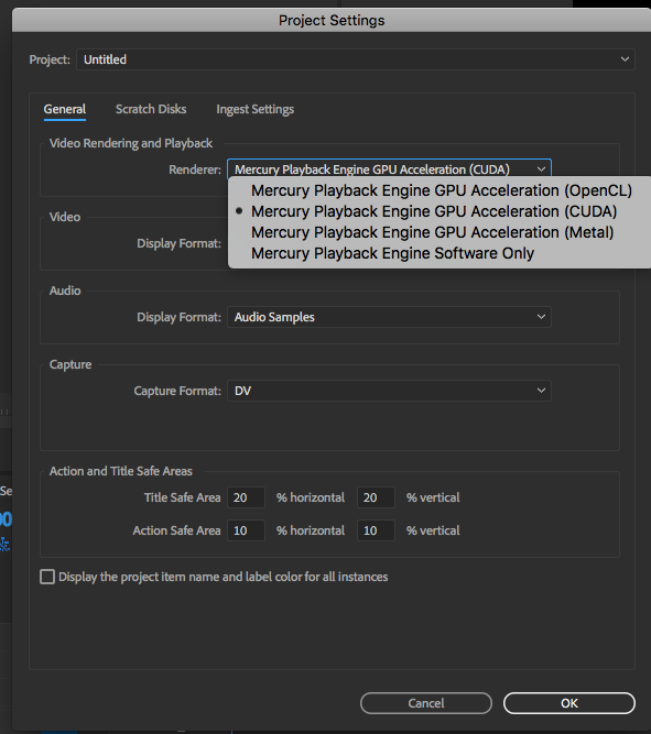

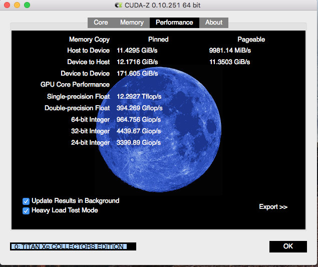

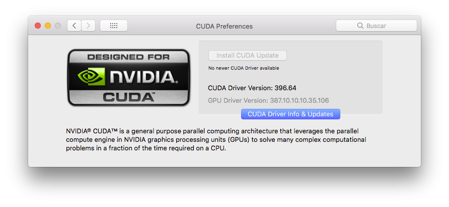

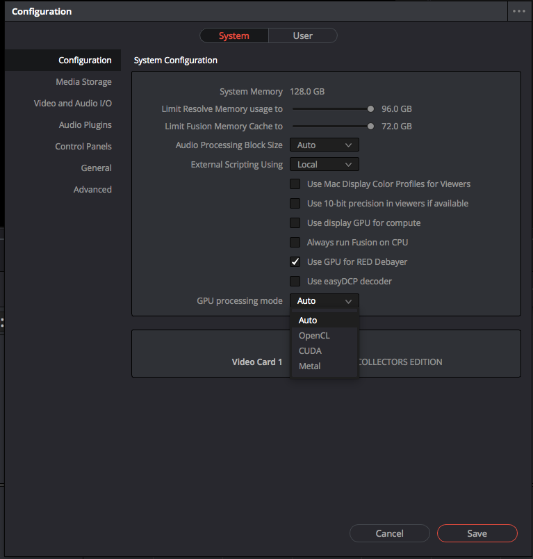

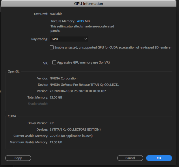

ergot Posted May 19, 2018 Share Posted May 19, 2018 On 5/15/2018 at 5:38 AM, Norb said: Cuda isn't working on my native Apple MacPro 5.1 with Adobe and a NVidia 1050 (Premiere, Media Converter) too. With the latest NVidia Webdriver ( .... 30.107) and Cuda (387.178) i can select Cuda, and others hardware related setting in the main prefs, but when i start the recoding or export everything is grayed out. I will wait till i can make a clean install of MacOS 10.13.5 when it's out. I hope that new drivers or the new clean setup will solve this behaviour. I'm on iMac pro 1,1 CUDA working only in Resolve I cannot chose and I don't even have the option to choose CUDA in AE and Pr etc. This done after a clean install....I think it is related to some configurations/drivers from NVIDIA Link to comment https://www.insanelymac.com/forum/topic/324195-nvidia-web-driver-updates-for-macos-high-sierra-update-nov-13-2020/page/62/#findComment-2614149 Share on other sites More sharing options...

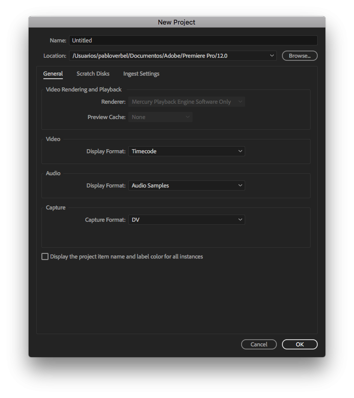

gTuxyCO Posted June 6, 2018 Share Posted June 6, 2018 Hi. I have been trying to enable cuda in Premiere Pro, I have OS 17F77 and install the latest version of the drivers but I can not get it to work, any idea what can it be? Link to comment https://www.insanelymac.com/forum/topic/324195-nvidia-web-driver-updates-for-macos-high-sierra-update-nov-13-2020/page/62/#findComment-2617120 Share on other sites More sharing options...

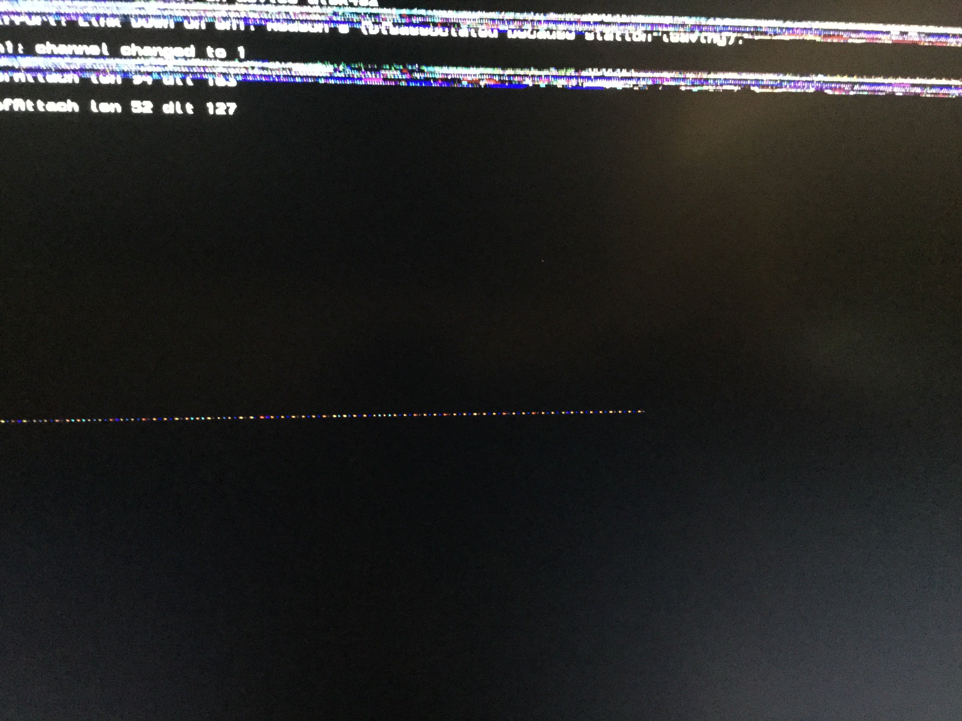

debbe85 Posted July 5, 2018 Share Posted July 5, 2018 Hi .. I lived well with 10.12.3 ... after an update I had to reinstall everything ... 10.13.5 When I try to activate the web drivers after booting everything stops ... black screen and colored lines .... I tried to add fakesmc lilu ... deactivate sip but nothing Link to comment https://www.insanelymac.com/forum/topic/324195-nvidia-web-driver-updates-for-macos-high-sierra-update-nov-13-2020/page/62/#findComment-2624300 Share on other sites More sharing options...
Badruzeus Posted July 5, 2018 Share Posted July 5, 2018 2 hours ago, debbe85 said: Hi .. I lived well with 10.12.3 ... after an update I had to reinstall everything ... 10.13.5 When I try to activate the web drivers after booting everything stops ... black screen and colored lines .... I tried to add fakesmc lilu ... deactivate sip but nothing 1. Boot with nv_disable=1 2. Reinstall WebDriver with new one here 3. Terminal: sudo nvram nvda_drv=1 4. Reboot mach. Good luck. Link to comment https://www.insanelymac.com/forum/topic/324195-nvidia-web-driver-updates-for-macos-high-sierra-update-nov-13-2020/page/62/#findComment-2624301 Share on other sites More sharing options...
debbe85 Posted July 5, 2018 Share Posted July 5, 2018 1 hour ago, Badruzeus said: 1. Boot with nv_disable=1 2. Reinstall WebDriver with new one here 3. Terminal: sudo nvram nvda_drv=1 4. Reboot mach. Good luck. Thanks for the answer .. Now I have the latest version ... I found that if I connect the monitor with the hdmi cable it works ... THE Problem is the display port !! I can not find anything about it ... I tried to set 1.1 but nothing Link to comment https://www.insanelymac.com/forum/topic/324195-nvidia-web-driver-updates-for-macos-high-sierra-update-nov-13-2020/page/62/#findComment-2624304 Share on other sites More sharing options...
debbe85 Posted July 7, 2018 Share Posted July 7, 2018 problem solved ... enough to disable nvedia injection; DDDD 1 Link to comment https://www.insanelymac.com/forum/topic/324195-nvidia-web-driver-updates-for-macos-high-sierra-update-nov-13-2020/page/62/#findComment-2624711 Share on other sites More sharing options...
