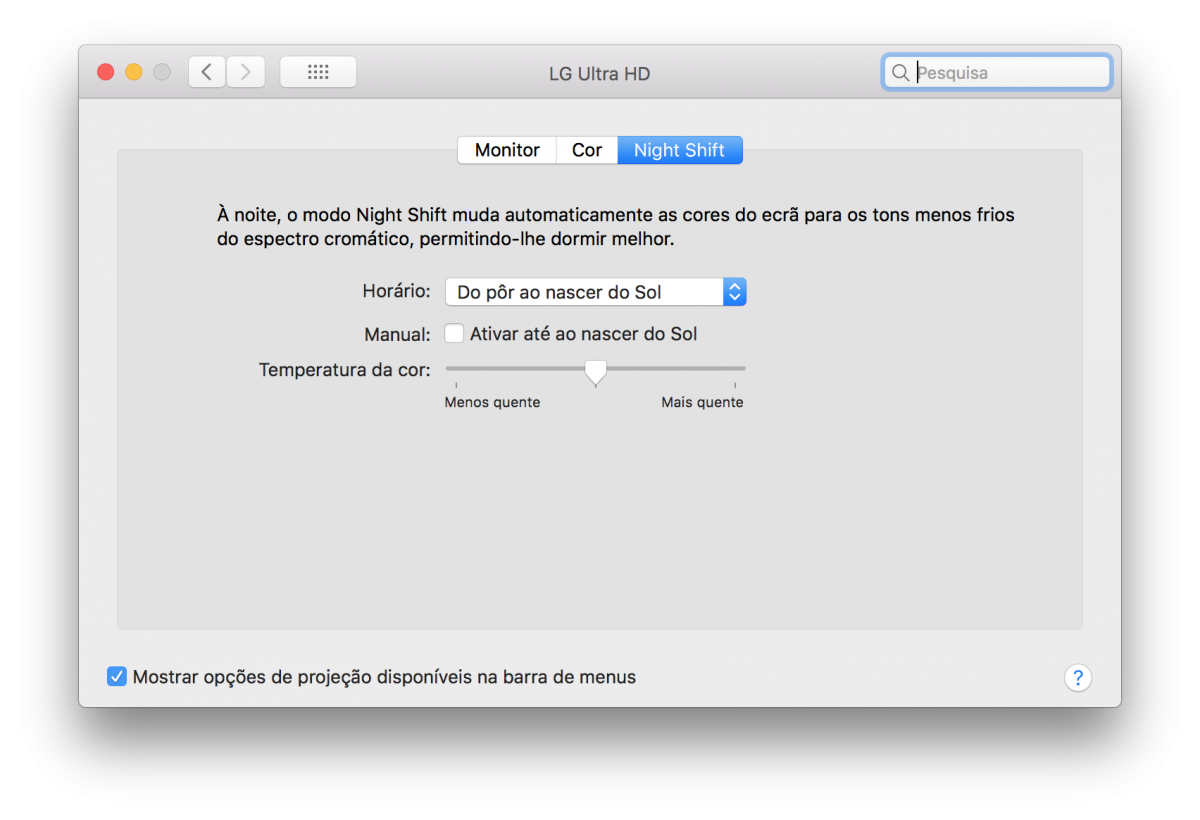

Gregow Posted October 11, 2017 Share Posted October 11, 2017 Nvidiadriver in my experience in different osx version in different rigs I have owned in time have always a worst performance against windows drivers in benchmark. In my case I could quantify this difference for about a 15/20 % less than window I can work without any lag in photoshop as I do in windows (no lag at all) Cuda driver I use in premiere pro export have pretty same performance as window maybe a 5% less but in real world usage I cannot see any differences If I would like to be a little critics with this driver I would like to say metal implementation is too weak if I compare with great gfx power and some time I have some glitches when I do a show package contents and scroll inside it...object seems to disappear inside (not always but it happens sometimes ) off topic IPG related subject search in this forum augustopaulo 5960x and download his "comprimido" archive, inside this zip you will find a working IPG version For oarksit performance fix try to see in latest config.plist you can find in this thread: #804 Thanks fabiosun! Unfortunately I still can't get IPG to work, and the EIST patch did nothing (no surprise though as I have EIST and C-states turned off in the BIOS). However, I understand that this may be a bit off topic so it might be better if I start a new thread on these issue. It's interesting, however, that you don't seem to experience the same problems with PS. I've always thought this an issue with the nVidia drivers, but I may have missed something. To you and others here, if you open a reasonably small image in PS, press 'F' and move it around. Does the image trail behind the mouse cursors at all? If you open a raw image and drag the sliders, do you see any lag? I have tons of lag with some operations like that, and sometimes artifacts as well. Link to comment https://www.insanelymac.com/forum/topic/324195-nvidia-web-driver-updates-for-macos-high-sierra-update-nov-13-2020/page/21/#findComment-2513837 Share on other sites More sharing options...

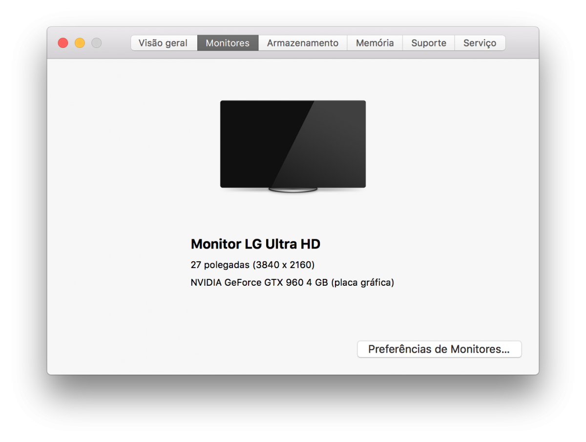

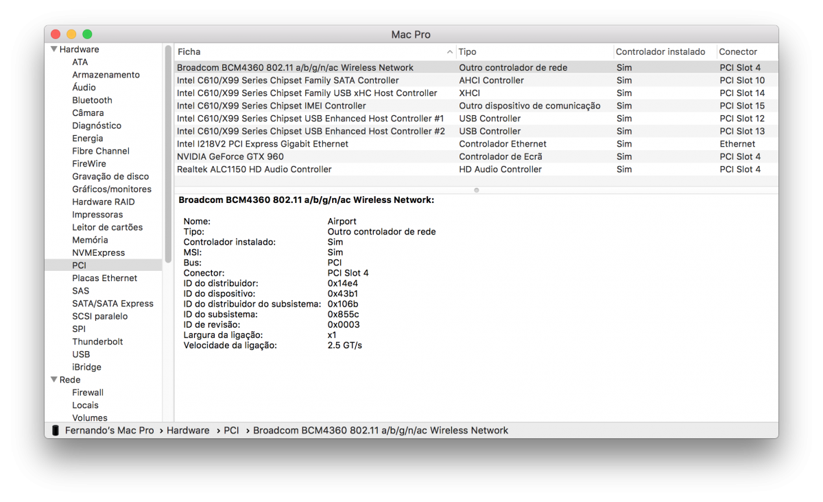

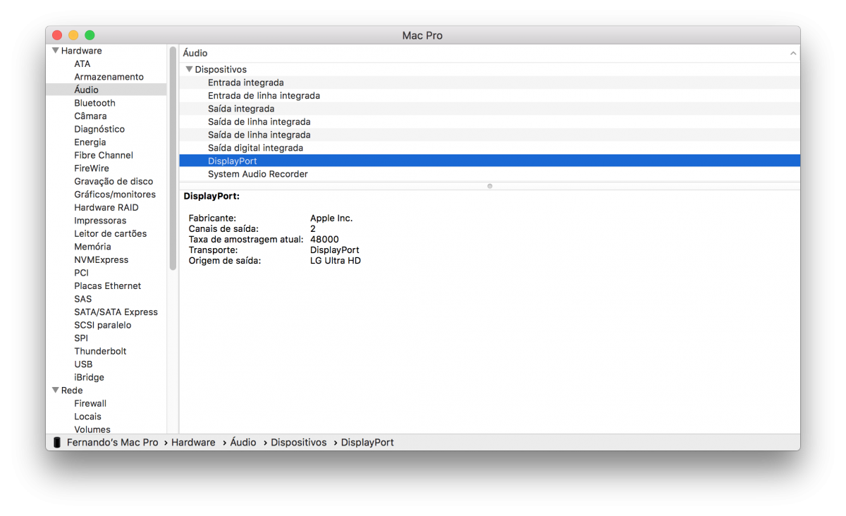

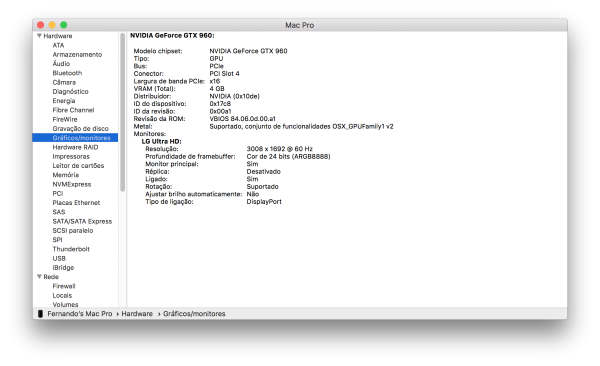

Fergarth Posted October 12, 2017 Share Posted October 12, 2017 to clarify, with DisplayPort you have a black screen with the functional slider? this is my case ... through ScreenSharing I have access to my computer, all working. Curious, but my 960 works perfectly through displayport both in 10.13 and in 10.13 SU with the Nvidia Driver and only use the Lilu.kext. I do not even need to use the NvidiaGraphicsFixup.kext or the NVWebDriverLibValFix.kext 1 Link to comment https://www.insanelymac.com/forum/topic/324195-nvidia-web-driver-updates-for-macos-high-sierra-update-nov-13-2020/page/21/#findComment-2514221 Share on other sites More sharing options...
MICKHAEL Posted October 12, 2017 Share Posted October 12, 2017 Curious, but my 960 works perfectly through displayport both in 10.13 and in 10.13 SU with the Nvidia Driver and only use the Lilu.kext. I do not even need to use the NvidiaGraphicsFixup.kext or the NVWebDriverLibValFix.kext Curious! that's really interesting, how's that?) any unusual clover entry? my works just over DVI-D Link to comment https://www.insanelymac.com/forum/topic/324195-nvidia-web-driver-updates-for-macos-high-sierra-update-nov-13-2020/page/21/#findComment-2514226 Share on other sites More sharing options...
Fergarth Posted October 12, 2017 Share Posted October 12, 2017 Curious! that's really interesting, how's that?) any unusual clover entry? my works just over DVI-D Hi Mickhael, I do not use any patch on the plist, I just use the same DSDT as always, created the first time by nmano and than improved and supplemented by PMHeart, Mald0n and myself. In my case, the secret to not having black screens (macpro 6.1) was to change GFX0 to GFX1 in DSDT All is working perfectly yes! 1 Link to comment https://www.insanelymac.com/forum/topic/324195-nvidia-web-driver-updates-for-macos-high-sierra-update-nov-13-2020/page/21/#findComment-2514277 Share on other sites More sharing options...
