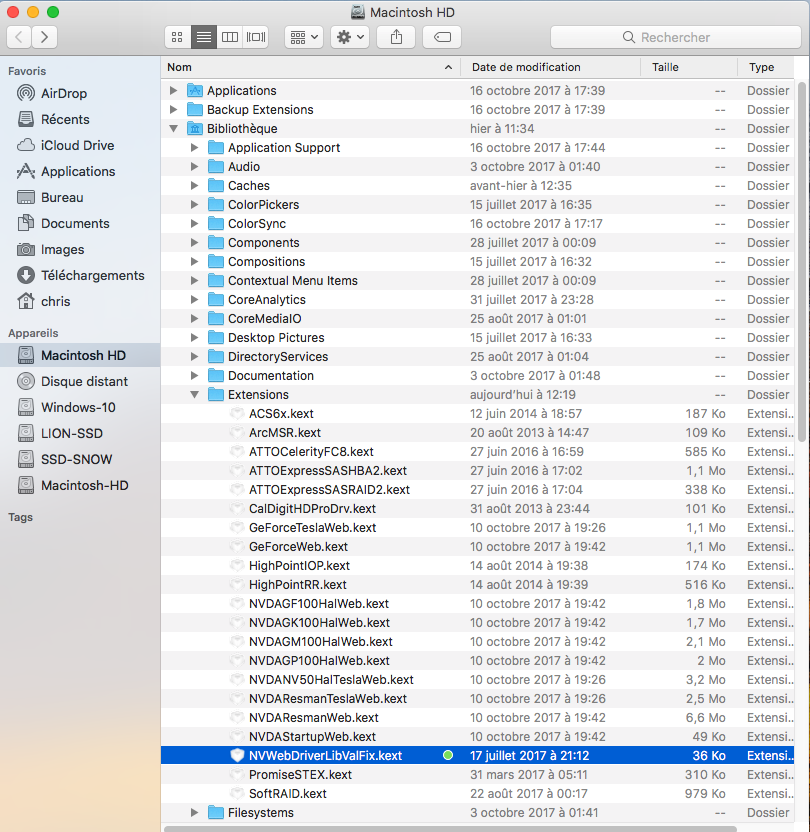

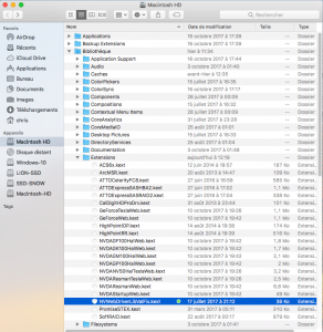

chris1111 Posted October 19, 2017 Share Posted October 19, 2017 My Zotac Geforce GT 1030 needs NVWebDriverLibValFix.kext in Library/Extensions With the Packager I install my kext with my Payload No installation with permission, all is in the Package Link to comment https://www.insanelymac.com/forum/topic/324195-nvidia-web-driver-updates-for-macos-high-sierra-update-nov-13-2020/page/24/#findComment-2519009 Share on other sites More sharing options...
chris1111 Posted October 19, 2017 Share Posted October 19, 2017 Hi Chris1111 kext above that one are loaded? (Nvidia stuff I mean) All kext is loading by the Packages with Root permission You can loading any kext in LE or SLE with the Package Link to comment https://www.insanelymac.com/forum/topic/324195-nvidia-web-driver-updates-for-macos-high-sierra-update-nov-13-2020/page/24/#findComment-2519023 Share on other sites More sharing options...
chris1111 Posted October 19, 2017 Share Posted October 19, 2017 I mean like this? What you mean? Link to comment https://www.insanelymac.com/forum/topic/324195-nvidia-web-driver-updates-for-macos-high-sierra-update-nov-13-2020/page/24/#findComment-2519030 Share on other sites More sharing options...
chris1111 Posted October 19, 2017 Share Posted October 19, 2017 look this pictures and the previous one for both driver is working well but in first pictures some kexts are not loaded My kexts are all load what image you speak? Link to comment https://www.insanelymac.com/forum/topic/324195-nvidia-web-driver-updates-for-macos-high-sierra-update-nov-13-2020/page/24/#findComment-2519038 Share on other sites More sharing options...

mitch_de Posted October 20, 2017 Share Posted October 20, 2017 My Zotac Geforce GT 1030 needs NVWebDriverLibValFix.kext in Library/Extensions With the Packager I install my kext with my Payload No installation with permission, all is in the Package Yep, my GT 1030 also needed NVWebDriverLibValFix.kext in /Library/Extensions. Even in Sierra , to avoid black windows (no content) for iBooks or Little Snitch Networkmonitor. But be warned: Using newer LILU (1.20+) and NvidiaGraphicFixup.kext (newest, which includes NVWebDriverLibValFix function) you MUST delete NVWebDriverLibValFix.kext from /Library/Extensions first before reboot. Otherwise next reboot fails in reboot loop!! 5 Link to comment https://www.insanelymac.com/forum/topic/324195-nvidia-web-driver-updates-for-macos-high-sierra-update-nov-13-2020/page/24/#findComment-2519287 Share on other sites More sharing options...
@ROBASEFR Posted October 20, 2017 Share Posted October 20, 2017 But be warned: Using newer LILU (1.20+) and NvidiaGraphicFixup.kext (newest, which includes NVWebDriverLibValFix function) you MUST delete NVWebDriverLibValFix.kext from /Library/Extensions first before reboot. Otherwise next reboot fails in reboot loop!! Thank you for this information MITCH ! I confirm this issue on my rig with GTX970 with latest webdrivers and Cuda drivers Link to comment https://www.insanelymac.com/forum/topic/324195-nvidia-web-driver-updates-for-macos-high-sierra-update-nov-13-2020/page/24/#findComment-2519389 Share on other sites More sharing options...

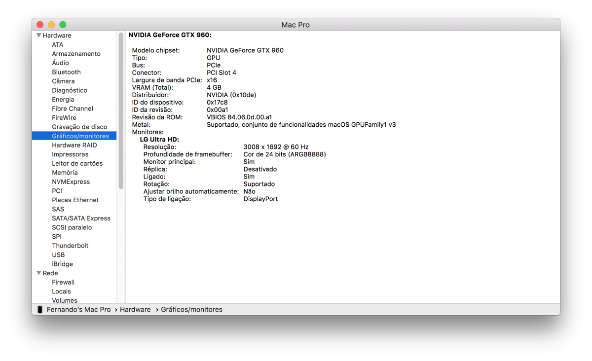

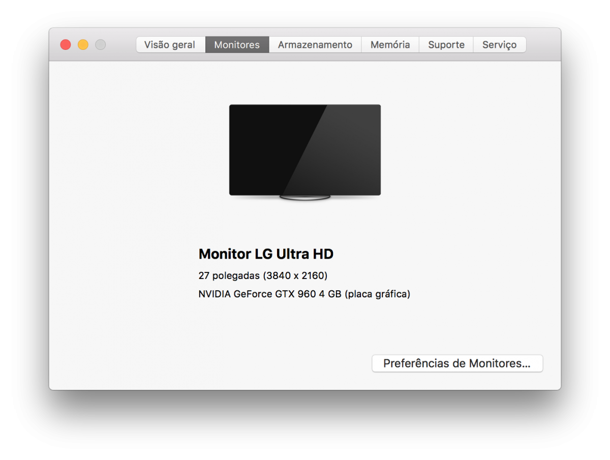

MICKHAEL Posted October 22, 2017 Share Posted October 22, 2017 displayport works? anybody Link to comment https://www.insanelymac.com/forum/topic/324195-nvidia-web-driver-updates-for-macos-high-sierra-update-nov-13-2020/page/24/#findComment-2520569 Share on other sites More sharing options...
UltraLaser Posted October 22, 2017 Share Posted October 22, 2017 displayport works? anybody For me yes, but doesn't go in sleep mode. (instat wake) Link to comment https://www.insanelymac.com/forum/topic/324195-nvidia-web-driver-updates-for-macos-high-sierra-update-nov-13-2020/page/24/#findComment-2520617 Share on other sites More sharing options...

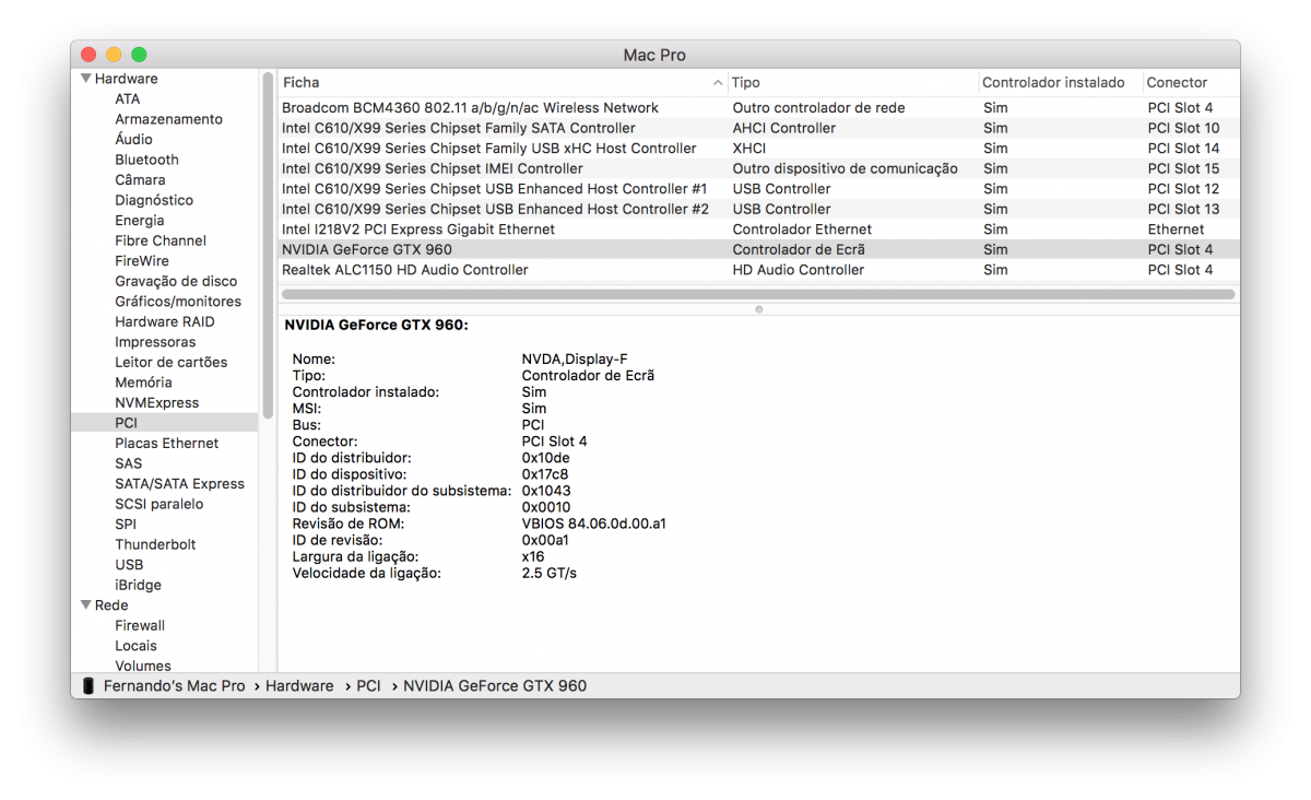

MICKHAEL Posted October 22, 2017 Share Posted October 22, 2017 For me yes, but doesn't go in sleep mode. (instat wake) this is so strange... on my display only mouse and black screen... works ok on dvi-d. sleep also ok. I thinked maybe after web driver update will start work displayport... on Sierra worked just great Link to comment https://www.insanelymac.com/forum/topic/324195-nvidia-web-driver-updates-for-macos-high-sierra-update-nov-13-2020/page/24/#findComment-2520623 Share on other sites More sharing options...
MICKHAEL Posted October 22, 2017 Share Posted October 22, 2017 do. you mean this? have you tried to delete any ssdt or dsdt graphics related and put in clover/kext/other nvidiagraphicsfixup kext? my DSDT contains only Device (GFX1) { Name (_ADR, Zero) // _ADR: Address Method (_SUN, 0, NotSerialized) // _SUN: Slot User Number { Return (SNUM ()) } Method (_DSM, 4, NotSerialized) // _DSM: Device-Specific Method { Store (Package (0x18) { "@2,AAPL,boot-display", Buffer (One) { 0x02 }, "device-id", Buffer (0x04) { 0xC2, 0x13, 0x00, 0x00 }, "@0,connector-type", Buffer (0x04) { 0x00, 0x08, 0x00, 0x00 }, "@1,connector-type", Buffer (0x04) { 0x00, 0x08, 0x00, 0x00 }, "@2,connector-type", Buffer (0x04) { 0x00, 0x08, 0x00, 0x00 }, "@3,connector-type", Buffer (0x04) { 0x00, 0x08, 0x00, 0x00 }, "@4,connector-type", Buffer (0x04) { 0x00, 0x08, 0x00, 0x00 }, "@5,connector-type", Buffer (0x04) { 0x00, 0x08, 0x00, 0x00 }, "rom-revision", Buffer (0x0F) { "84.06.2f.00.52" }, "model", Buffer (0x17) { "NVIDIA GeForce GTX 960" }, "name", Buffer (0x08) { "display" }, "hda-gfx", Buffer (0x0A) { "onboard-2" } }, Local0) DTGP (Arg0, Arg1, Arg2, Arg3, RefOf (Local0)) Return (Local0) } } Link to comment https://www.insanelymac.com/forum/topic/324195-nvidia-web-driver-updates-for-macos-high-sierra-update-nov-13-2020/page/24/#findComment-2520646 Share on other sites More sharing options...
captain-j Posted October 22, 2017 Share Posted October 22, 2017 I would try to disable dsdt in clover dsdt option and put kext nvidiafixup 1.20 Latest kext fixes policy and black screen with signal I am using only a single ssdt to rename gfx And it is working All port are working I have not tried 4K display I have 30-bit working fine in Photoshop. But for macOS in general it is not (but it was working in Sierra). In System Profiler, my display is shown like this: LG Ultra HD: Resolution: 2560 x 1440 @ 60 Hz Framebuffer Depth: 24-Bit Color (ARGB8888) It used to be able to go to 30-bit color (ARGB20101010). Now when you switch from 24 to 30 bit in ResXtreme, screen just goes black and you have to screenshare back in to reset it back to 24 bit. My monitor is 30bit/10bit capable. I am already using NvidiaGraphicsFixup 1.20, it makes no difference for this particular problem. I think the web drivers just don't support it yet. Link to comment https://www.insanelymac.com/forum/topic/324195-nvidia-web-driver-updates-for-macos-high-sierra-update-nov-13-2020/page/24/#findComment-2520674 Share on other sites More sharing options...
