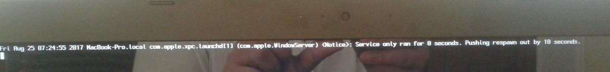

SavageAUS Posted August 24, 2017 Share Posted August 24, 2017 I'm getting a strange issue after a fresh install (db7) (apfs). fs_get_inode_with_hint:8012: failed to load inode 547037 ret 22 fs_get_inode_with_hint:8012: failed to load inode 547037 ret 22 Error loading kernel cache (0xe) Boot failed, sleeping for 10 seconds before exiting... Laptop in my sig. Wiped HDD with Yosemite, created partitions, reboot into High Sierra installer. Format High Sierra partition as APFS. Install without issue but upon trying to boot into the actual os I get the error above. O/T Sierra 10.12.6 installs fine but always creates coreStorage that I have to revert. Samsung 850 EVO 500g SSD. Latest firmware installed. Sent from my SM-G930F using Tapatalk Link to comment https://www.insanelymac.com/forum/topic/324194-pre-release-macos-high-sierra/page/125/#findComment-2484224 Share on other sites More sharing options...

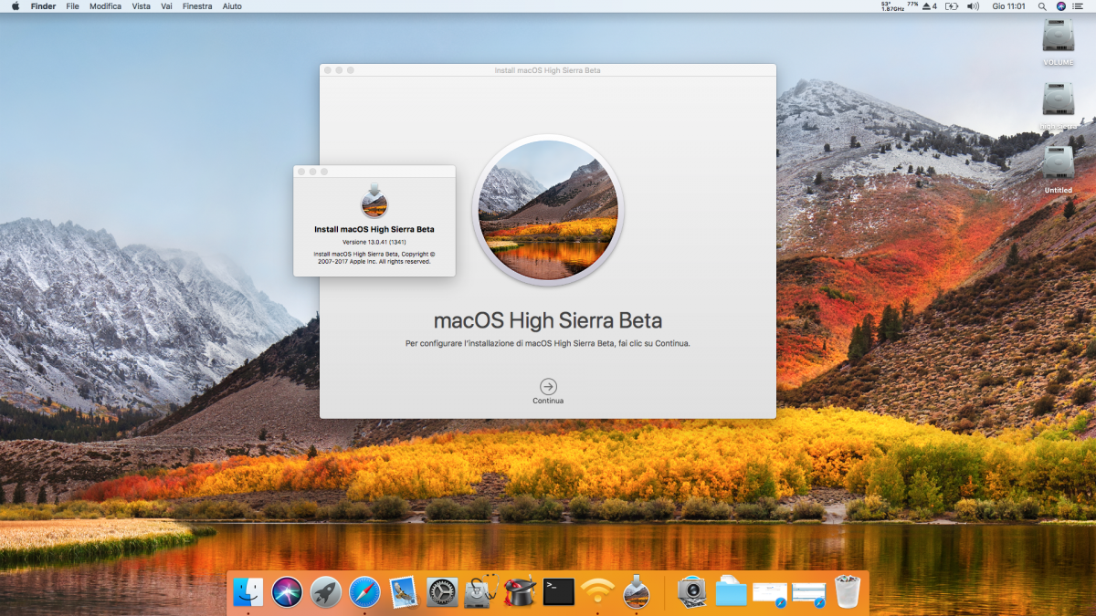

vrondena Posted August 24, 2017 Share Posted August 24, 2017 I ,my download applestore with p.b.utility again 10.13.6 how to receive 7 ? from apple update I have 7 but after download and reboot no install ,any help by Link to comment https://www.insanelymac.com/forum/topic/324194-pre-release-macos-high-sierra/page/125/#findComment-2484296 Share on other sites More sharing options...

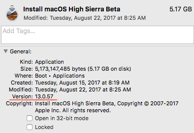

Cyberdevs Posted August 24, 2017 Share Posted August 24, 2017 I ,my download applestore with p.b.utility again 10.13.6 how to receive 7 ? from apple update I have 7 but after download and reboot no install ,any help by The 13.0.41 is the version of the Installer app not the version or the build number of the macOS, check the version of macOS by using the "Get Info" if the version is 13.0.57 then it is the DP 7 otherwise you need to remove the installer and download it again. 1 Link to comment https://www.insanelymac.com/forum/topic/324194-pre-release-macos-high-sierra/page/125/#findComment-2484314 Share on other sites More sharing options...
vrondena Posted August 24, 2017 Share Posted August 24, 2017 The 13.0.41 is the version of the Installer app not the version or the build number of the macOS, check the version of macOS by using the "Get Info" if the version is 13.0.57 then it is the DP 7 otherwise you need to remove the installer and download it again. thank you,is 7 on both cases I have a error install. wait GM or stay on 4 exasperated Link to comment https://www.insanelymac.com/forum/topic/324194-pre-release-macos-high-sierra/page/125/#findComment-2484322 Share on other sites More sharing options...

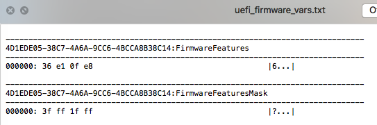

Moorre Posted August 25, 2017 Share Posted August 25, 2017 i checked all parts of macpro5,1 firmware to search ff/ffm information. strange. also shown other pattern compared to other firmware as what i known macpro5,1 can't see correct ff/ffm infomation. if you can test, try this MP51.88Z.0084.B00.1708080528 and not use ff/ffm at config with clover r4184. thanks I've tried this version MP51.88Z.0084.B00.1708080528 with R4187, but manually wrote FF 0xE80FE136 && FFM 0xFF1FFF3F w\o PF key (Valid 0xFFFF) and from the Log: 3:511 0:011 Using ProductName from config 3:511 0:000 ProductName: MacPro5,1 3:511 0:000 Using latest BiosVersion from config 3:511 0:000 BiosVersion: MP51.88Z.0084.B00.1708080528 3:511 0:000 BiosReleaseDate: 08/08/17 3:511 0:000 Found same FirmwareFeatures in clover and config 3:511 0:000 FirmwareFeatures: 0xE80FE136 3:511 0:000 Found same FirmwareFeaturesMask in clover and config 3:511 0:000 FirmwareFeaturesMask: 0xFF1FFF3F 3:511 0:000 Using PlatformFeature from clover 3:511 0:000 PlatformFeature: 0xFFFF One main thing. My board has 4 SATA controllers: ICH10R, 2x JMicron(s) and Marvell (see my signature). Earlier I had problems with connected HDDs to first 0,1,2 ports of ICH10 and both JM, but no problem with Marvell. Though yesterday I booted only with Marvell and absolutely w\o any problem updated system to Dev7 from AppStore. Yep. 2 Link to comment https://www.insanelymac.com/forum/topic/324194-pre-release-macos-high-sierra/page/125/#findComment-2484725 Share on other sites More sharing options...
Sherlocks Posted August 25, 2017 Share Posted August 25, 2017 Last night I can easily reach the installer screen but now same USB I always getting OSInstall.mpkg error? What am I doing wrong?Upload your clover log 나의 LG-F800S 의 Tapatalk에서 보냄 I've tried this version MP51.88Z.0084.B00.1708080528 with R4187, but manually wrote FF 0xE80FE136 && FFM 0xFF1FFF3F w\o PF key (Valid 0xFFFF) and from the Log: 3:511 0:011 Using ProductName from config 3:511 0:000 ProductName: MacPro5,1 3:511 0:000 Using latest BiosVersion from config 3:511 0:000 BiosVersion: MP51.88Z.0084.B00.1708080528 3:511 0:000 BiosReleaseDate: 08/08/17 3:511 0:000 Found same FirmwareFeatures in clover and config 3:511 0:000 FirmwareFeatures: 0xE80FE136 3:511 0:000 Found same FirmwareFeaturesMask in clover and config 3:511 0:000 FirmwareFeaturesMask: 0xFF1FFF3F 3:511 0:000 Using PlatformFeature from clover 3:511 0:000 PlatformFeature: 0xFFFF One main thing. My board has 4 SATA controllers: ICH10R, 2x JMicron(s) and Marvell (see my signature). Earlier I had problems with connected HDDs to first 0,1,2 ports of ICH10 and both JM, but no problem with Marvell. Though yesterday I booted only with Marvell and absolutely w\o any problem updated system to Dev7 from AppStore. Yep.Thank you for report.MacPro5,1 was checked by you. Soon i will update biosversion for macpro5,1 with other patch 나의 LG-F800S 의 Tapatalk에서 보냄 1 Link to comment https://www.insanelymac.com/forum/topic/324194-pre-release-macos-high-sierra/page/125/#findComment-2484863 Share on other sites More sharing options...
