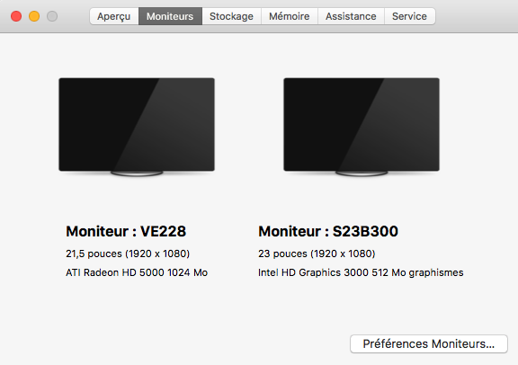

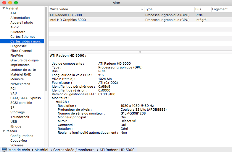

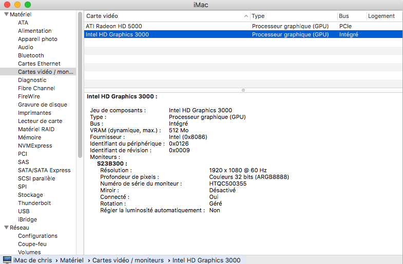

and now its show the exacte name   :thumbsup_anim:   :D
ATI Radeon HD 5570
EDIT***
but to have my two screens on my two GPU I have to add the FB
and sacrificing the name  :)

You can connect 2 monitors  on the 5570 - DVI and HDMI.
