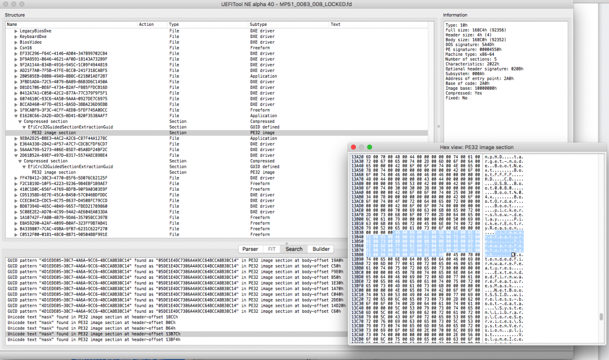

Sherlocks Posted August 22, 2017 Share Posted August 22, 2017 @Sherlocks, Hi! For the MacPro5,1 Platformdata: From the previous Beta5 MP51.88Z.0083.B00.1707271620 From the current Beta6 MP51.88Z.0084.B00.1708080528 But I don't know exactly FF & FFM ( I have nowhere to get it). Thank you for macpro51 info.I wonder where you get macpro51 firmware info? Take a firmware info from real macpro51? I cant see macpro51 firmware info from firmware files. If you inform info, its help to impove support high sierra 나의 LG-F800S 의 Tapatalk에서 보냄 Link to comment https://www.insanelymac.com/forum/topic/324194-pre-release-macos-high-sierra/page/121/#findComment-2483249 Share on other sites More sharing options...

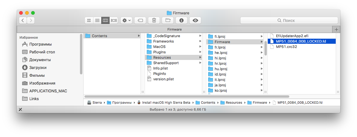

Moorre Posted August 22, 2017 Share Posted August 22, 2017 I wonder where you get macpro51 firmware info? Take a firmware info from real macpro51? I cant see macpro51 firmware info from firmware files. If you inform info, its help to impove support high sierra It is now at different location. Simple /Applications/Install\ macOS\ High\ Sierra\ Beta/Contents/Resources/Firmware 2 Link to comment https://www.insanelymac.com/forum/topic/324194-pre-release-macos-high-sierra/page/121/#findComment-2483255 Share on other sites More sharing options...
Sherlocks Posted August 22, 2017 Share Posted August 22, 2017 It is now at different location. Simple /Applications/Install\ macOS\ High\ Sierra\ Beta/Contents/Resources/FirmwareGreat . Can you upload file?Thanks in advance 나의 LG-F800S 의 Tapatalk에서 보냄 Link to comment https://www.insanelymac.com/forum/topic/324194-pre-release-macos-high-sierra/page/121/#findComment-2483257 Share on other sites More sharing options...

Moorre Posted August 22, 2017 Share Posted August 22, 2017 Can you upload file? I can. I've tried to find out the FF & FFM from the previous build, firmware has this patterns, but with zeroes. Maybe you can find out. MacPro5,1_FWs.zip Link to comment https://www.insanelymac.com/forum/topic/324194-pre-release-macos-high-sierra/page/121/#findComment-2483263 Share on other sites More sharing options...

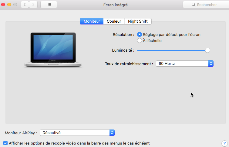

chris1111 Posted August 22, 2017 Share Posted August 22, 2017 BETA 7 The Brightness Bar works 4 Link to comment https://www.insanelymac.com/forum/topic/324194-pre-release-macos-high-sierra/page/121/#findComment-2483336 Share on other sites More sharing options...
