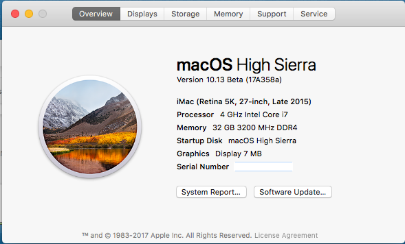

Matgen84 Posted August 29, 2017 Share Posted August 29, 2017 Install macOS High Sierra Beta.app/Contents/SharedSupport/BaseSystem.dmg/System/Library/CoreServices/SystemVersion.plist <key>ProductBuildVersion</key> <string>17A358a</string> Thanks to @crazyburdy @cyberdevs @KGP-X99 Last night I downloaded Beta on the appstore: instead of Beta 8, I think now is Beta 7. Install macOS High Sierra Beta.app/Contents/SharedSupport/BaseSystem.dmg/System/Library/CoreServices/SystemVersion.plist show: <key>ProductBuildVersion</key> <string>17A352a</string> Strange. This is the first time that this happens to me I need to re-download this morning to test clean install 1 Link to comment https://www.insanelymac.com/forum/topic/324194-pre-release-macos-high-sierra/page/129/#findComment-2486344 Share on other sites More sharing options...

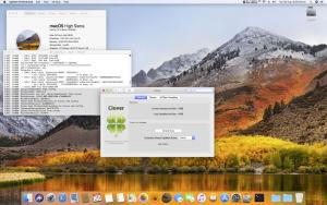

SavageAUS Posted August 29, 2017 Share Posted August 29, 2017 Fresh install on desktop beta 8. No firmware issues or OSinstall error. I did not remove EmuVariableUEFI. Windows SSD was connected and enabled. Laptop Fresh install smooth as butter. Battery indicator appears to be working now with @RehabMan "experimental fix for battery status startup problem (issue #21) on 10.13" https://bitbucket.org/RehabMan/os-x-acpi-battery-driver/downloads/RehabMan-Battery-2017-0828.zip 1 Link to comment https://www.insanelymac.com/forum/topic/324194-pre-release-macos-high-sierra/page/129/#findComment-2486353 Share on other sites More sharing options...

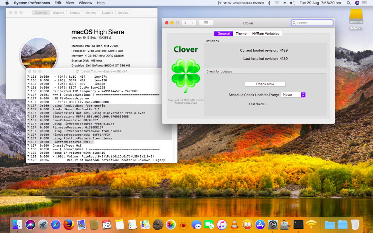

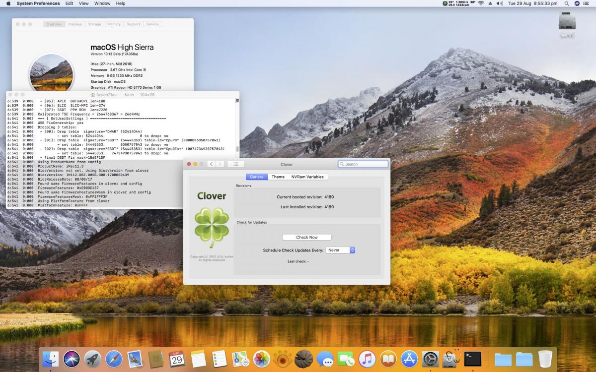

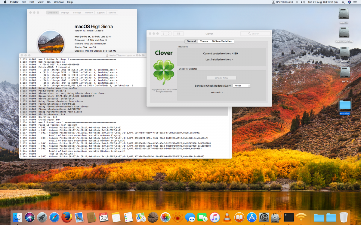

fusion71au Posted August 29, 2017 Share Posted August 29, 2017 No problems with update to DB8_17A358a on my systems (by directly running "Install macOS High Sierra Beta.app"): 1. NUC6i5SYH with UEFI/Intel i5-6260U/Iris 540/APFS SSD 2. GA-P55aUD3 with legacy BIOS/Intel i5-750/ATI HD5770/APFS HDD 3. Dell XPS M1530 with legacy BIOS/Intel T9300/Geforce 8600M GT/HFS+ Ext HDD Installation Notes Updated to latest Clover r4189, Clover injected default values for FF/FFM/PF and BIOS ver/date/Board-ID data (iMac17,1, iMac11,3 & MBP 7,1) Latest apfs.efi driver in /EFI/CLOVER/drivers64UEFI or /EFI/CLOVER/drivers64 No EmuVariableUefi-64 for my Skylake NUC On my legacy machines, made sure to remove all NVRAM.plist files from all EFI partitions (incl USB drives), ran sudo NVRAM -c command in terminal to reset NVRAM prior to update A windows disk present on the machine during installation is OK. apfs.zip Clover_v2.4k_r4189.zip 2 Link to comment https://www.insanelymac.com/forum/topic/324194-pre-release-macos-high-sierra/page/129/#findComment-2486368 Share on other sites More sharing options...

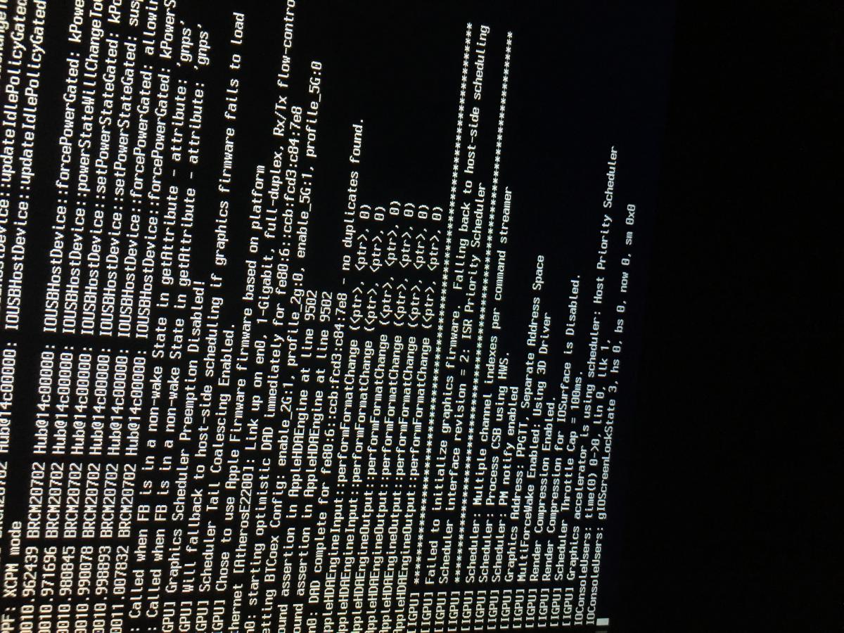

niknod Posted August 29, 2017 Share Posted August 29, 2017 Yes still getting (macbook-pro.home.com.apple.xpc.launchd[1] (com.apple.windowserver) <notice>: service only ran for 8 seconds. Pushing respawn out by 10 seconds) on high Sierra Beta 7 with laptop HD4600 Link to comment https://www.insanelymac.com/forum/topic/324194-pre-release-macos-high-sierra/page/129/#findComment-2486372 Share on other sites More sharing options...

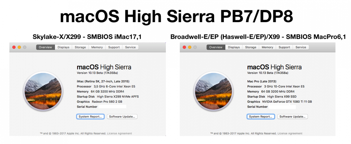

kgp Posted August 29, 2017 Share Posted August 29, 2017 Skylake-X/X299 and Broadwell-E/EP (Haswell-E/EP)/X99 upgrade to macOS High Sierra 10.13 PB7/DP8 smoothly without issues! Hint: To prevent the Firmware Update Error it seems sufficient to unplug the NVMe / SSD / HDD carrying the Windows partition! Link to comment https://www.insanelymac.com/forum/topic/324194-pre-release-macos-high-sierra/page/129/#findComment-2486374 Share on other sites More sharing options...

sandro_desktop Posted August 29, 2017 Share Posted August 29, 2017 Yes still getting (macbook-pro.home.com.apple.xpc.launchd[1] (com.apple.windowserver) <notice>: service only ran for 8 seconds. Pushing respawn out by 10 seconds) on high Sierra Beta 7 with laptop HD4600 same issue here on Asus N550JV Haswell HD 4600... cheers! Link to comment https://www.insanelymac.com/forum/topic/324194-pre-release-macos-high-sierra/page/129/#findComment-2486425 Share on other sites More sharing options...

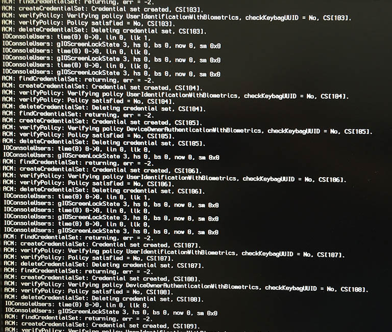

apfelnico Posted August 29, 2017 Share Posted August 29, 2017 Does anyone have any idea what that might be? @slice ? (ASUS PRIME X299 DELUXE, i9-7900X, RADEON VEGA64) Link to comment https://www.insanelymac.com/forum/topic/324194-pre-release-macos-high-sierra/page/129/#findComment-2486464 Share on other sites More sharing options...

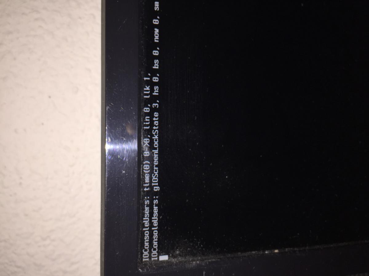

mnfesq Posted August 29, 2017 Share Posted August 29, 2017 Yes still getting (macbook-pro.home.com.apple.xpc.launchd[1] (com.apple.windowserver) <notice>: service only ran for 8 seconds. Pushing respawn out by 10 seconds) on high Sierra Beta 7 with laptop HD4600 Did not work, error persists IMG_3174.JPG IMG_3175.JPG For both of you, I had the same problem as you and fixed it. I had to remove my discreet GPU from my DSDT so that only the Intel HD GPU shows up in System Info. I also had to remove my custom SSDT and let Clover make my SSDT (Generate PStates, Generate CStates, Enable C7) It took a while to get this right but it worked for me. 1 Link to comment https://www.insanelymac.com/forum/topic/324194-pre-release-macos-high-sierra/page/129/#findComment-2486582 Share on other sites More sharing options...
