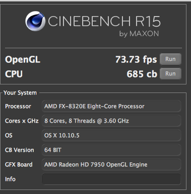

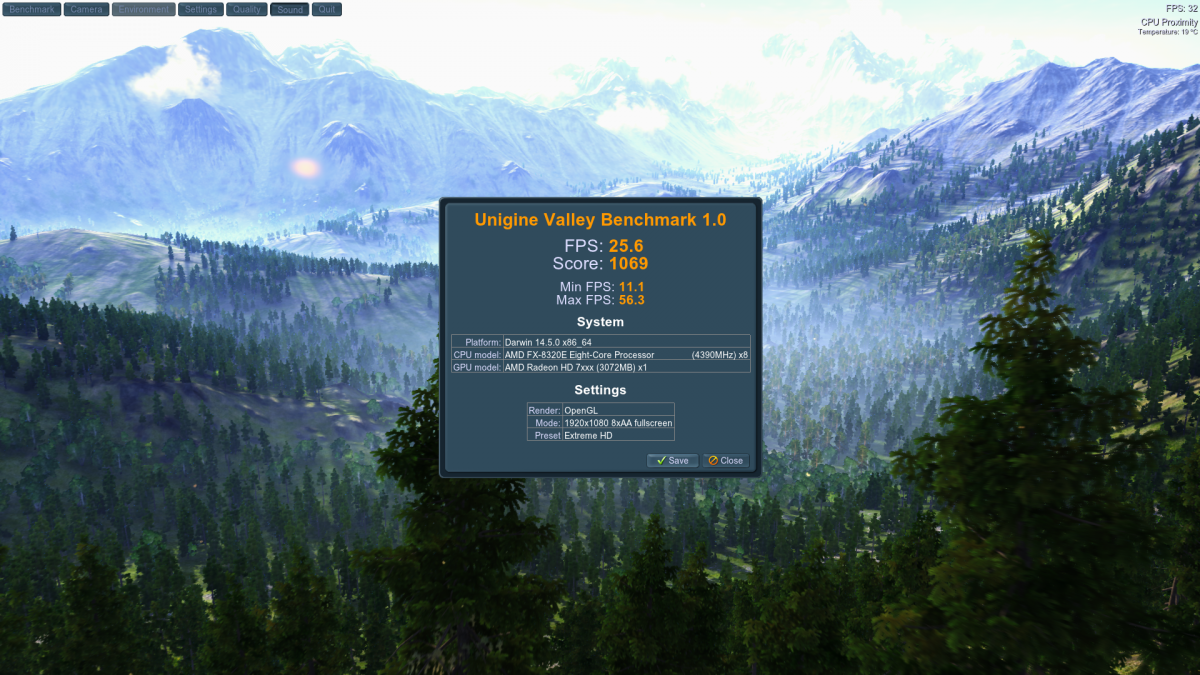

alllp Posted September 30, 2015 Share Posted September 30, 2015 it works now wow! but I am dealing with sound, perf issues etc... well, big step for me what is the best testing software for chipset & gpu? 1 Link to comment https://www.insanelymac.com/forum/topic/285760-help-topic-for-help-in-os-x-yosemite-1010-and-below/page/107/#findComment-2171499 Share on other sites More sharing options...
spakk Posted September 30, 2015 Share Posted September 30, 2015 Congratulations, it was like a hard bowel movements but after work feels one liberated. try CINEBENCH R15 Link to comment https://www.insanelymac.com/forum/topic/285760-help-topic-for-help-in-os-x-yosemite-1010-and-below/page/107/#findComment-2171501 Share on other sites More sharing options...
gils83 Posted September 30, 2015 Share Posted September 30, 2015 Valley , heaven 4.0 , Geek3D , CompuBenchCL etc...... Link to comment https://www.insanelymac.com/forum/topic/285760-help-topic-for-help-in-os-x-yosemite-1010-and-below/page/107/#findComment-2171509 Share on other sites More sharing options...

alllp Posted October 1, 2015 Share Posted October 1, 2015 well appaerantly the same hardware works better under windows 10, I guess when the hardware is not very compatible with OS X, it works slower than windows, how do you think? Here is the results; OS X YOSEMITE 10.10.5 WINDOWS 10 Link to comment https://www.insanelymac.com/forum/topic/285760-help-topic-for-help-in-os-x-yosemite-1010-and-below/page/107/#findComment-2171819 Share on other sites More sharing options...
gils83 Posted October 1, 2015 Share Posted October 1, 2015 (edited) I have just tested to boot with these drivers. the system reminds me of my first 386-he personal computer. I need to remove these drivers otherwise is OS X unusable, the graphics and the CPU performance are extremely lazy ! ?? i tested well appaerantly the same hardware works better under windows 10, I guess when the hardware is not very compatible with OS X, it works slower than windows, how do you think? Here is the results; OS X YOSEMITE 10.10.5 WINDOWS 10 wooh !!?? use voodopstate ? look in Console and write freq Edited October 1, 2015 by gils83 Link to comment https://www.insanelymac.com/forum/topic/285760-help-topic-for-help-in-os-x-yosemite-1010-and-below/page/107/#findComment-2171842 Share on other sites More sharing options...

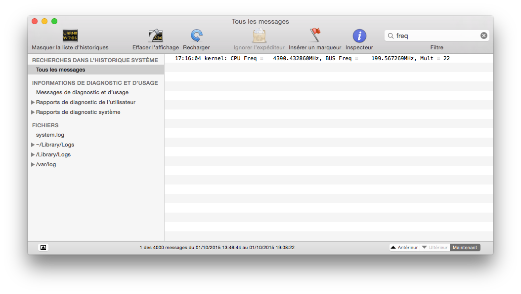

lacikau Posted October 4, 2015 Share Posted October 4, 2015 Hello! I spent the last three days with installing, googling, but I can't deal with this any more. I need some help. My build: - AMD FX-8350 - KINGSTON 2x8GB - GA-990FXA-UD5 - SAPPHIRE RADEON HD 7950 3GB - SAMSUNG SSD 840 Series I successfully installed Hackintosh on my PC (downloaded from AppStore) OSX version: Yosemite 10.10.5 Boot loader: Chimera Kernel: http://www.insanelymac.com/forum/files/file/461-amd-kernel-yosemite-10105-sseplus/ - installed this because the spinning wheel of death: http://www.insanelymac.com/forum/files/file/354-amd-replace-kext-for-yosemite/ - patched AMDRadeonX4000 cail_properties - patched AMD7000Controller - Futomaki framebuffer, this method: http://www.insanelymac.com/forum/topic/303186-how-to-modification-of-amd-fb-clover-injection/- binary patch instead of clover - didn't help... same as before... - installed ACL889 audio: http://www.insanelymac.com/forum/files/file/176-experimental-6-channel-applehda-for-alc889/with HDAEnabler - installed RTL8111 ethernet: https://github.com/Mieze/RTL8111_driver_for_OS_X - installed USB3.0: http://www.insanelymac.com/forum/files/file/150-patched-appleusbxhci/ - installed FakeSMC - enabled TRIM My system is up and running, BUT only two of my three monitors are working. I spent the last 3 days debugging this issue, but I couldn't find a solution for that. The system recognises all three, but one of them (random) is black all the time (not blinking, black). I know there is a sleep/wake fix for that, but If I sleep my system, can't wake it again. More specifically it wakes up, but no usb, no ethernet, only the three frozen desktop. It hangs. I have to hard-reset all the time. Could somebody please help me? I don't know how to fix the sleep/wake issue, but now my system is pretty much useless without the third monitor and/or the sleep. Thank you! 1 Link to comment https://www.insanelymac.com/forum/topic/285760-help-topic-for-help-in-os-x-yosemite-1010-and-below/page/107/#findComment-2173341 Share on other sites More sharing options...
lacikau Posted October 4, 2015 Share Posted October 4, 2015 Screenshots: http://imgur.com/a/HxVWw ioreg: Admins-Mac-Pro:~ admin$ ioreg | grep ATY | | | | +-o ATY,AMD,RadeonFramebuffer@0 <class AtiFbStub, id 0x10000036c, registered, matched, active, busy 0 (242 ms), retain 8> | | | | +-o ATY,AMD,RadeonFramebuffer@1 <class AtiFbStub, id 0x10000036d, registered, matched, active, busy 0 (1 ms), retain 8> | | | | +-o ATY,AMD,RadeonFramebuffer@2 <class AtiFbStub, id 0x10000036e, registered, matched, active, busy 0 (1 ms), retain 8> | | | | +-o ATY,AMD,RadeonFramebuffer@3 <class AtiFbStub, id 0x10000036f, registered, matched, active, busy 0 (0 ms), retain 8> kernel flags: PCIRootUID=1 npci=0x3000 -v kext-dev-mode=1 GraphicsEnabler=Yes AtiConfig=Futomaki AtiPorts=4 Link to comment https://www.insanelymac.com/forum/topic/285760-help-topic-for-help-in-os-x-yosemite-1010-and-below/page/107/#findComment-2173382 Share on other sites More sharing options...
