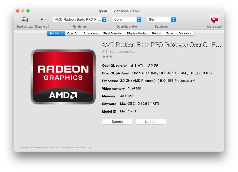

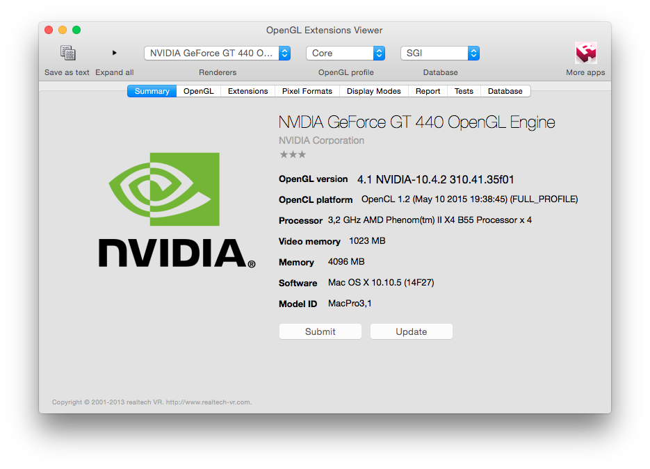

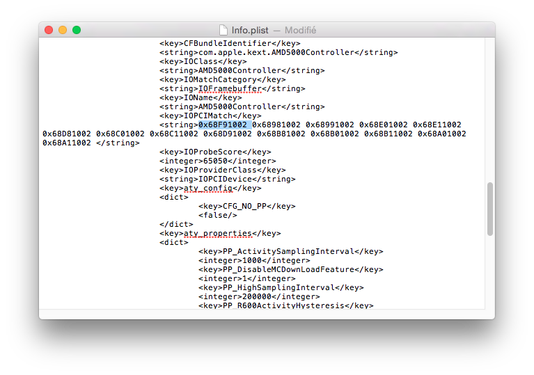

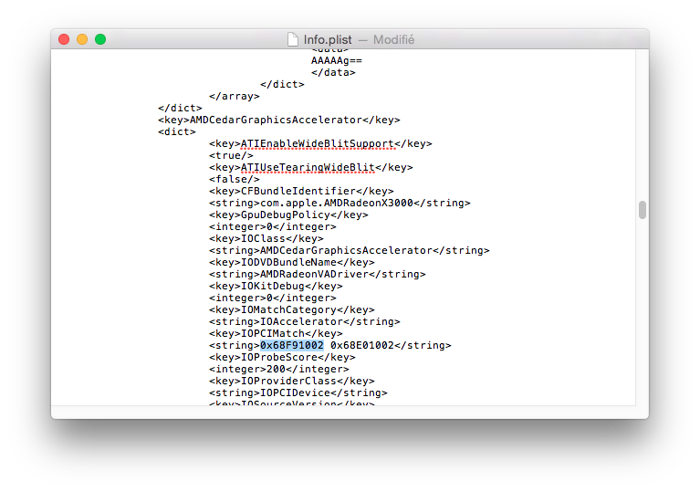

gils83 Posted September 27, 2015 Share Posted September 27, 2015 no problemo !! edit plist for HD 5450 2 Link to comment https://www.insanelymac.com/forum/topic/285760-help-topic-for-help-in-os-x-yosemite-1010-and-below/page/104/#findComment-2170653 Share on other sites More sharing options...

gils83 Posted September 27, 2015 Share Posted September 27, 2015 (edited) flag for GT 440 GraghicsEnabler=Yes nvda_drv=1 PCIRootUID=1 revolution in the world !!?? , why ? edit , methode GPU for AMD CPU = methode for Intel CPU Edited September 27, 2015 by gils83 Link to comment https://www.insanelymac.com/forum/topic/285760-help-topic-for-help-in-os-x-yosemite-1010-and-below/page/104/#findComment-2170656 Share on other sites More sharing options...

gils83 Posted September 27, 2015 Share Posted September 27, 2015 Why not bootloader clover? For there is no clover in args: PCIRootUID & GE=Yes. idem Clover , flag GraphicsInjector=Yes PCIRootUID=1 nvda_drv=1 Link to comment https://www.insanelymac.com/forum/topic/285760-help-topic-for-help-in-os-x-yosemite-1010-and-below/page/104/#findComment-2170701 Share on other sites More sharing options...
