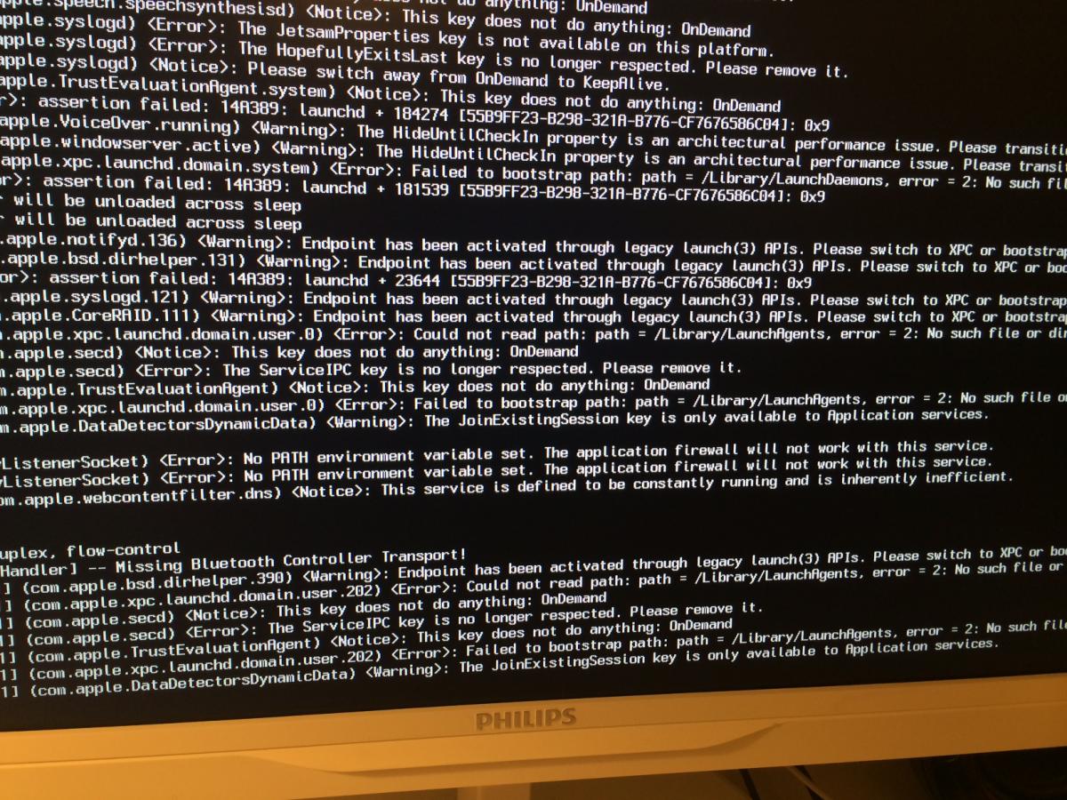

lpukraine Posted September 25, 2015 Share Posted September 25, 2015 I'm a beginner (only started using hackintosh 3 days ago and never had a mac in my life). So be gentle I've been learning a lot in the last 3 days. I've started with niresh 10.10.1 on my amd system (see my sig) and upgraded it to 10.10.5. It's been a wild ride since I had to try two different mobos and two graphics cards before I found a setup that works well (gtx 570 looks promising but eventually always starts to have problem with official drivers or with web drivers, when I switched to gtx 610 things stabilised). (plus I had to learn all the mac stuff, I'm coming from the linux world) My question is: I tried all the different kernels when upgrading to 10.10.5. My bootloader at the time was chameleon (I used different versions). spakk_10105 is the one that worked for me. But then I switched to enoch bootloader and I saw that it patches a prelinked kernel. My question is: the prelinked kernel that enoch is patching, that looks to me the stock kernel that comes with 10.10.5. Is enoch simply patching the stock kernel? And second question: the power management on AMD, I understand most people are using the nullCpuPowerManagement. Perhaps stupid question, but can PM get working on AMD with DSDT/SSDT? I don't really know what DSDT/SSDT are and somewhere I read they are Intel specific, my understanding is that DSDT defines the specific of the motherboard (and perhaps broader than just the mobo). If this is the case DSDT is needed to define how to setup PM for specific motherboard+CPU irrespective of CPU being Intel or AMD? What I'd like to have is the ability to suspend my system. (I'm ok to run at 100% performance all the time just having suspend would be nice) Sorry, but the title of this topic is [AMD] Yosemite Kernel Testing (for help use the Help Topic) - http://www.insanelymac.com/forum/topic/285760-help-topic-further-help-in-chatosx86hulegacykernel-irc/ 1 Link to comment https://www.insanelymac.com/forum/topic/285760-help-topic-for-help-in-os-x-yosemite-1010-and-below/page/102/#findComment-2170212 Share on other sites More sharing options...
darko555 Posted September 25, 2015 Share Posted September 25, 2015 I'm a beginner (only started using hackintosh 3 days ago and never had a mac in my life). So be gentle I've been learning a lot in the last 3 days. I've started with niresh 10.10.1 on my amd system (see my sig) and upgraded it to 10.10.5. It's been a wild ride since I had to try two different mobos and two graphics cards before I found a setup that works well (gtx 570 looks promising but eventually always starts to have problem with official drivers or with web drivers, when I switched to gtx 610 things stabilised). (plus I had to learn all the mac stuff, I'm coming from the linux world) My question is: I tried all the different kernels when upgrading to 10.10.5. My bootloader at the time was chameleon (I used different versions). spakk_10105 is the one that worked for me. But then I switched to enoch bootloader and I saw that it patches a prelinked kernel. My question is: the prelinked kernel that enoch is patching, that looks to me the stock kernel that comes with 10.10.5. Is enoch simply patching the stock kernel? And second question: the power management on AMD, I understand most people are using the nullCpuPowerManagement. Perhaps stupid question, but can PM get working on AMD with DSDT/SSDT? I don't really know what DSDT/SSDT are and somewhere I read they are Intel specific, my understanding is that DSDT defines the specific of the motherboard (and perhaps broader than just the mobo). If this is the case DSDT is needed to define how to setup PM for specific motherboard+CPU irrespective of CPU being Intel or AMD? What I'd like to have is the ability to suspend my system. (I'm ok to run at 100% performance all the time just having suspend would be nice) Link to comment https://www.insanelymac.com/forum/topic/285760-help-topic-for-help-in-os-x-yosemite-1010-and-below/page/102/#findComment-2170215 Share on other sites More sharing options...
spakk Posted September 25, 2015 Share Posted September 25, 2015 @lpukraine,you've got me completely messed up today. here are discussed only the issues and problems associated with Yosemite kernel development, no support and assistance related to the installation of OS X or the problems caused by the installation. help toppic can be found here: http://www.insanelymac.com/forum/topic/285760-help-topic-further-help-in-chatosx86hulegacykernel-irc/page-128?do=findComment&comment=2170215 2 Link to comment https://www.insanelymac.com/forum/topic/285760-help-topic-for-help-in-os-x-yosemite-1010-and-below/page/102/#findComment-2170252 Share on other sites More sharing options...

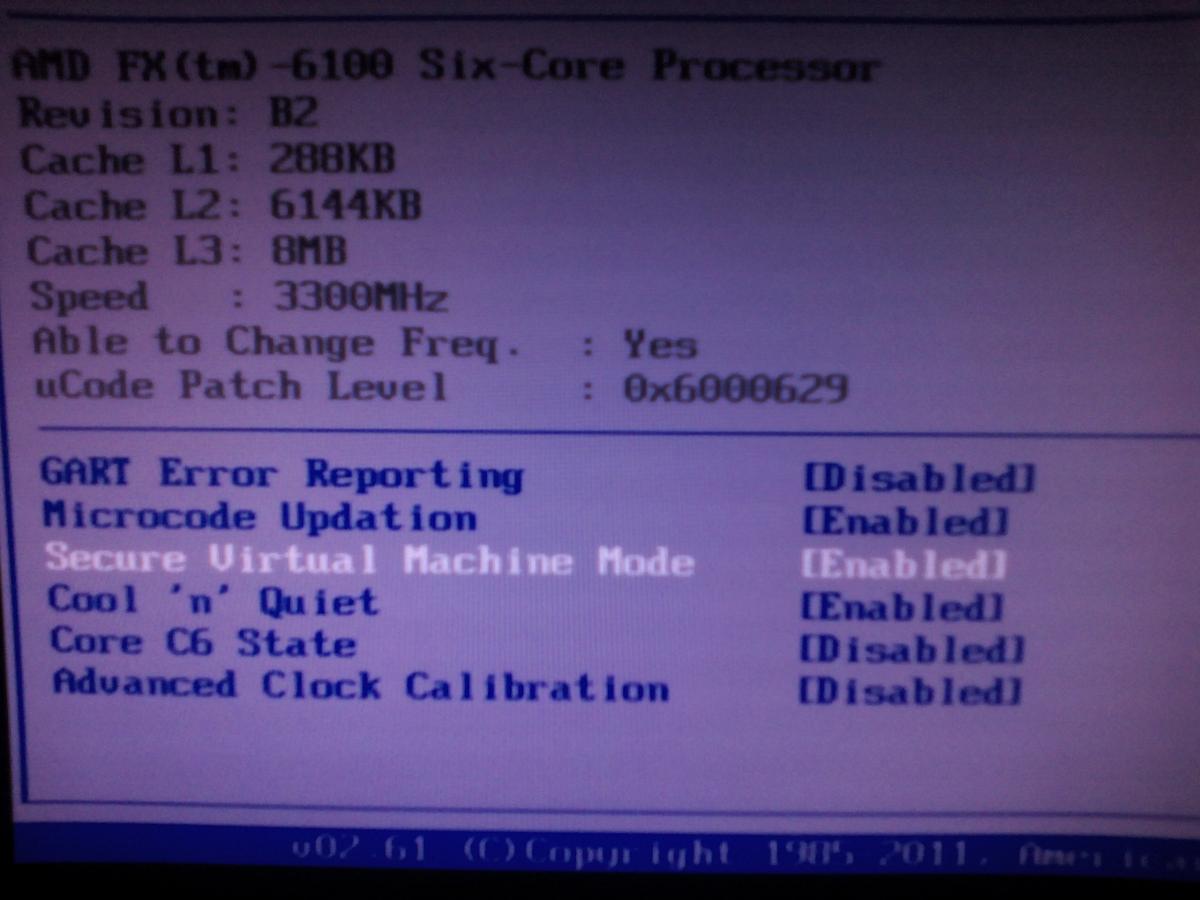

itisme754 Posted September 26, 2015 Share Posted September 26, 2015 I installed yosemite 10.10.5 with Spakk kernel patch. The thing is I can only boot with safe mode (-x). Without safe mode, I get to a grey screen with a spinning beach ball. Here's my build: Amd fx 8350 ga-990fxa-ud3 2x4gb ram hd 7770 Some help would be appreciated. Thanks. Link to comment https://www.insanelymac.com/forum/topic/285760-help-topic-for-help-in-os-x-yosemite-1010-and-below/page/102/#findComment-2170358 Share on other sites More sharing options...
alllp Posted September 26, 2015 Share Posted September 26, 2015 hi, I could go further possible but stucked at graphics card issue. my specs are AMD FX 8300, sapphire R9 280 (hd 7950). I used bronya's patched kernel, I tried to use kexts for hd7950 in extra folder. (normally this card's id included in vanilla kernels as 0x679a1002) but it doesnt load the installation screen. I tried different boot flags, no luck. Besides this installer goes nice until here. (screenshot) any advices? Link to comment https://www.insanelymac.com/forum/topic/285760-help-topic-for-help-in-os-x-yosemite-1010-and-below/page/102/#findComment-2170395 Share on other sites More sharing options...
spakk Posted September 26, 2015 Share Posted September 26, 2015 I installed yosemite 10.10.5 with Spakk kernel patch. The thing is I can only boot with safe mode (-x). Without safe mode, I get to a grey screen with a spinning beach ball. Here's my build: Amd fx 8350 ga-990fxa-ud3 2x4gb ram hd 7770 Some help would be appreciated. Thanks. Modify the AMDRadeonX4000.kext as described below Editing in: S/L/Extensions/AMDRadeonX4000.kext/Contents/Info.plist cail_properties CAIL_DisableDrmdmaPowerGating 1 CAIL_DisableDynamicGfxMGPowerGating 1 CAIL_DisableGfxCGPowerGating 1 CAIL_DisableGmcPowerGating 1 CAIL_DisableStaticGfxMGPowerGating 1 CAIL_DisableUVDPowerGating 0 CAIL_DisableVCEPowerGating 1 if there could be problems then make these adjustments: cail_properties CAIL_DisableDrmdmaPowerGating 0 CAIL_DisableDynamicGfxMGPowerGating 1 CAIL_DisableGfxCGPowerGating 1 CAIL_DisableGmcPowerGating 1 CAIL_DisableStaticGfxMGPowerGating 1 CAIL_DisableUVDPowerGating 0 CAIL_DisableVCEPowerGating 1 1 Link to comment https://www.insanelymac.com/forum/topic/285760-help-topic-for-help-in-os-x-yosemite-1010-and-below/page/102/#findComment-2170424 Share on other sites More sharing options...
