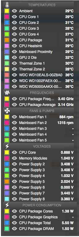

Hello, I have a problem with readings v-core and motherboard parameters. My v-core is always stay on 0.888v but that is adaptive core and need to be between 0.07v and 1.18v with AVX 2 max 1.265v. second problem is motherboard readings for DDR memory and 12v, 5v .... I will link a picture to see what Im talking about. I tried many different versions of hwsensors for Asus Gryphon, but every time I got same result. if someone can give me link to proper hwsensors, that will be nice :)
P.S I found on couple places for Nuvoton NCT6791D sensors and it seems that kozlek brach support it, but as you can see on my picture that is not case.
