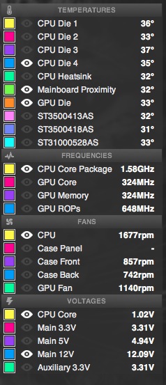

haxzion Posted May 8, 2013 Share Posted May 8, 2013 Kozlek this set is working for AsRock p67 Pro3 (Nuvoton NCT6776F) ..add it if you want AsRock P67pro3.zip I don't currently use a side panel fan,that's why you see a dash. CPU and GPU running at lowest state.. Link to comment https://www.insanelymac.com/forum/topic/275429-hwsensors/page/35/#findComment-1913590 Share on other sites More sharing options...
