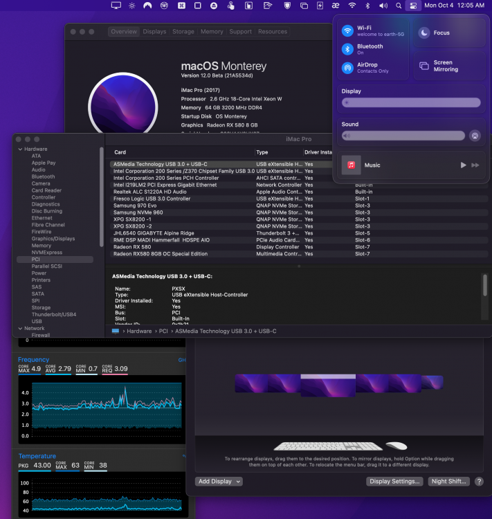

Ellybz Posted October 4, 2021 Share Posted October 4, 2021 Arriving late at the party ...But all is 👍 on X299 😃🖖 4 1 Link to comment https://www.insanelymac.com/forum/topic/348725-pre-release-macos-monterey/page/59/#findComment-2768339 Share on other sites More sharing options...

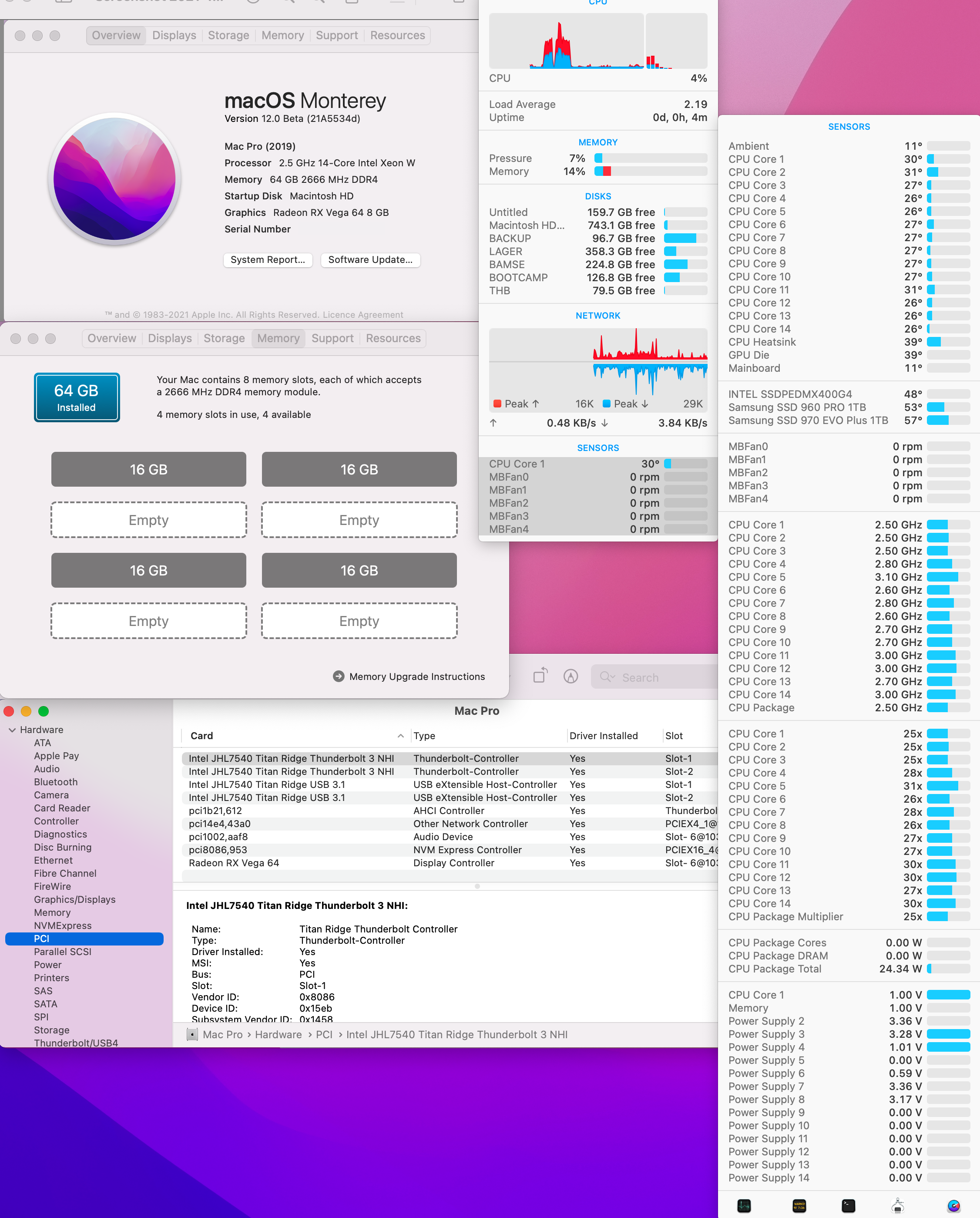

obus Posted October 5, 2021 Share Posted October 5, 2021 (edited) 5 hours ago, vit9696 said: RestrictEvents is not needed (by 99.99% of setups). But still mandatory for us using MacPro7,1 for getting PCI Expansion view and RAM view correctly I suppose? Edited October 5, 2021 by obus Link to comment https://www.insanelymac.com/forum/topic/348725-pre-release-macos-monterey/page/59/#findComment-2768493 Share on other sites More sharing options...
pet1 Posted October 5, 2021 Share Posted October 5, 2021 26 minutes ago, obus said: But still mandatory for us using MacPro7,1 for getting PCI Expansion view and RAM view correctly I suppose? That's just cosmetic and redundant. All devices are already listed in their appropriate category. 1 Link to comment https://www.insanelymac.com/forum/topic/348725-pre-release-macos-monterey/page/59/#findComment-2768495 Share on other sites More sharing options...
obus Posted October 5, 2021 Share Posted October 5, 2021 Works nice on C422 too. Installed from USB without hickups with SMBIOS MacPro7,1. Use RestrictEvents just because I'm so vain and don't like messages about memory error even if it's cosmetic and redundant😉 2 Link to comment https://www.insanelymac.com/forum/topic/348725-pre-release-macos-monterey/page/59/#findComment-2768500 Share on other sites More sharing options...

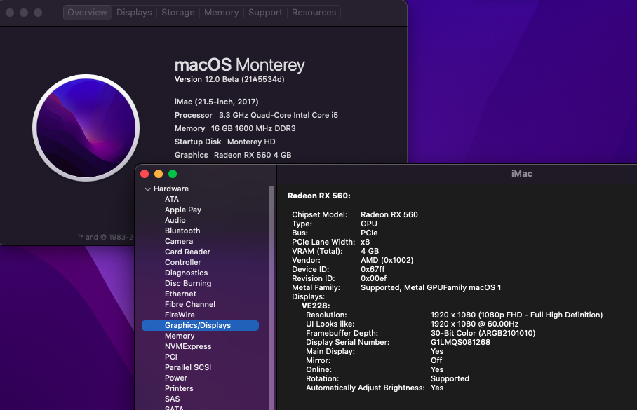

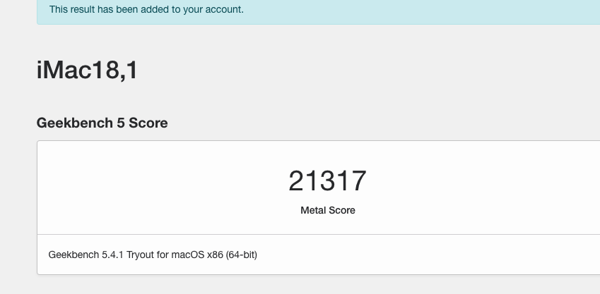

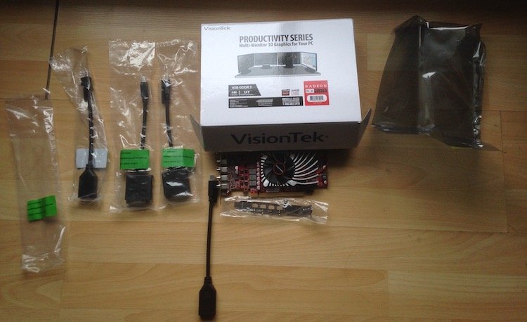

chris1111 Posted October 6, 2021 Share Posted October 6, 2021 (edited) I am Verry Happy today I receive my AMD Visiontek Radon RX 560 from USA This card is dedicated for my Main PC HP Prodesk 600 G1 with a Low profile graphics card The card is Native support Big Sur 11 and Monterey 12 This card run Like a swiss Clock Metal Score Big Sur 11 😀 https://browser.geekbench.com/v5/compute/3486428 Edited October 6, 2021 by chris1111 14 1 Link to comment https://www.insanelymac.com/forum/topic/348725-pre-release-macos-monterey/page/59/#findComment-2768576 Share on other sites More sharing options...
