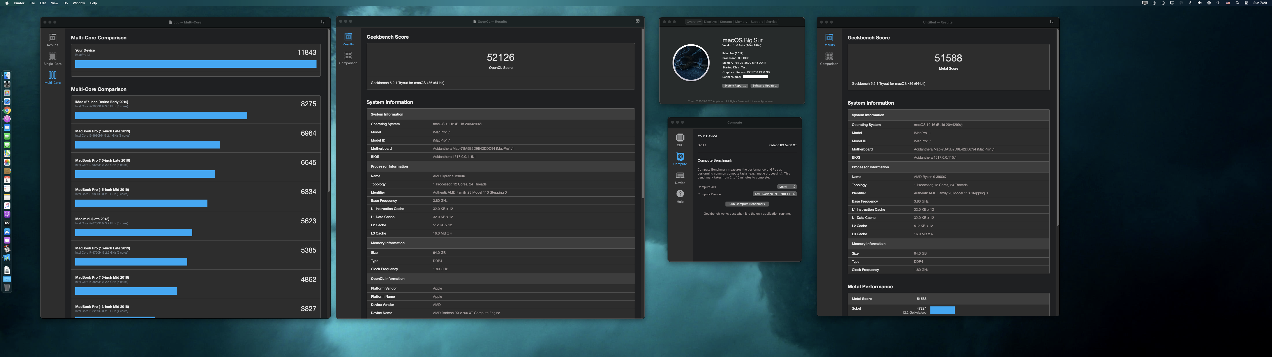

luki1979 Posted July 4, 2020 Share Posted July 4, 2020 @asdesoso Seems strange but Ivy Bridge and HD4000 support has been dropped in Big Sur hence why I think. My MacBook on Haswell cpu feels snappier on Big Sur, Geekbench scores the same as on Catalina for me. Link to comment https://www.insanelymac.com/forum/topic/344236-pre-release-macos-big-sur-in-vmware/page/44/#findComment-2728581 Share on other sites More sharing options...

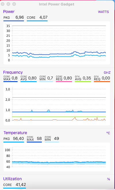

asdesoso Posted July 4, 2020 Share Posted July 4, 2020 Just now, luki1979 said: @asdesoso Seems strange but Ivy Bridge and HD4000 support has been dropped in Big Sur hence why I think. My MacBook on Haswell cpu feels snappier on Big Sur, Geekbench scores the same as on Catalina for me. Yes, I know it, but I saw some videos of MacBook Pro Mid 2012 Ivy Bridge running very quickly, which has more o less the same configuration of my HP laptop. Link to comment https://www.insanelymac.com/forum/topic/344236-pre-release-macos-big-sur-in-vmware/page/44/#findComment-2728582 Share on other sites More sharing options...
luki1979 Posted July 4, 2020 Share Posted July 4, 2020 @asdesoso check with Intel Power Gadget if CPU is stepping correctly, check if sleep work. Something not right. Link to comment https://www.insanelymac.com/forum/topic/344236-pre-release-macos-big-sur-in-vmware/page/44/#findComment-2728584 Share on other sites More sharing options...
asdesoso Posted July 4, 2020 Share Posted July 4, 2020 On 7/4/2020 at 11:45 AM, luki1979 said: @asdesoso check with Intel Power Gadget if CPU is stepping correctly, check if sleep work. Something not right. Sleep and ACPI, also HD4000 are working fine, I will try Intel Power Gadget. The CPU seems to be at 1 GHz at maximum, I think this is the problem of poor performance. Spoiler Link to comment https://www.insanelymac.com/forum/topic/344236-pre-release-macos-big-sur-in-vmware/page/44/#findComment-2728585 Share on other sites More sharing options...

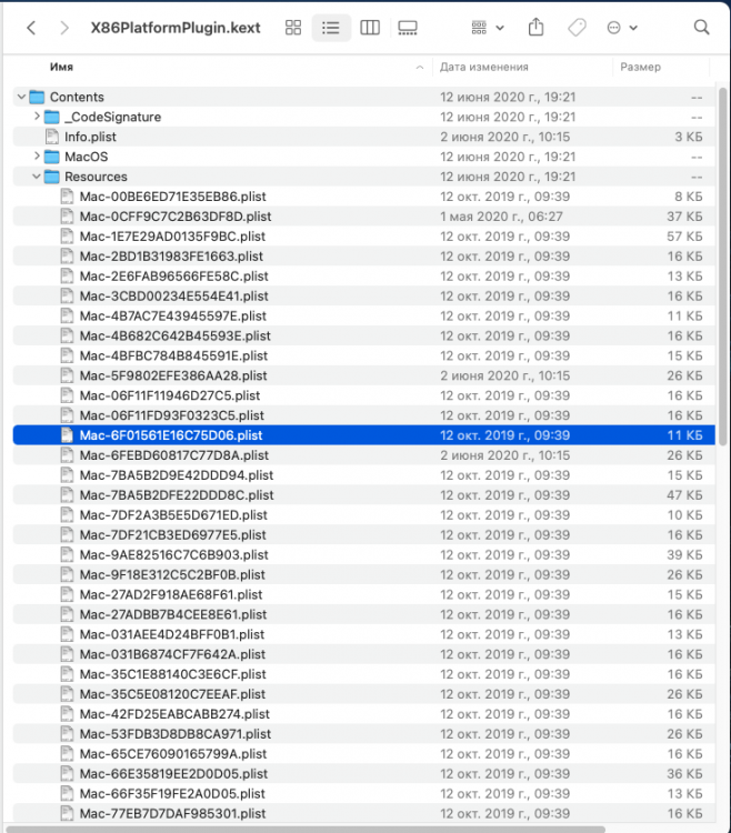

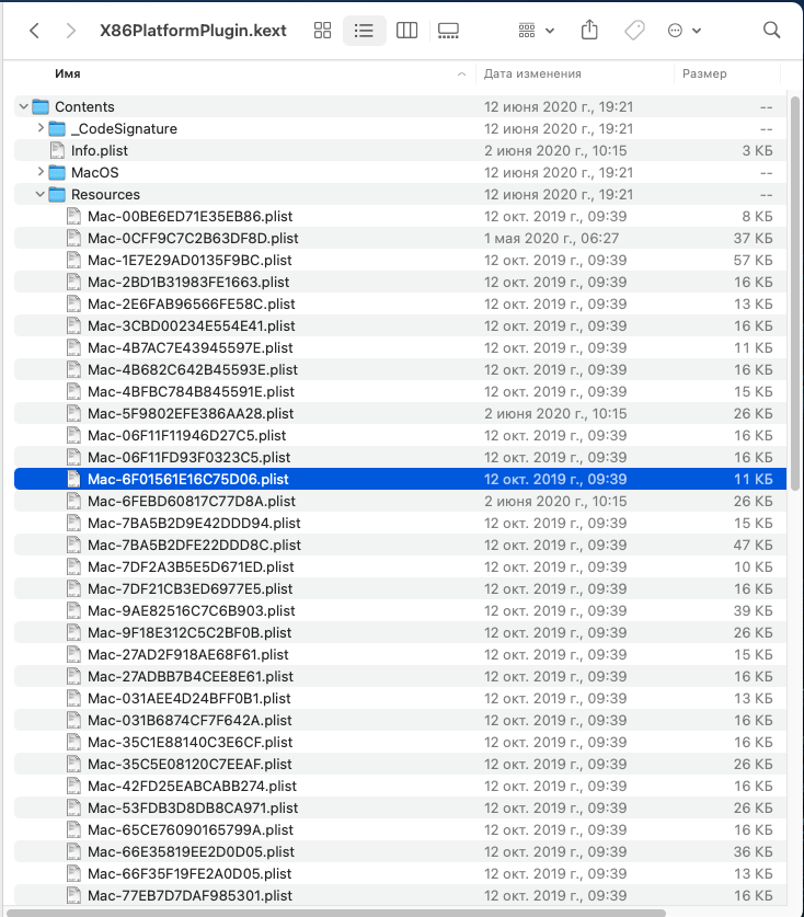

tyufhl Posted July 4, 2020 Share Posted July 4, 2020 On 7/4/2020 at 11:47 AM, asdesoso said: Sleep and ACPI, also HD4000 are working fine, I will try Intel Power Gadget. The CPU seems to be at 1 GHz at maximum, I think this is the problem of poor performance. Spoiler compare these settings for these models Spoiler Link to comment https://www.insanelymac.com/forum/topic/344236-pre-release-macos-big-sur-in-vmware/page/44/#findComment-2728600 Share on other sites More sharing options...

asdesoso Posted July 4, 2020 Share Posted July 4, 2020 On 7/4/2020 at 1:20 PM, tyufhl said: compare these settings for these models Spoiler You mean that I should compare both 9.2 and 11.1 .plist through X86PlatformPlugin.kext? Link to comment https://www.insanelymac.com/forum/topic/344236-pre-release-macos-big-sur-in-vmware/page/44/#findComment-2728604 Share on other sites More sharing options...

tyufhl Posted July 4, 2020 Share Posted July 4, 2020 @asdesoso yes. Link to comment https://www.insanelymac.com/forum/topic/344236-pre-release-macos-big-sur-in-vmware/page/44/#findComment-2728607 Share on other sites More sharing options...

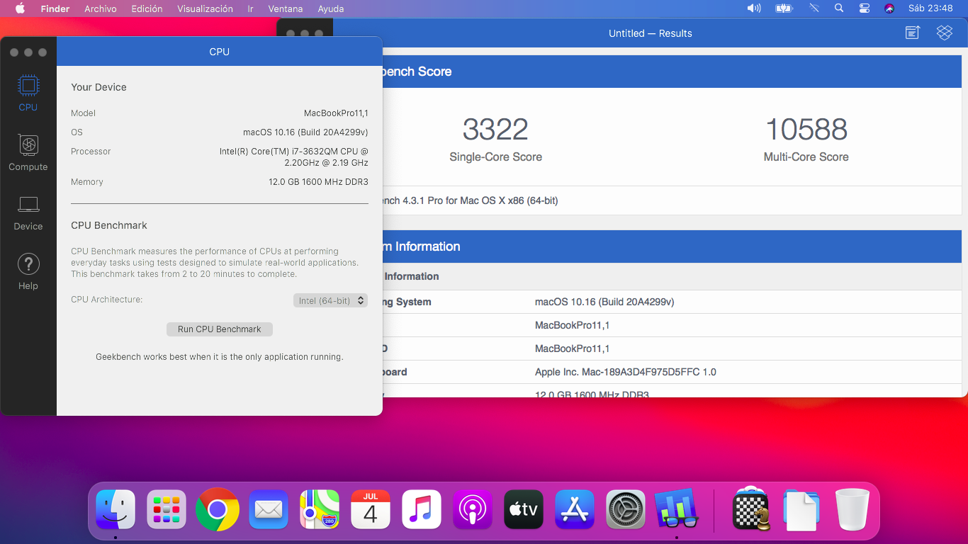

asdesoso Posted July 4, 2020 Share Posted July 4, 2020 (edited) 2 hours ago, tyufhl said: @asdesoso yes. But I don´t know what is needed to be compared. Could be that my i7-3632QM is partially unsupported on Big Sur and need some patches to function up to 3,2 GHz? Thanks Edited July 4, 2020 by asdesoso i7-3632QM is supported on Big Sur? Link to comment https://www.insanelymac.com/forum/topic/344236-pre-release-macos-big-sur-in-vmware/page/44/#findComment-2728612 Share on other sites More sharing options...
asdesoso Posted July 4, 2020 Share Posted July 4, 2020 Hi everyone, finally I am able to have my HP EliteBook 2570P fully working, except WiFi, but now the performance of Big Sur is very fast. The problem was that I didn´t complete the files from Catalina into ACPI/patched, and voila. Thanks for your help. Spoiler 3 Link to comment https://www.insanelymac.com/forum/topic/344236-pre-release-macos-big-sur-in-vmware/page/44/#findComment-2728615 Share on other sites More sharing options...
