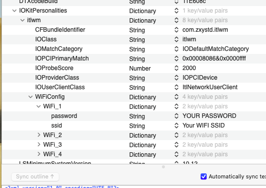

Well, in the end change the atheros card for an intel 9462 and it works very well in BigSur with itlwm.kext, in conclusion the lenovo Ideapad L340 15-iwl laptop is the perfect hackbook.
Intel Wifi? Care to share the kexts for everyone?
I can see your not actually connected to any WiFi network, does it work?
@SavageAUS
It works really well, my card is an Intel-9462NGW, I think I can't put links but I'll leave you a file with the kext I use, first you open the kext with the option show package content, you modify the file info.plist and in the image section you modify the ssid and your internet password, you save it and put the kext in the opencore kexts folder and modify your config.plist to add it.  Reboot your computer, open the Heliport app to see the status and connect to another network.
Credits to the creators of the itlwm kext and the Heliport app.

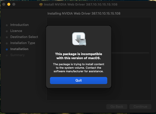

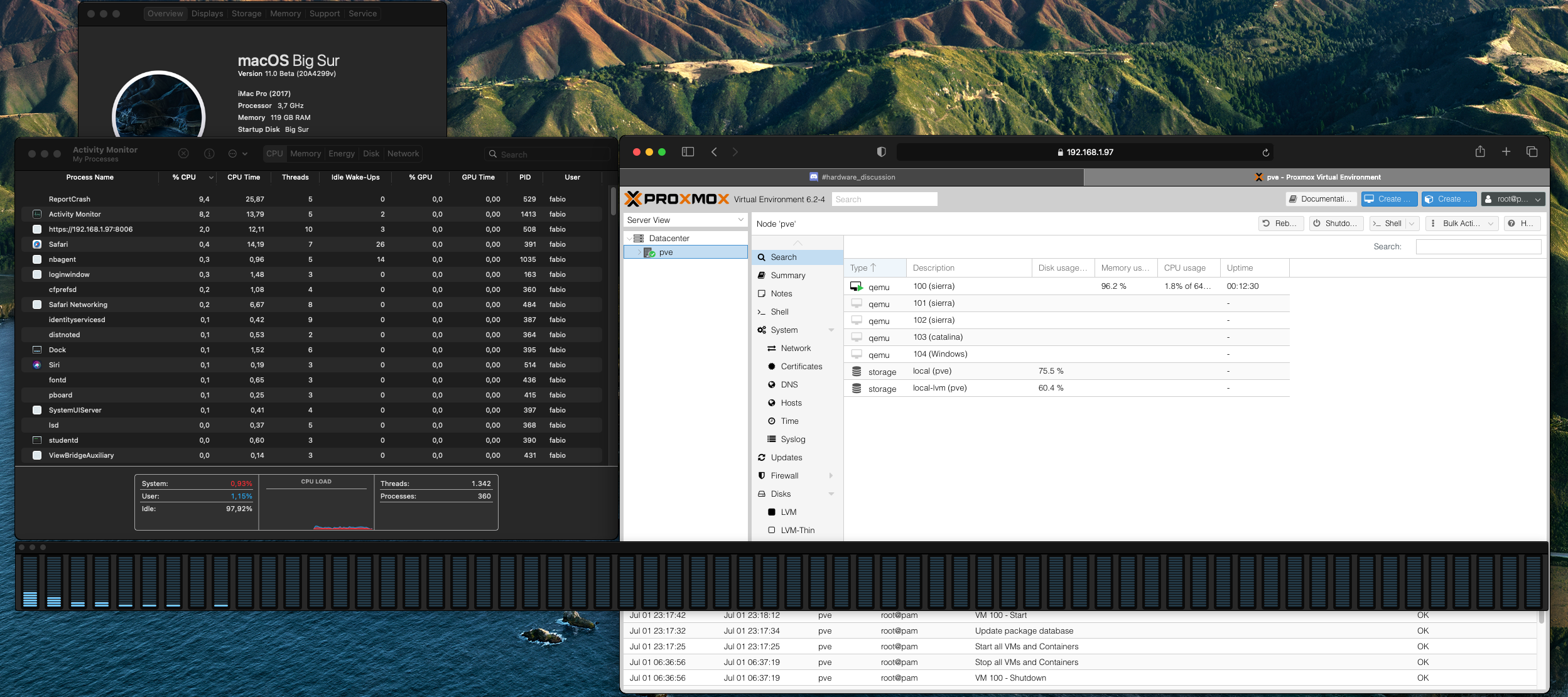

Fresh install from Big Sur application app in Proxmox on my AMD 3970x
First two installations steps done with Penryn Cpu in my vm config
Latest step done with Cpu set to host as usual
to reach a minimal dual display viewing with my Nvidia I am trying to install unlocked Nvidia drivers..but for now not possible to write in system volume>
