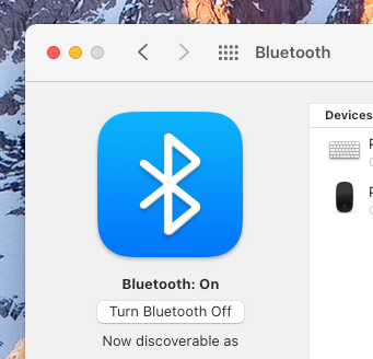

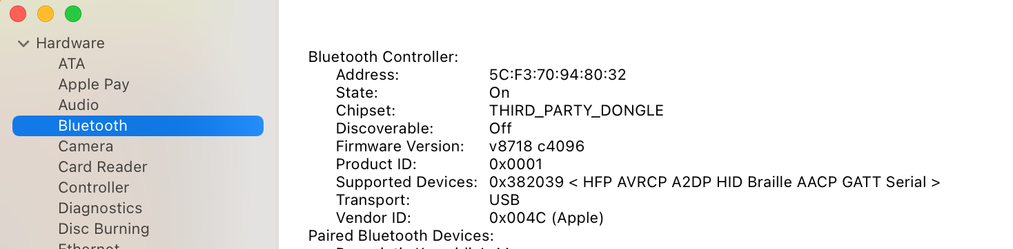

I just updated to 0.70.
I use Intel wifi and bluetooth.
Works great! What i noticed is that after i add HS14 for Bluetooth to work, the front usb 3.0 connector works with usb sticks but not with my 4.TB external drive(it shows in disk utility but cannot be mounted)
Of course with your Usbmap the front connectors work properly, so there is the conflict. Maybe if i disable an other unused port it will work?
Thnx for everything you have done so far for us!!
Edited by dsynos80
If I followed the discussion correctly. To get the prebuilt WiFi and Bluetooth from the Aorus Mainboard working, you just mapped the HS14 port in the USBMap.kext, right? So HS14 is Bluetooth and WiFi works just OOB?
You don't use any other kext files? like this one: https://github.com/OpenIntelWireless/itlwm
Sorry for asking many questions, I never thought that this would ever work. But you guys are awesome!
Edited by Blesh
The HS14 Port is included the USB mapping to give power to WIFI/B/Tooth. The onboard Intel WIFI/B-Tooth card is not native to Mac OS so you will need this  https://github.com/OpenIntelWireless/itlwm to make it work (can be somewhat flaky in operation) or better still, purchase and fit a combo card compatible to OS X.
