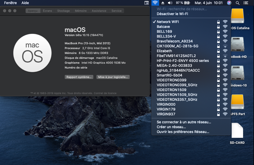

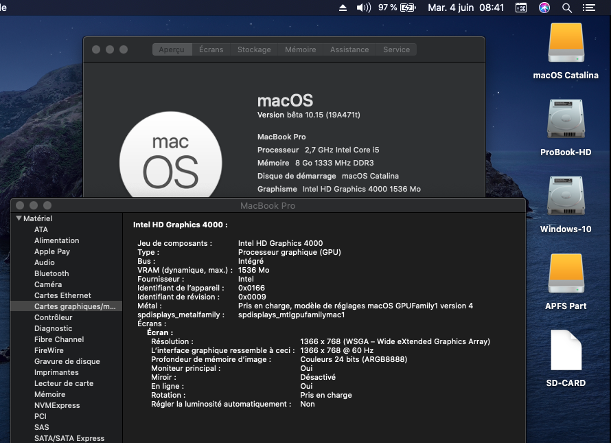

chris1111 Posted June 4, 2019 Share Posted June 4, 2019 Everything work here for the ProBook 6570b only Wifi BCM943234hmsnot working at the first boot 4 Link to comment https://www.insanelymac.com/forum/topic/339035-pre-release-macos-catalina/page/6/#findComment-2676309 Share on other sites More sharing options...

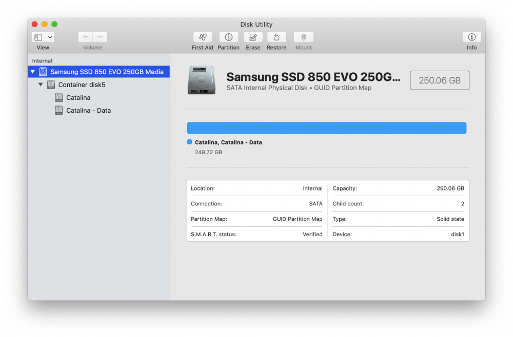

Cyberdevs Posted June 4, 2019 Share Posted June 4, 2019 This is how the new macOS separates system data from user's data which actually interesting to separate theme into two volumes. 2 Link to comment https://www.insanelymac.com/forum/topic/339035-pre-release-macos-catalina/page/6/#findComment-2676313 Share on other sites More sharing options...

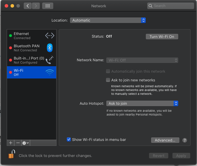

Sanom4 Posted June 4, 2019 Share Posted June 4, 2019 same here with BCM94331CD, wifi not working tried FakePCIID+FakePCIID Broadcom.kext, still not working. 1 Link to comment https://www.insanelymac.com/forum/topic/339035-pre-release-macos-catalina/page/6/#findComment-2676322 Share on other sites More sharing options...

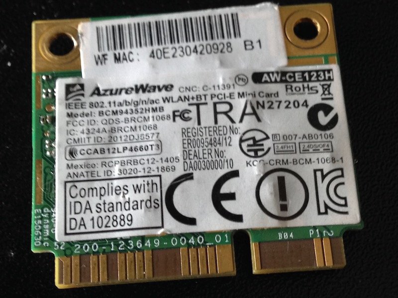

chris1111 Posted June 4, 2019 Share Posted June 4, 2019 OK My AzureWave works now Mojave and Catalina 4 Link to comment https://www.insanelymac.com/forum/topic/339035-pre-release-macos-catalina/page/6/#findComment-2676335 Share on other sites More sharing options...
Sanom4 Posted June 4, 2019 Share Posted June 4, 2019 28 minutes ago, chris1111 said: OK My AzureWave works now Mojave and Catalina How did you fixed it ? XD Link to comment https://www.insanelymac.com/forum/topic/339035-pre-release-macos-catalina/page/6/#findComment-2676336 Share on other sites More sharing options...
chris1111 Posted June 4, 2019 Share Posted June 4, 2019 (edited) 8 minutes ago, Sanom4 said: How did you fixed it ? XD Not really hard ArportBrcmFixup -lilubetaall SMBIOS MacBook Pro 9.2 thanks to Ivs1974 Edited June 4, 2019 by chris1111 1 Link to comment https://www.insanelymac.com/forum/topic/339035-pre-release-macos-catalina/page/6/#findComment-2676338 Share on other sites More sharing options...

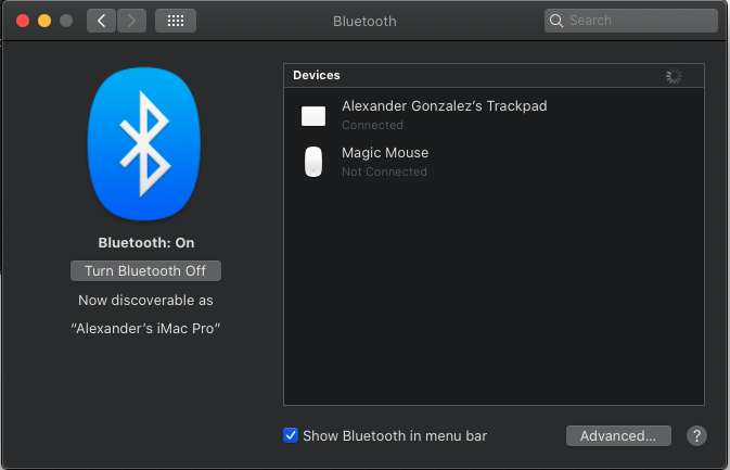

razor1995 Posted June 4, 2019 Share Posted June 4, 2019 33 minutes ago, chris1111 said: OK My AzureWave works now Which kexts you're using? I have Azurewave AW-CB160H (BCM94360HMB) and can't enable Bluetooth, while Wi-Fi works. Under Mojave used BrcmFirmwareRepo, BRCMPatchRAM2 and FakePCIID_Broadcom_WiFi. Link to comment https://www.insanelymac.com/forum/topic/339035-pre-release-macos-catalina/page/6/#findComment-2676340 Share on other sites More sharing options...
chris1111 Posted June 4, 2019 Share Posted June 4, 2019 (edited) 16 minutes ago, razor1995 said: Which kexts you're using? I have Azurewave AW-CB160H (BCM94360HMB) and can't enable Bluetooth, while Wi-Fi works. Under Mojave used BrcmFirmwareRepo, BRCMPatchRAM2 and FakePCIID_Broadcom_WiFi. Bluetooth not woking , try lots of things now but without success I have also Internal Bluetooth and I am not able to make it work Edited June 4, 2019 by chris1111 Link to comment https://www.insanelymac.com/forum/topic/339035-pre-release-macos-catalina/page/6/#findComment-2676343 Share on other sites More sharing options...
Sanom4 Posted June 4, 2019 Share Posted June 4, 2019 (edited) ArportBrcmFixup did not change anything it's still says status off, and not turning on, my card was working OOB on mojave Bluetooth working Edited June 4, 2019 by Sanom4 Link to comment https://www.insanelymac.com/forum/topic/339035-pre-release-macos-catalina/page/6/#findComment-2676345 Share on other sites More sharing options...
