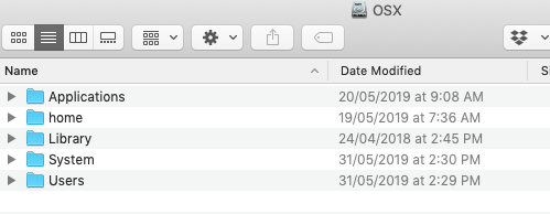

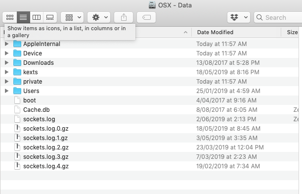

Here's a weird thing. Not that I've got it going (ACPI stall, then get to the apple logo then blank screen) but what it has done is split my volume up into the OS and data. But the data has some other stuff in it - screenshot:
No sign of the apps that were installed previous. So just to be clear, I had a few volumes - OSX, OSXbac and OSXHS now I have four - OSX and OSX data, OSXbak and OSXHS.
I'll try a clean install now :)

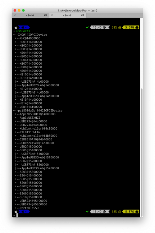

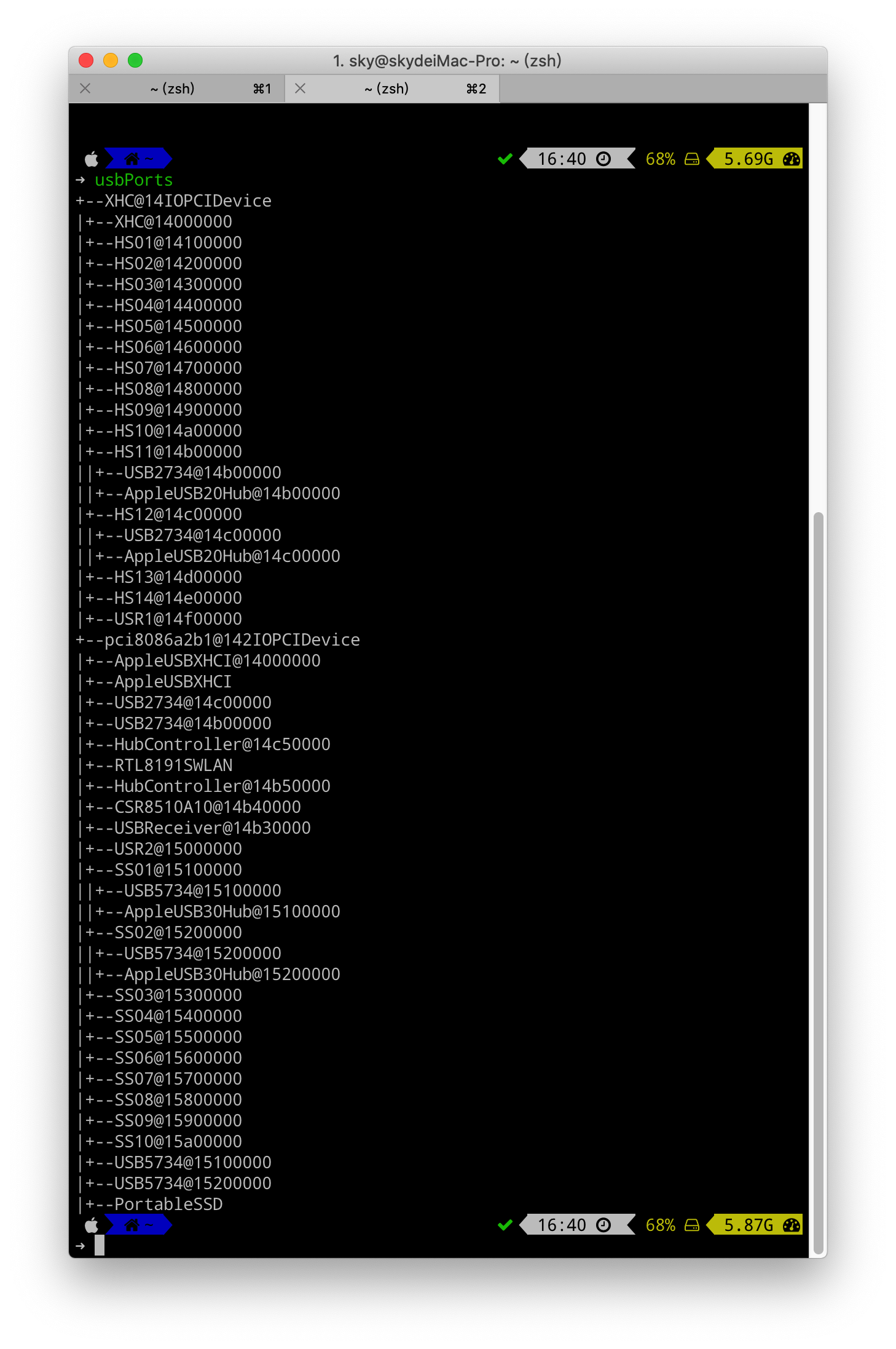

you are a hero! So what's the dvmt and Usb port limit patch in 10.15 db1 please :blush:
As for DVMT - I doubt it works with a raw patch, please wait for the update of WhateverGreen.
If you still need it, OK, please tell me which exact FB kext you'd like to patch? (Or rather all?! :D)
Regarding USB patches, I am not sure either, just made these patches based off what we have done under 10.14.5:
EDIT: Please see
And do NOT use the ones below!
IOUSBHostFamily #1
Find: 83FB0F0F87
Repl: 83FB3F0F87
IOUSBHostFamily #2
Find: 83E30FD3E34109DF
Repl: 83E33FD3E34109DF
AppleUSBXHCI #1
Find: 0F0F83
Repl: 3F0F83
Edited by PMheart
  • Like 6
