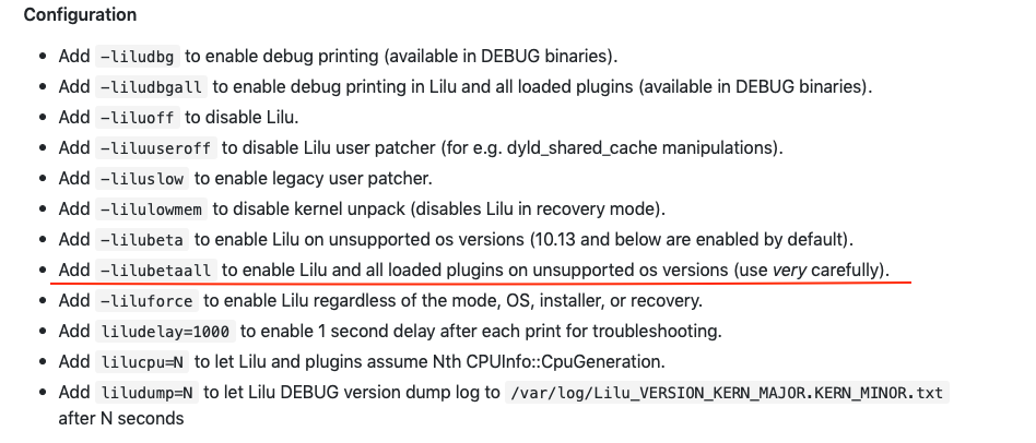

14 minutes ago, ITzTravelInTime said:
using the latest versions of lilu and it's plugins and using those boot args: -lilubetaall -lilubeta -alcbeta
No need if you compiled  the latest Lilu and plugins.. Available Here
In case,  -lilubetaall  does it all

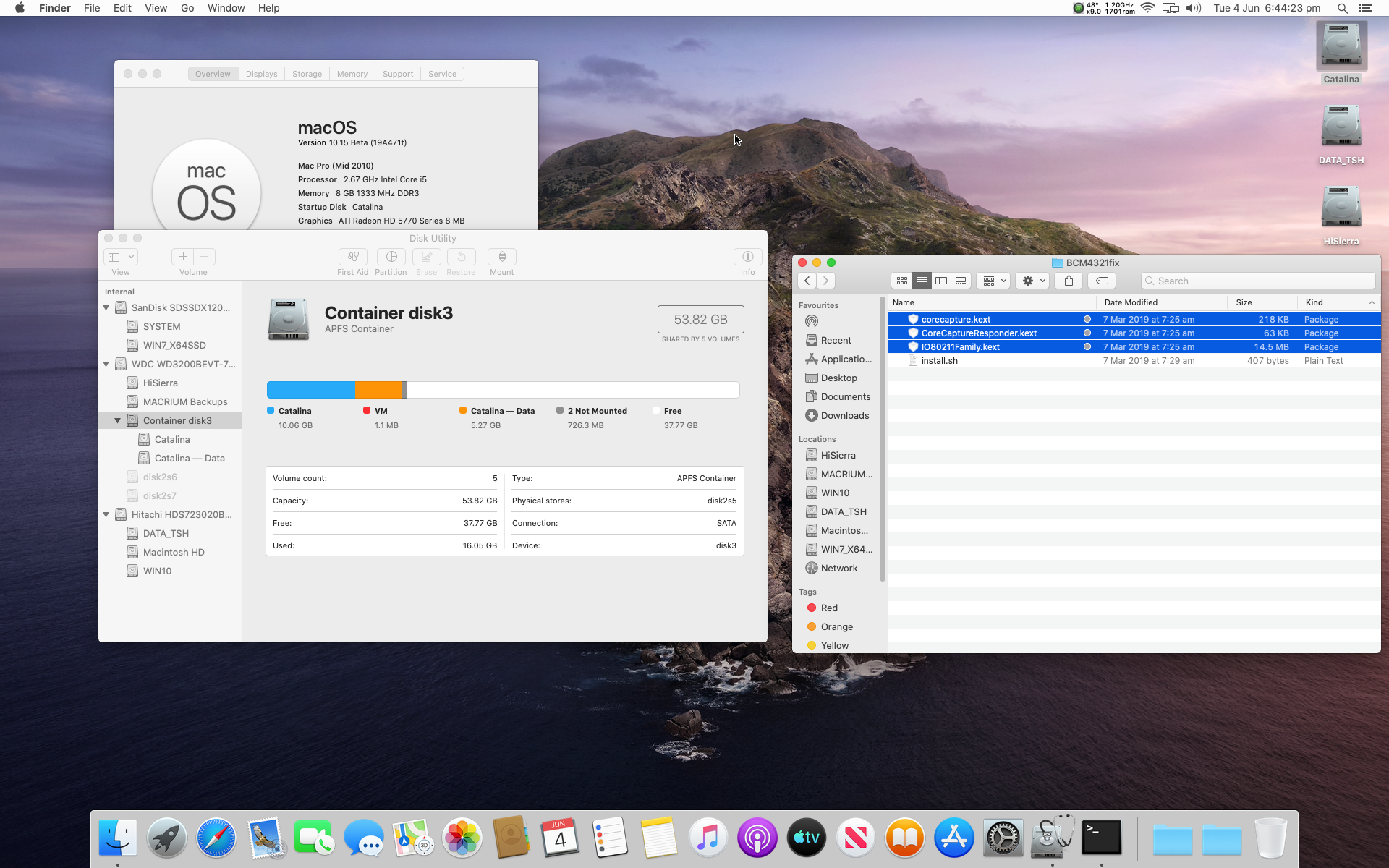

Successfully installed Catalina 10.15.0 beta_19A471t on my Skylake NUC6i5SYH (Desktop 1 in my signature)...
Spoiler
804488529_Catalina10_15.0beta_19A471tonNUC6i5SYH.thumb.png.408ff31b068a9af40ed9cb2149cdaf1a.png
Make sure to update Clover to r4940 and latest Lilu + Plugin kexts.
I cloned the system using Disk Utility and was able to boot the cloned disk on my Gigabyte P55a UD3 (Desktop 2 with unsupported non metal ATI HD 5770 graphics).  Unsupported MacPro5,1 SMBIOS still works with boot flags -no_compat_check and -nehalem_error_disable...
Spoiler
1203888508_Catalina10_15.0beta_19A471tonGA-P55AUD3.thumb.png.2a58bebe150b448619bd86882d10a65c.png
Some Observations on my old Wifi Cards
Unfortunately, the Wireless Networking Utility for my ASUS N10 USB wifi no longer works in 10.15, even though the associated RTL8192.kext loads OK (had worked previously from 10.6 to 10.14).  Anyone with a USB wifi dongle working in 10.15?
I also needed to replace IO80211Family, corecapture and CoreCaptureResponder kexts to get my Atheros 9287/TL-WN881ND Wifi card to work - unlike in Mojave, adding just AirPortAtheros40.kext from 10.13.6 was not enough.

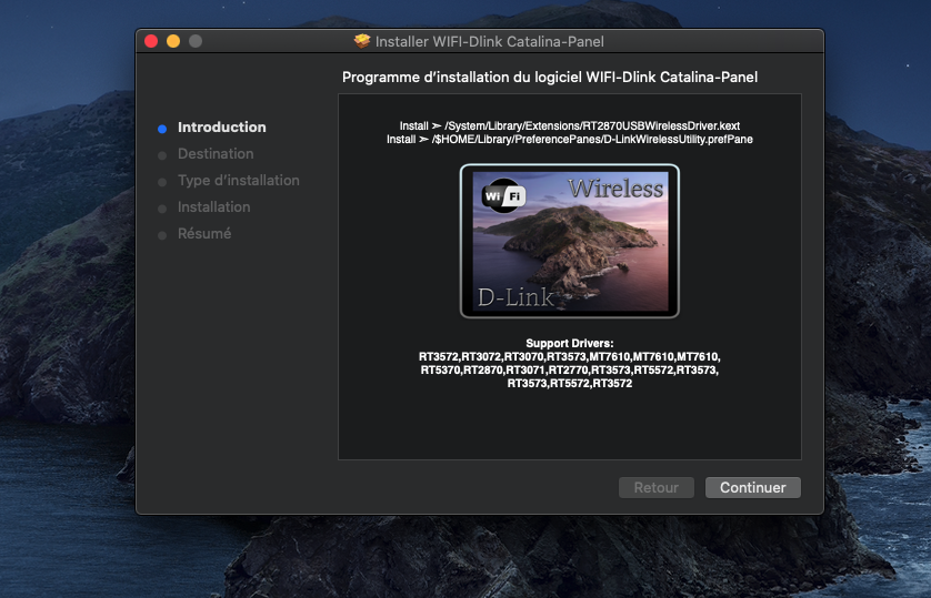

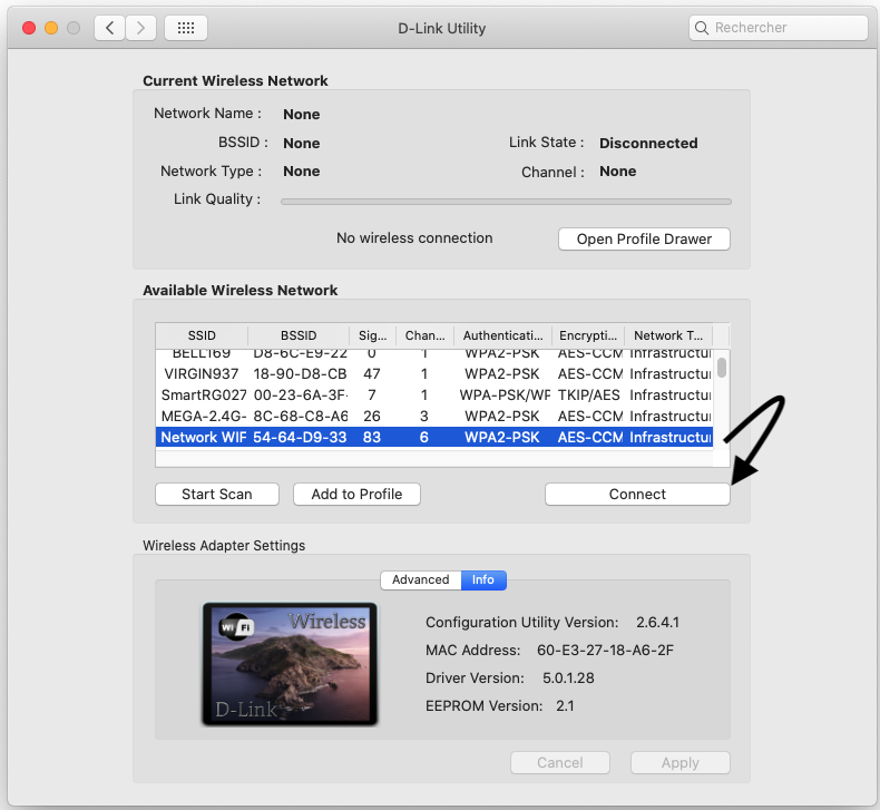

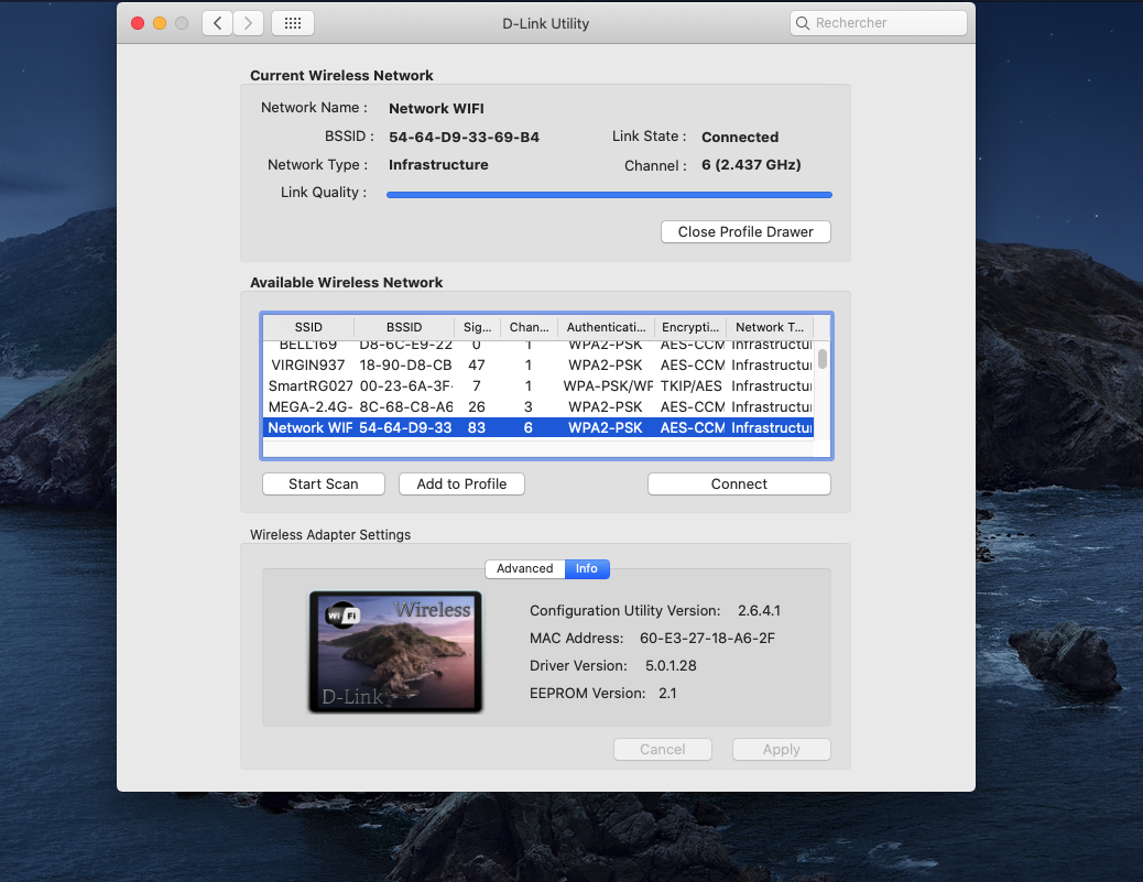

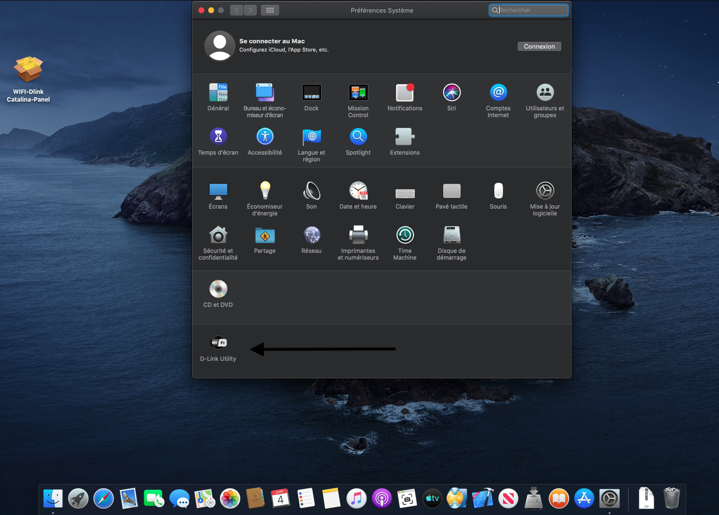

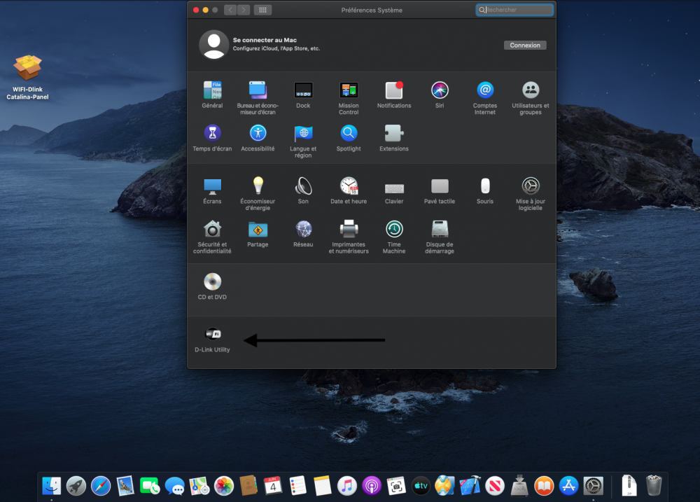

Here my FIX for WIFI RT2870USBWirelessDriver.kext
I am use TP Link Archer T2UH
View Spoiler
Spoiler
1478854850_Capturedcranle2019-06-0407_22_42.thumb.png.de79686de2823fb488843cded889966a.png
1759294746_Capturedcranle2019-06-0407_24_58.thumb.png.04e59272a7268fe23f1ce5c191b9cd4f.png
support Drivers:
RT3572,RT3072,RT3070,RT3573,MT7610,MT7610,MT7610,
RT5370,RT2870,RT3071,RT2770,RT3573,RT5572,RT3573,
RT3573,RT5572,RT3572
WIFI-Dlink Catalina-Panel.zip
Edited by chris1111
