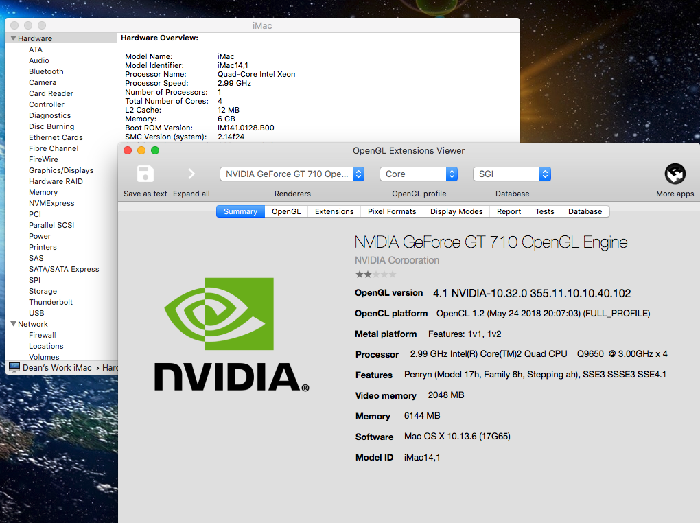

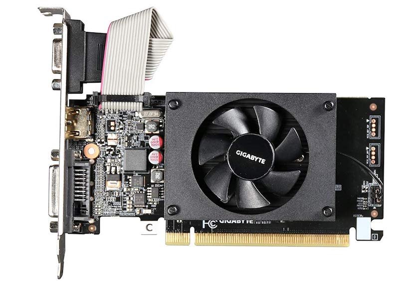

I have the Gygabyte GeForce GT 710
No web Drivers Your only have setup Inject Nvidia =False
No audio HDMI I dont care Iam not using HDMI Audio
I see your picture METAL is not support ?
Edited by chris1111
  • Thanks 1
OK thanks

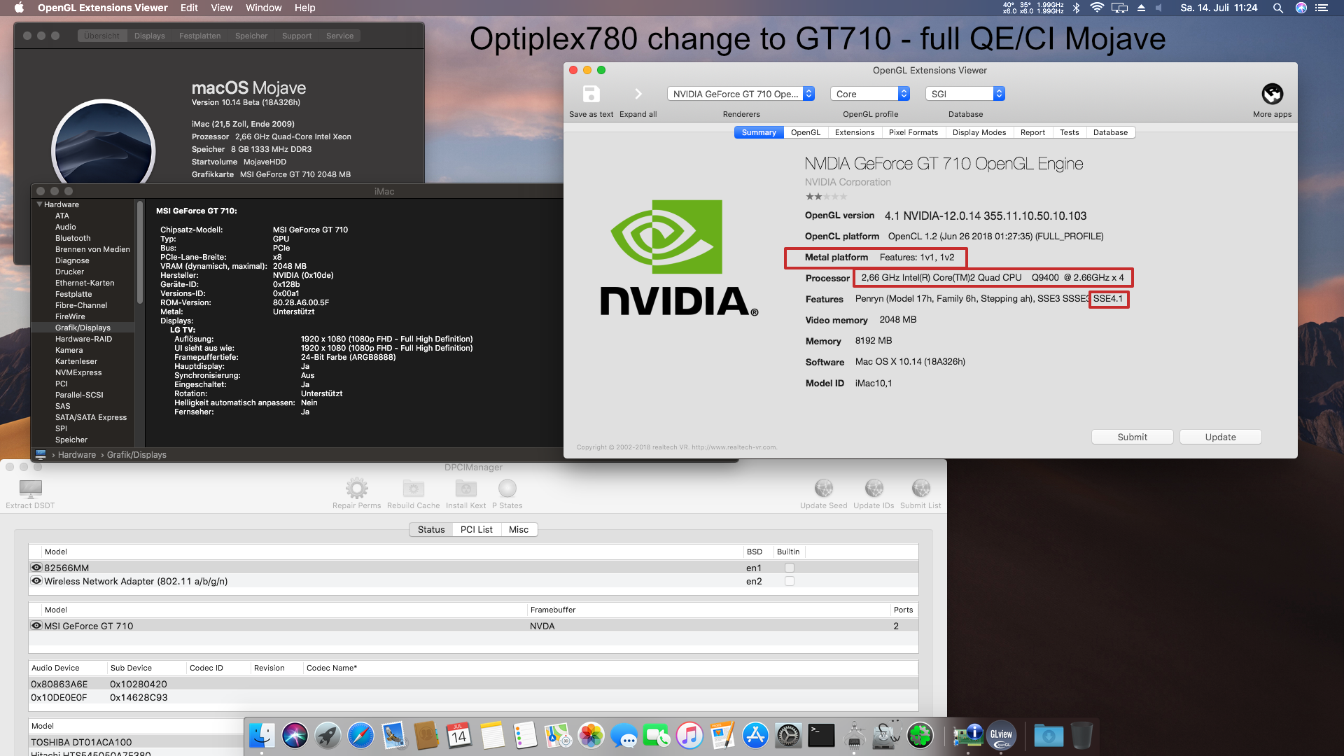

The GT710 works in Mojave with and without Inject Nvidia. Both tried and both goes.
HDMI Audio I test later.
Metal is supported.
Metal: "Unterstützt" = supported (Features: 1v1 and 1v2)

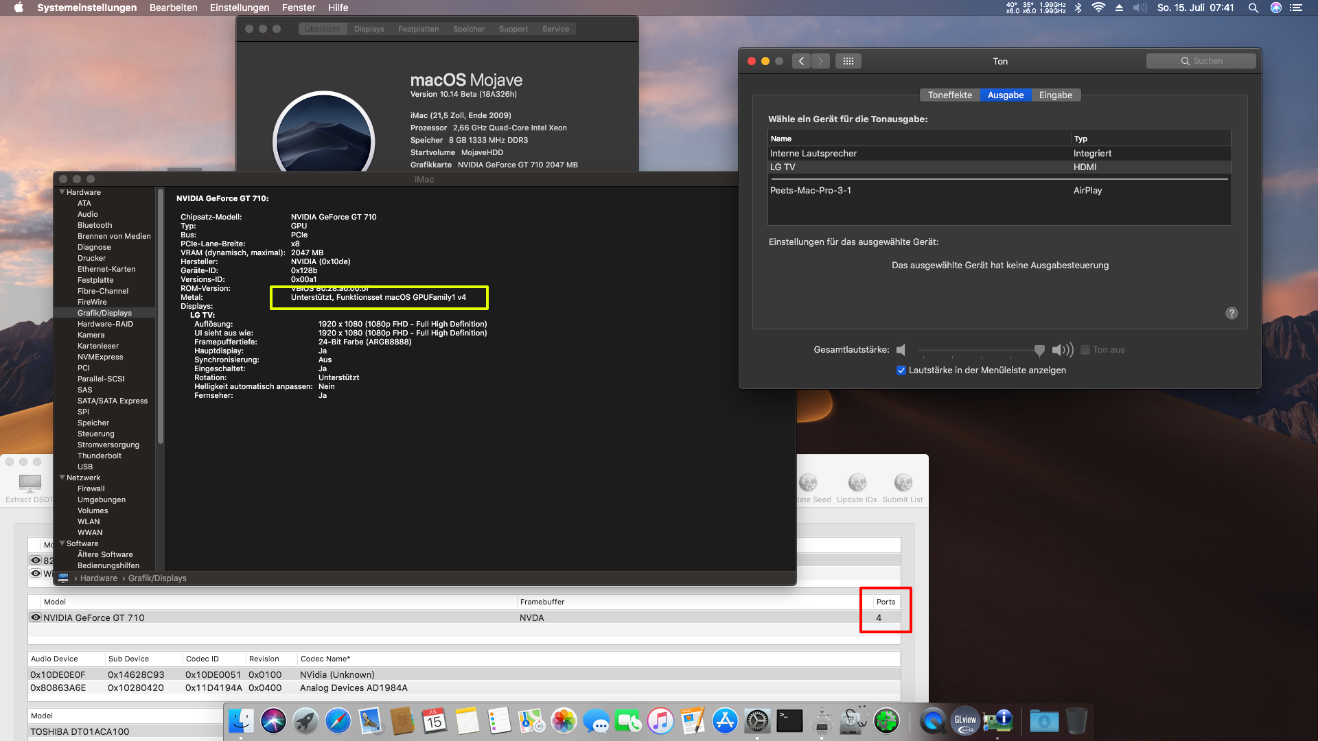

news from my Optiplex780 :wub: with the gt710 (Mojave)
Onboard audio works again with rollback AppleHDA 10.13.3 (AudioCodec Optiplex780 in AppleALC has broken since 10.13.4)
HDMI Audio with the gt710 now works with HDMIAudio.kext in Clover /other
Edit:
@chris1111
sorry, the first test was still with InjectNvidia=true
now with InjectNvidia=false I have 4 ports and Metal
now everything is perfect with graphics and audio
sorry and thanks :thumbsup_anim:
Edit2:
amazing, the GT710 works in the Optiplex780 with 10.13.6 also native, despite missing Injector iGPU. Also no WhateverGreen needed.
Edited by MacPeet
