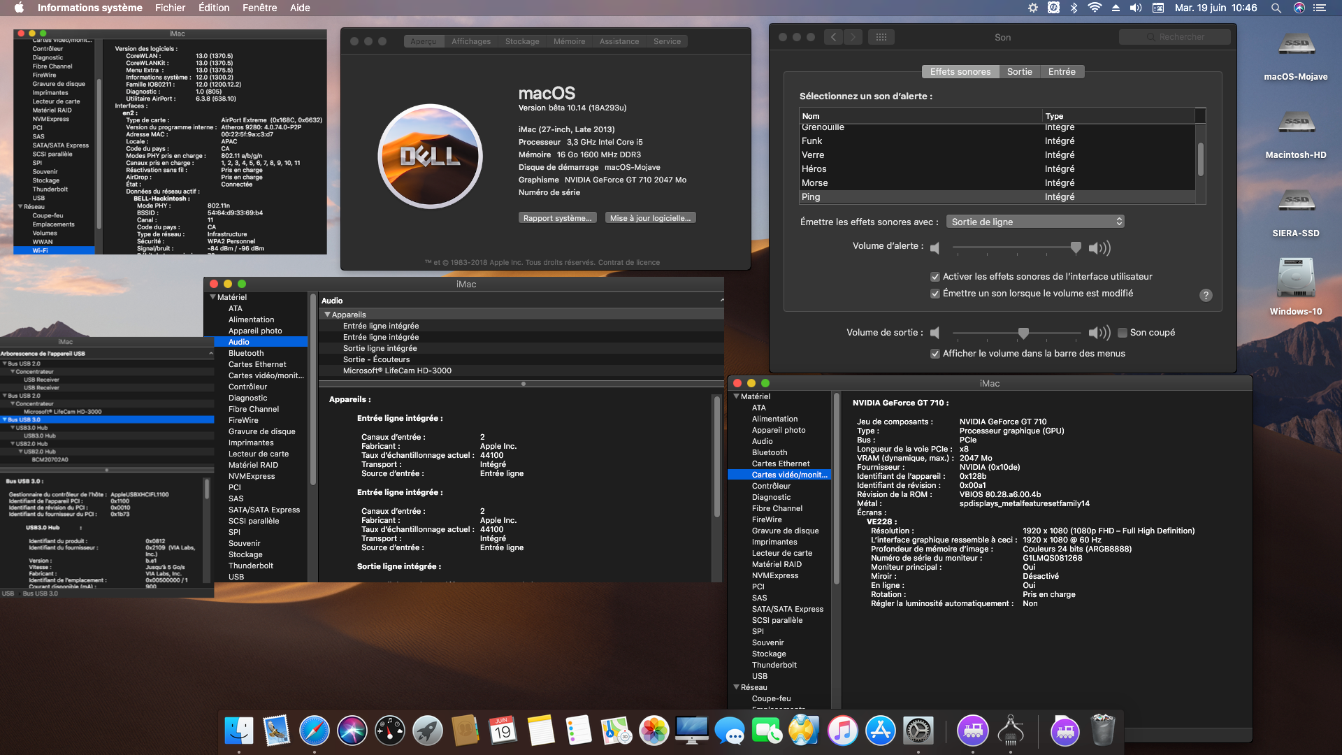

On ‎6‎/‎19‎/‎2018 at 4:59 PM, chris1111 said:
Hi MacPeet needs new topic for macOS Mojave 10.14 :lol:
For couple of days macOS Mojave is installed on my Main DELL Optiplex 790
everything's work like High Sierra :wink_anim:
Audio AppleALC
Graphics Geforce GT 710
Wifi Atheros 5B193
USB 3.0
Network Intel 82579LM PCI Express Gigabit Ethernet :IntelMausi
