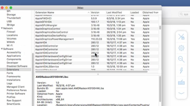

Audio is activated in the BIOS ???
DSDT.aml is in EFI/Clover/ACPI/patched/ ???
Check System Information Extensions in Utilities:
Let KextUtility run again for cache rebuild
BIOS? I can't understand why it wouldn't be, but, I'll have to check that later as I'm not physically close to the machine now.
I checked System Information and found AppleHDA listed and there is a "No" in the Loaded? column.
AppleHDAController was also listed -- 3 times.... and also with "No" in the "Loaded?" column.
Yes - DSDT.aml is in EFI/Clover/ACPI/patched/
KextUtility is busy repairing permissions and rebuilding cache......
kextstat now shows AppleHDA!!!!!!

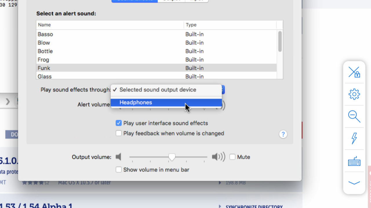

I now have an audio output option!!!!
Thank you!! Thank you!! Thank you!! Thank you!! Thank you!! Thank you!! Thank you!! Thank you!! Thank you!! Thank you!! Thank you!!

LayoutID 13 is configured in Auto-SwitchMode
Green at the back is LineOut (configured as internal speaker)
Front-out is headphones
If headphones are not plugged in, then LineOut back is active.
Have fun with the audio.

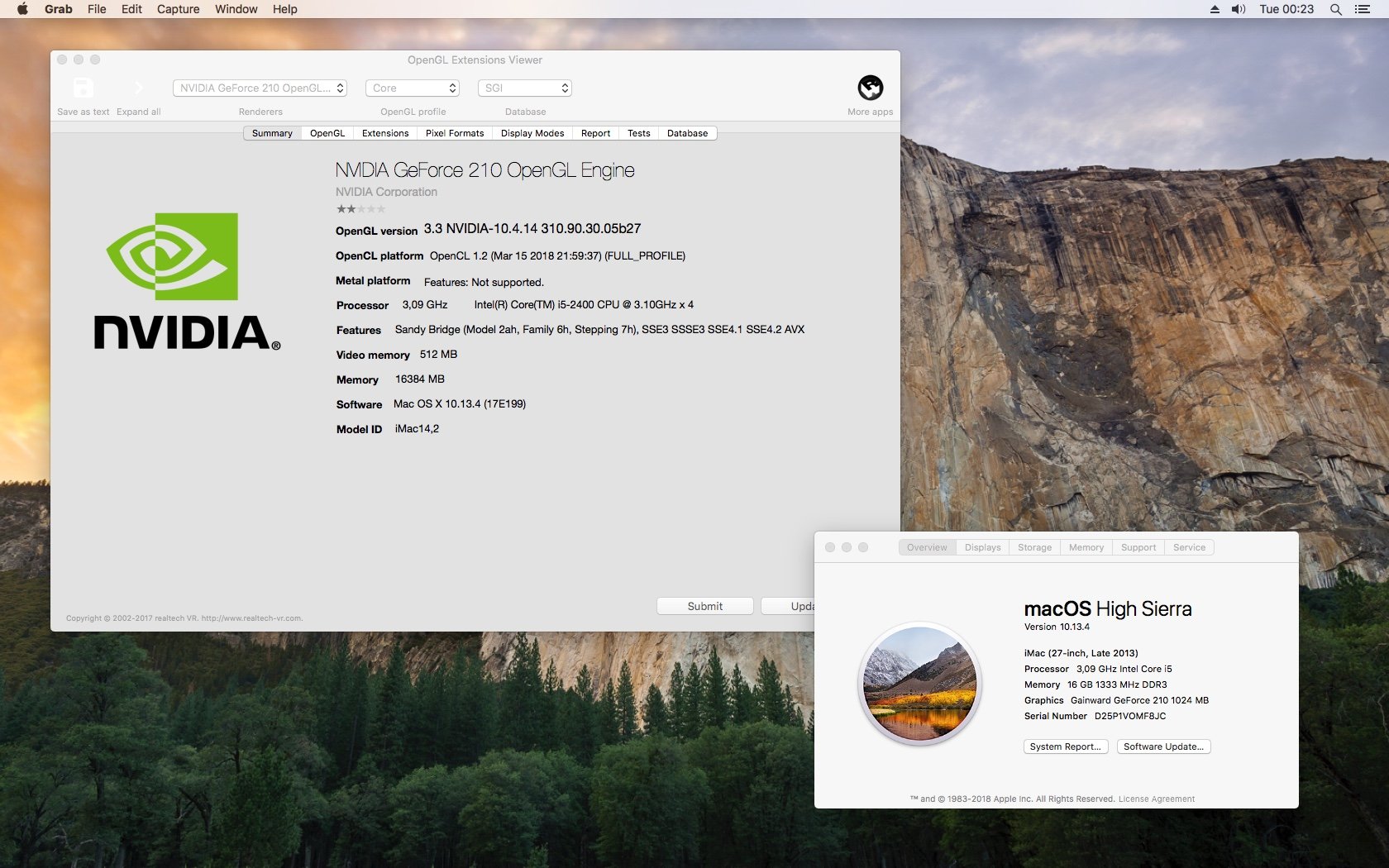

I got a free mobo from old Dell 790 SFF (bios A21). I added i5 2400, 4x4gb RAM and old PCI-e GT210 512mb and SSD. The installer starts, but the computer restarts after about 70% of the installation process. I have read this thread and unfortunately it looks like I can't prepare the HS (17E202) stick correctly. Will anyone share contents of EFI folder? Can I ask for preparation for GT210 gpu?
Please help, this is my first hakintosh.
2 minutes ago, sebar25 said:
This is my first post in this forum so ... hello!
i don't think Geforce GT 210 is support in HS
but I am not sure
