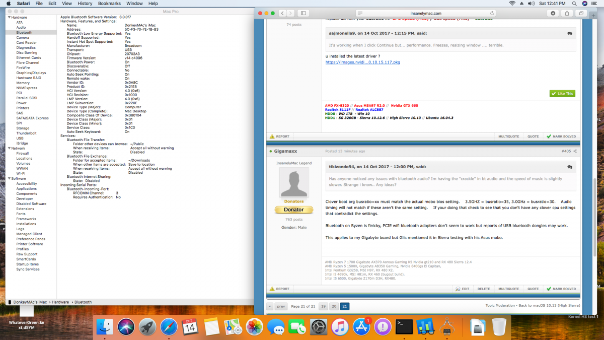

Has anyone noticed any issues with bluetooth audio? Im having the "crackle" in bt audio and the speed of music is slightly slower. Strange i know.. Any ideas?

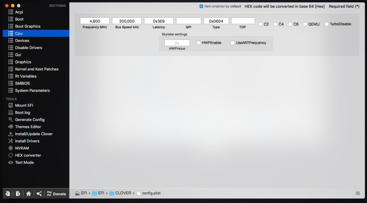

as you have overclocked cpu try adding "busratio=xx" flag
replace xx with your busratio i.e  CPU speed (Mhz) / Bus speed (Mhz) = busratio
Clover boot arg busratio=xx must match the actual mobo bios setting.    3.5GHZ = busratio=35, 3.0GHz = busratio=30.    Audio timing will not match if these aren't the same setting.    If your doing that check to see that you don't have any clover cpu settings that contradict the settings.
This applies to my Gigabyte board but Gils mentioned it in Sierra testing of Audio with his Asus mobo.
Bluetooth on Ryzen is finicky, PCIE wifi bluetooth adapters don't seem to work but reports of USB bluetooth dongles may work.
Update:   Got my IOGear USB bluetooth dongle working.    It must be the USB fixes.

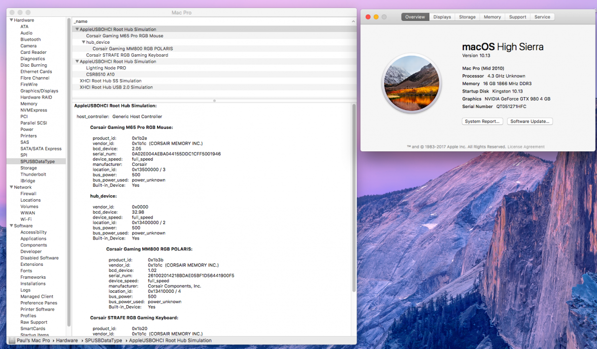

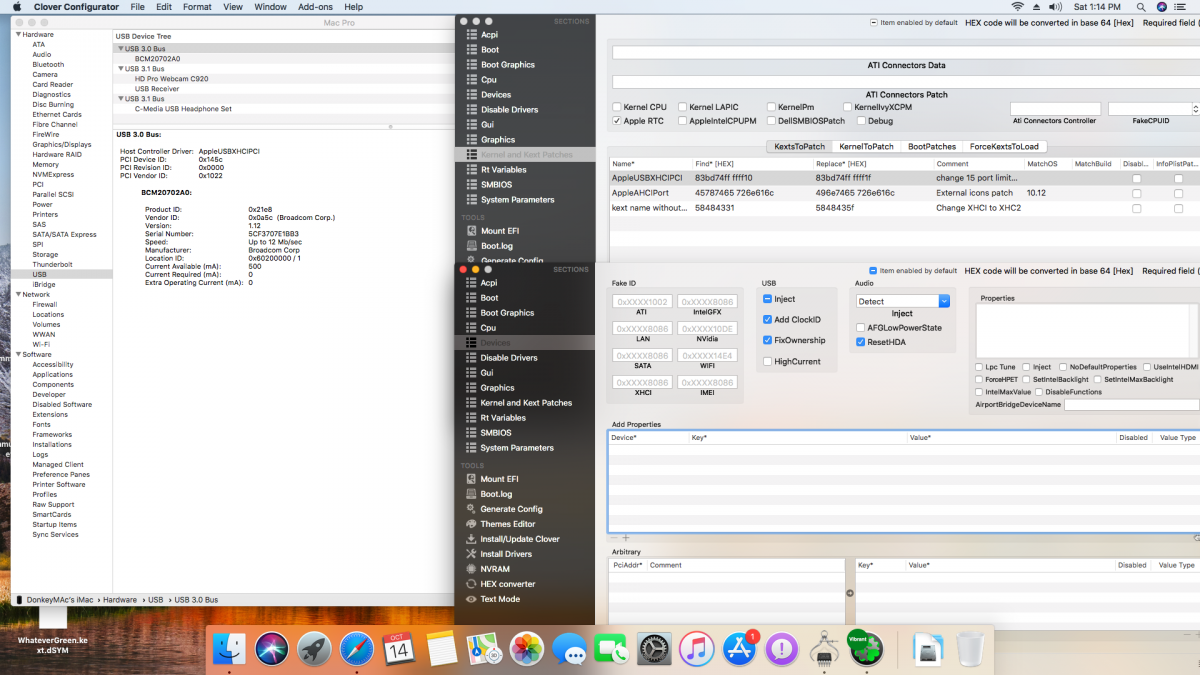

My USB clover settings.    The external icons patch is for Sierra I have the correct one on another drive, they are all yellow but they show.
I'm using kext to patch for raising the port limits.     Clover settings shown you can also try High Current for USB 3.1 but it might burn out a USB 3.0 port if its assigned there.     I removed all USB fixes from clover and there are none in S/L/Extensions or Library folder.
There is no USB 2.0 working on my Front Case panel, but the rear 2.0 works.    The front panel is the internal board connector like the Pcie Bluetooth adapter.   It may be that these aren't recognized in the OS or not ported properly.    I've been looking into the USBInjectAllkext method but it seems Intel compatible only.    Maybe someone can look into it and give it a try.

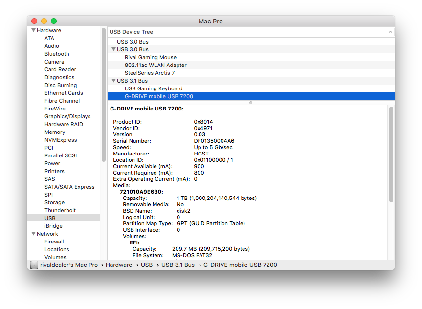

Thank you @bronya @gigamax and the other members for the help. testing hs in my ryzen 1700 @ 3.8ghz whit b350 mortar. no usb fixes or kexts all usb is working oob. for 660 ti use the lilu +NvidiaGraphicsFixup.kext without the inject Nvidia in clover and the hdmi audio works. ethernet works. shutdown. restart works. I don't test the sleep yet. and the integrated audio its not working. I know whit voodoohda he works but I use the audio of the 660 ti. sorry for the bad English.

Ahhh you're so lucky, my USB 3.1 and 3.0 doesn't work properly...same chipset too B350  :blush:

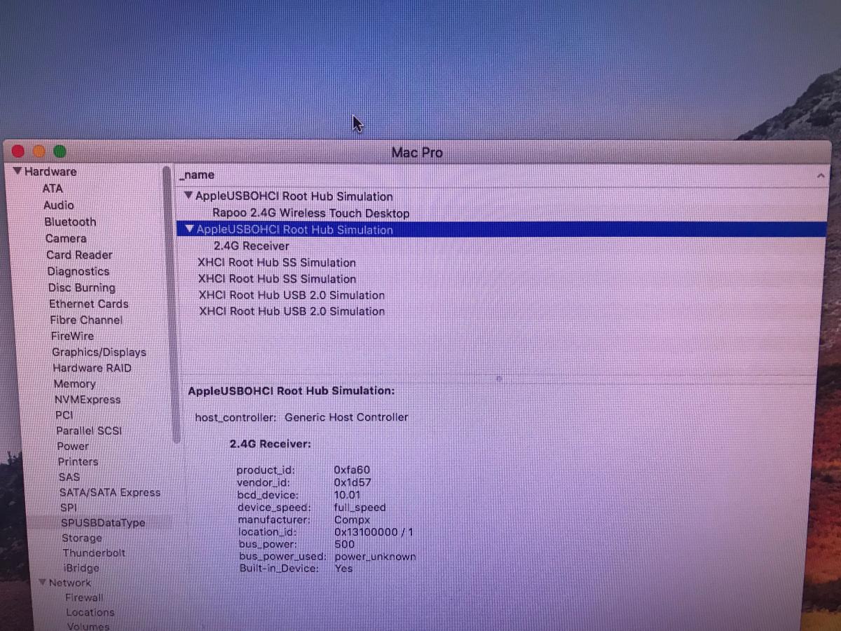

Dummy kext made all of my USB2 ports work by routing them to USB3.

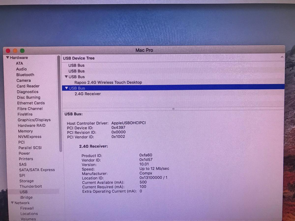

Mine doesn't state "USB" in system report. But my USB 2.0 ports seem to be working normally. Im only using genericUSBXHCI.kext in clover/kexts/other. Im also not using any kexts to patch methods.
Audio studder fixed. Clover CPU settings were jacked up. All works normal now. Thanks!
The only ones not working are the front case 2.0, and possibly motherboard header ports.   I have 6 USB 3.0 ports, 2 USB 3.1 type A, and 2 USB 2.0 ports working.    Theres a 3.1 typeC but I don't use it (thunderbolt support?).  Basically the whole rear panel works and the front USB 3.0 case ports.
Hmm.  This is what my USB tab looks like. All of my USB ports seem to be working though. I'm on the C6H.
