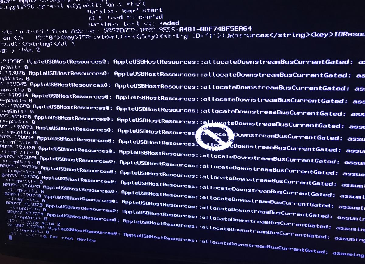

Hello Bronya,
i did all of your tips..

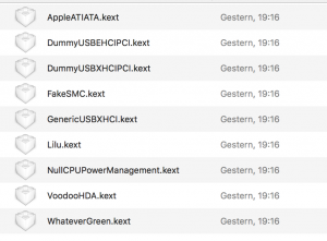

I added the AppleATIATA.kext in Clover
tryed following flags:
-v -f npci=0x2000
-v -f npci=0x3000
I followed the Video - everything...

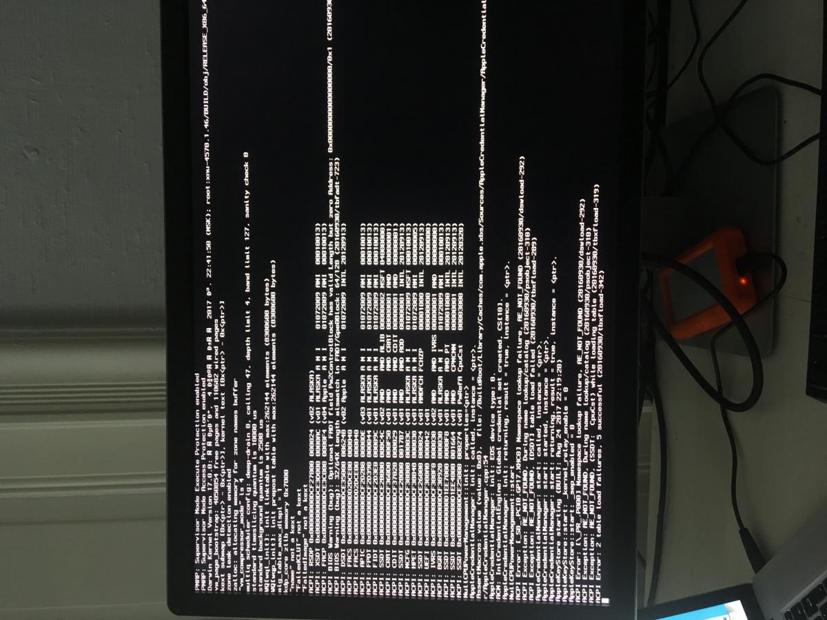

nothing changed.. its always APCI Error, AppleKeystore::start and Whatevergreen failed to load, but most to,e ACPI HPET SSDT Error
i made all like the tutorial video
Update1: I can change the complete EFI with the one of Giga and its still the same error
Update2: I set bios to defaults (this helped me with 12.6) but same error
Update3: I flashed and updated BIOS from my MSI Board - same error ending with FakeSmcKeyStore: started
Update4: I currently downloading High Sierra new and will make all steps again.. Same Error. Acpi Error
Update5: I installed an other Graphic Card - Same Error.
Update6: I deinstalled all kext only used fakesmc and nullcpu.. same..
Update7: When i use OsxAptioFix2Drv i got kernel cache error loading
UPDATE8: I GOT TO INSTALLER ... with my old plist. config from 10.12.6 (will figure out whats goin on)
UPDATE9: Install goes flawlessly perfect - but boot from Installed HDD doesnt work (kernel cache error) (i'll try to boot with the usb stick in mac hdd)
UPDATE10: Vega makes the WOOSH Sound at beginning of language,keyboard.. but ethernet brought to reboot... again booting with usb stick and clicked on "no ethernet for now" ... now it goes further.. stay tuned

I added EFI from USB Stick to Main HDD (now its booting)
I now have to add whatevergreen, lilu and usb kexts to S/L/E or? And what Kext i have to use?
I think following list:
DummyUSBEHCIPCI
DummyUSBXHCIPCI
GenericUSBXHCI
Lilu.kext
Lilu sys
Whatever.kext
Whatever sys
EthernetIntel (will search this)
i will have to add all these to S/L/E or? and repair rights after?
what is with cpunullpower, vodoohda and fakesmc?

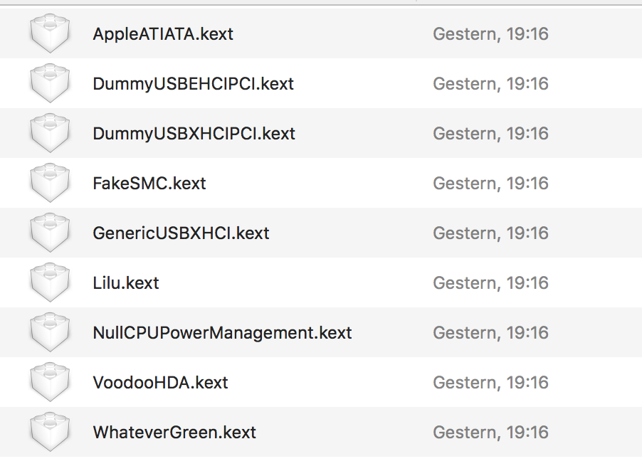

My Kext in S/L/E
FakeSMC
NullCPUPowerManagement
Whatevergreen.kext and dSYM (will try to delete this because of vega)
LiluKext and dSYM
IOGraphicsFamily
IONDRVSupport
AppleBacklightExpert
IOPCOFamily
AudioAUUC
apfs.kext
FakePCIID
FakePCIID_Intel_Gbx
AppleIGB

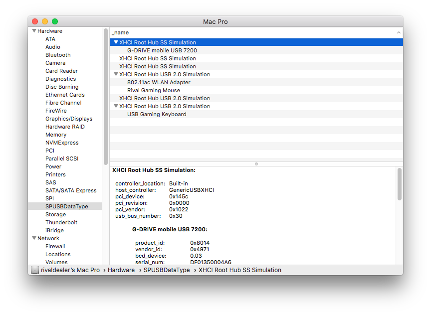

@Bronya amazing work!
The only thing that's not working is USB 3.1 or USB 3.0 (relegates to 2.0)
It's also worth noting that if you format your hard drive to APFS, you will not lose your EFI partition from Sierra.
So no need to re-install Clover when you finish installing, just move your kexts from 10.12 to Other.
Edit: Also, full support for my M.2 SSD EVO 960 without the need for kext patches, but thank you @Pike R. Alpha for the patches so we could use them in Sierra!
Would anyone be willing to upload the vanilla SPUSBReporter.spreporter for me? It's located in /System/Library/SystemProfiler/
Insert pendrive on any usb port then remove it and plug it another usb port and it will detect the pendrive

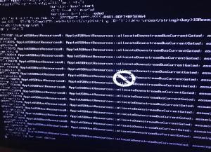

Excellent tutorial, thank you so much for your work! One thing, its looks like you have a typo in "GUIDE.rtf". "YOUR-USB/.IABootFile/" should be "YOUR-USB/.IABootFiles/".
Also I'm stuck at forbidden sign after "Still waiting for root device " when booting the installer.

1st try shutting down the pc completely and then try again.
2nd if that didnt work then try hot swapping the pendrive .
insert pendrive on a usb 2.0 port and as soon as you see ++++++++++++++++++++++ message swap it to usb 3.0 port
3rd if that didnt work too then try the below attached prelinkedkernels one by one
and thanks for spotting the mistake . i will fix it : )

Using a USB 3.1 port for the pendrive helped, thanks. I successfully installed High Sierra, the only problem is USB ports behave strangly.
USB 3.1 ports doesn't work at all. USB 2.0 ports successfully determine mouse and keyboard but cannot determine any type external storages (flash, HDD, etc).

The usb 3.0 ports work but needs more than one trail
Eg: insert pendrive on usb 3.0 port then remove it and plug it again on another usb 3.0 port. And it gets detected
