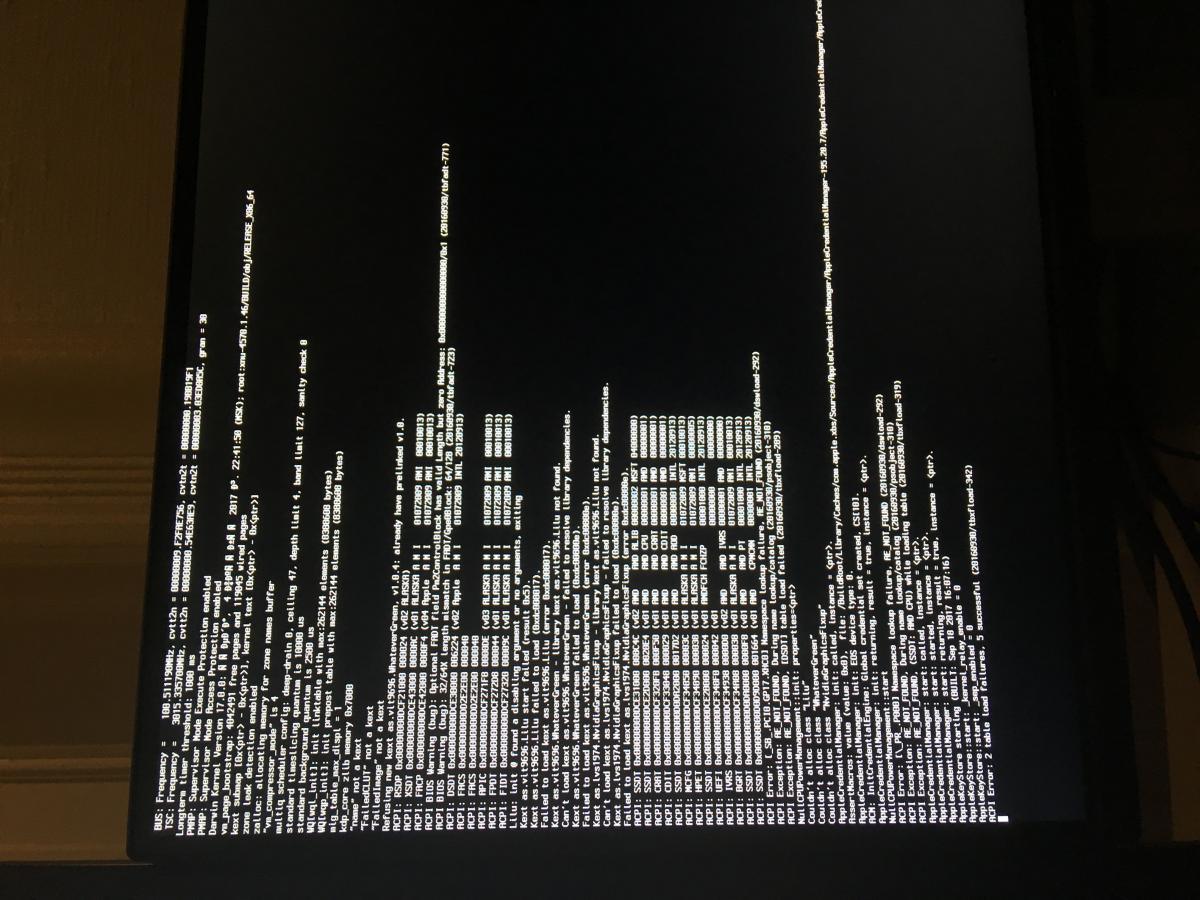

Update: Kernel Cache again... wtf.. why?
Edit 2: Done it all again - kernel cache error again
I think its your kernel bronya (the ryzen one)
On page 12 i posted photos of the error
This  #239 ??
I no see kernel cache error ... Where ??

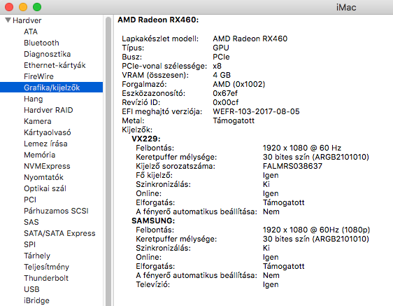

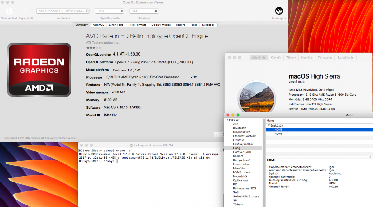

macOS High Sierra works with Gigabyte RX 460 4 GB without auxiliary card! (Lilu.kext and WhateverGreen.kext)
Works with HDMI port and Displayport too! (I guess thanks to AppleALC.kext) HDMIAudio.kext
Testing in progress!
Geekbench CPU Result (That could be better): https://browser.geekbench.com/v4/cpu/4410138
Geekbench GPU Result: https://browser.geekbench.com/v4/compute/1233664

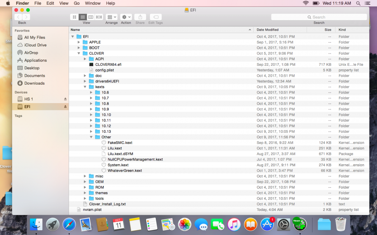

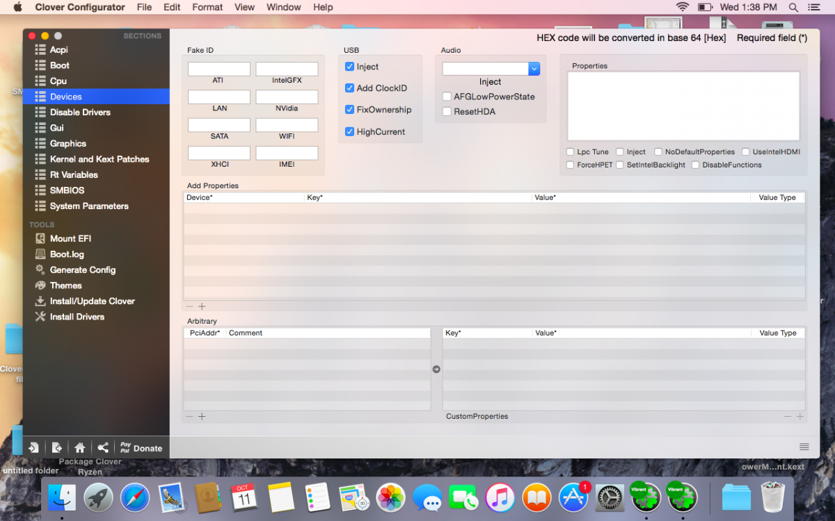

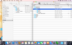

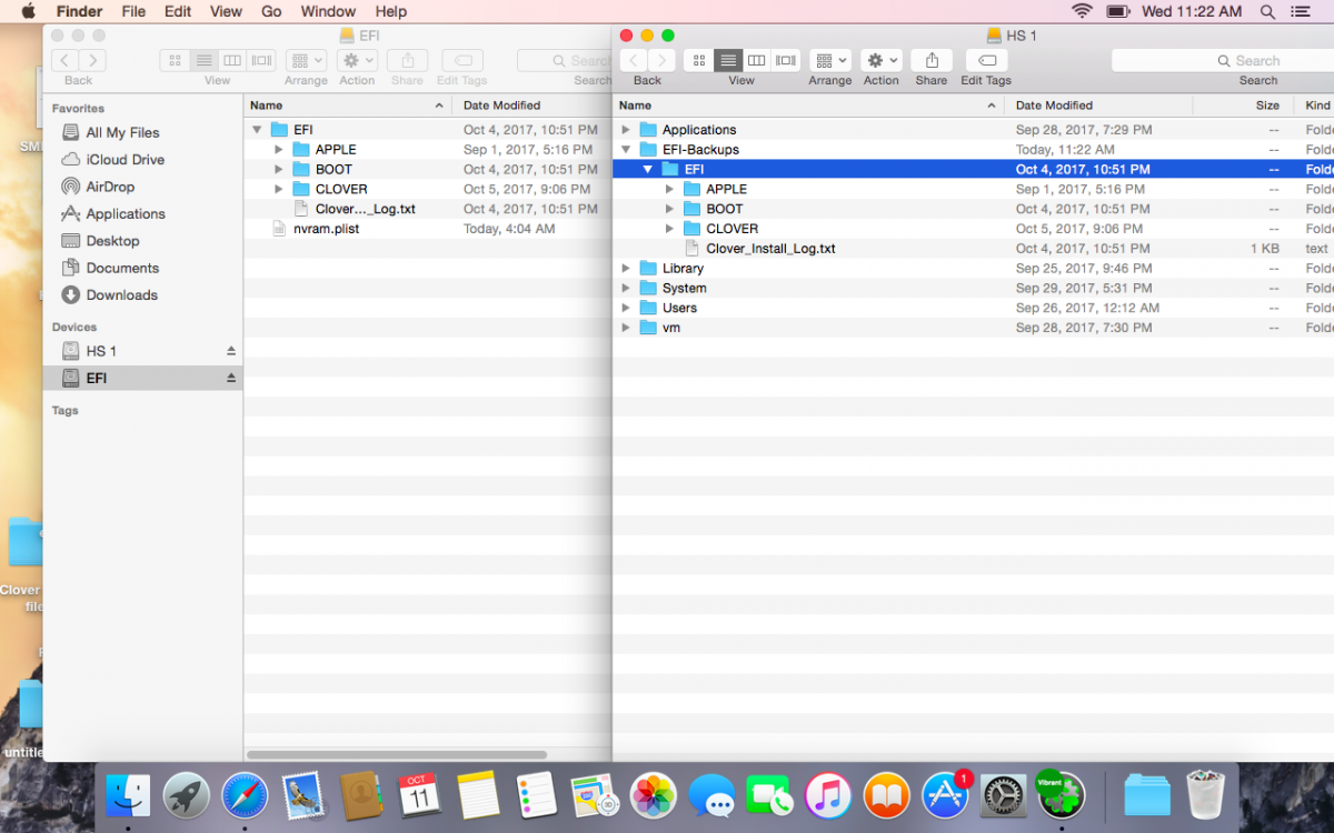

For those having trouble check to see if you have a EFI Backup folder on main partition and remove it.   If it has a different config.plist or other kexts they may create problems for booting.
For placement of the recommended USB and other kexts they go in your EFI partition in Clover Kexts folder Other.    There are also Clover settings for USB that may help.    I'm using High Current for USB 3.1.
post-1753549-0-45961900-1507746450_thumb.pngpost-1753549-0-14071300-1507754515_thumb.png
As you can see I'm not using any USB fixes for my Motherboard Gigabyte AX370 as my setup is not requiring it.   I have USB 3.0 and 3.1 listed in about this Mac, and they al work except my case USB2.0 slots.  If you have the USB fix kexts in Other folder try removing them and see if you get past the USB error.    For modern Ryzen boards they may not be required in High Sierra.   In sierra I use them.

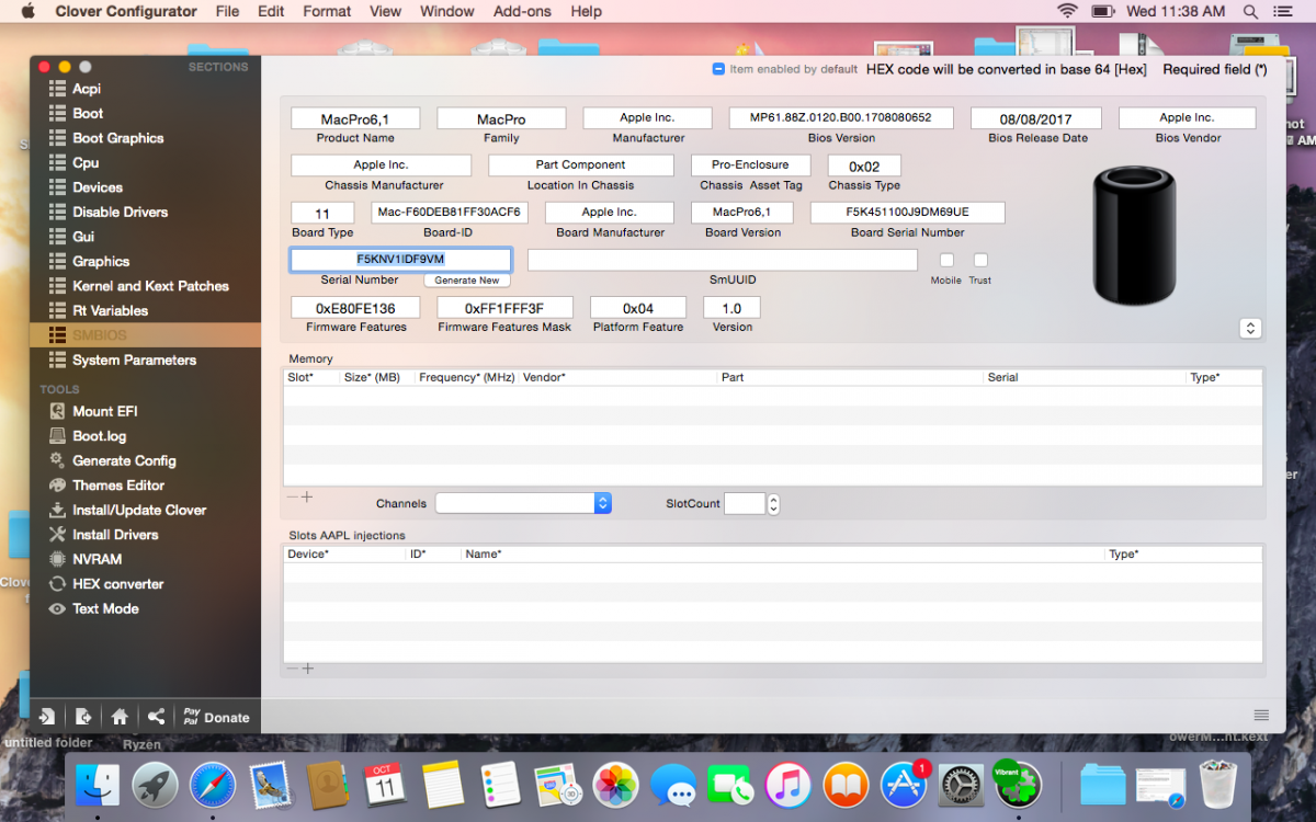

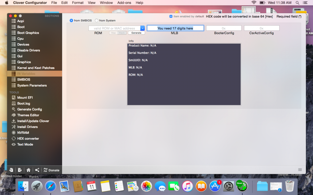

If your getting the error that your system is incompatible or can't be installed on this system check your clover MLB number.    It needs to be 17 digits long for Mac Pro 6.1 definition.    An easy fix for this is to take your serial number and paste it there and then add more letters or numbers to reach 17 total.
post-1753549-0-47085600-1507747483_thumb.pngpost-1753549-0-82550500-1507747518_thumb.png

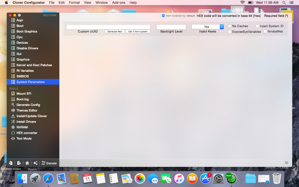

Also, in order for your Kexts to inject you should set inject kexts in Clover System preferences section. It also has the option to create a UUID number as well.
To use Clover Configurator open it and select "Mount EFi" choose the disk you want ton open and hit tab.   Close Configurator and look on desktop for the EFi folder or disk symbol open it and open Clover folder and right click on config.plist and select open with Clover Configurator.    you can make all these changes and then save at close.
