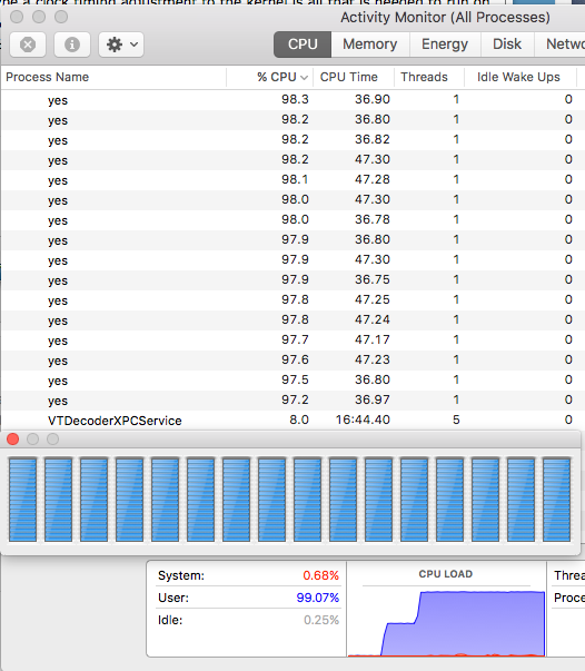

I'm curious to see what kind of FPS you're able to attain in a game that isn't benchmark software, such as League of Legends for example.
I'm also curious to see if you get a kernel panic, when you run 16 threads of
yes > /dev/null &
with your most stable clock that is above 4.0Ghz reported.
Typically when I'm overclocking, I use Cinebench 15 to test if it crashes, if so it's unstable, if not then I run the generic yes test as well.
After you run the 16 threads, you can stop them by using
killall yes
yes > /dev/null &
killall yes
I tried that last night a couple of times and got a flat summit as shown during the GPU test and a high peak during the CPU test. CPU % was 86% idle for most of the run. It doesn’t seem to be stressing the CPU during the test according to Activity monitor readings.
P.S. is that a different version of activity monitor, I’m not getting the blue load bars at the bottom of window?
This is exactly what I expecting but it is not happening, 7.0 GHZ and it’s not crashing?
In the menu bar of Activity Monitor:
Window->CPU Usage
Personal preference, but if you'd like you can also use the faster update option:
View->Update Frequency->Very Often(1 sec)
