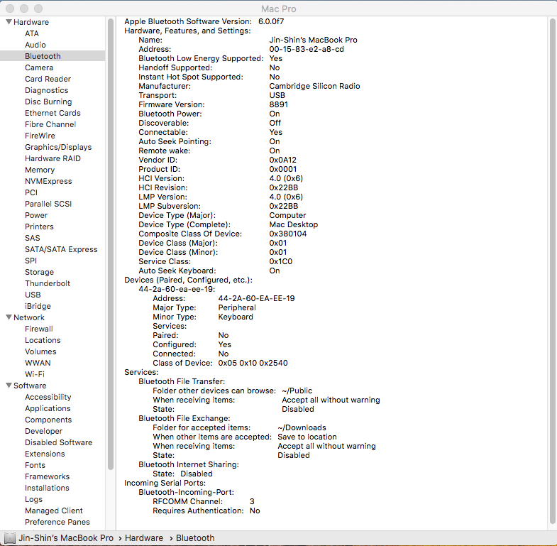

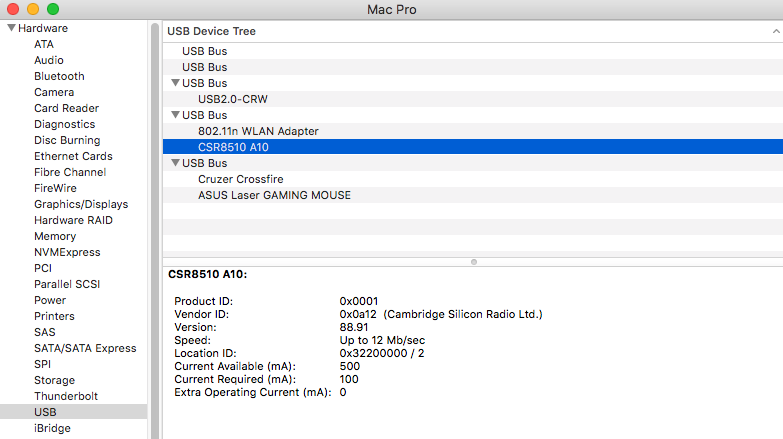

Has anyone managed to make usb bluethooth adaptor work on 10.3???Anyone
Mine is it’s an IOGear USB Bluetooth. First I got all my USB ports working except front case 2.0 ports. I deleted all the USB kexts in clover and a few settings. See the post above I posted config.plist/clover settings.

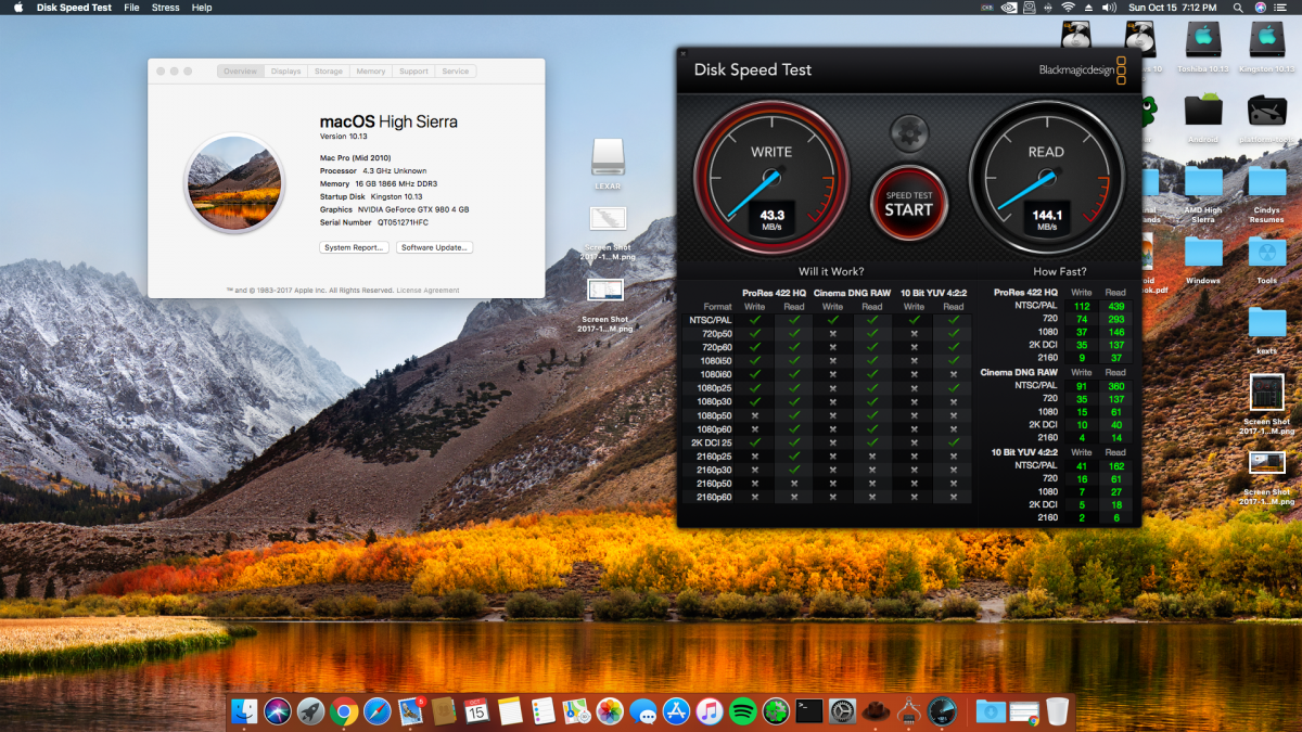

Finally got USB 3.0 working. Even my front ports are working now and system reporter is reading correctly also. As stated by Mfaustin previously. I replaced SPUSBReporter.spreporter in system/library/systemreporter and also replace CoreMediaIO.framework in System/library/frameworks. Rebuild cache/prelinked kernel and repair permissions and reboot. All seems to be working now :) Awesomeness!!

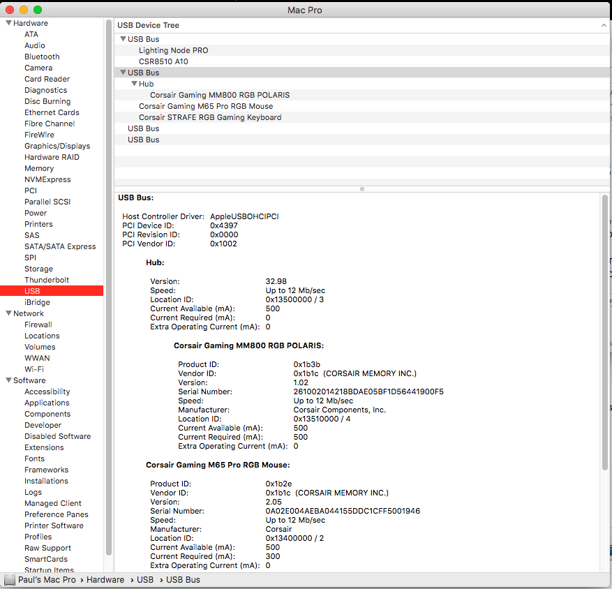

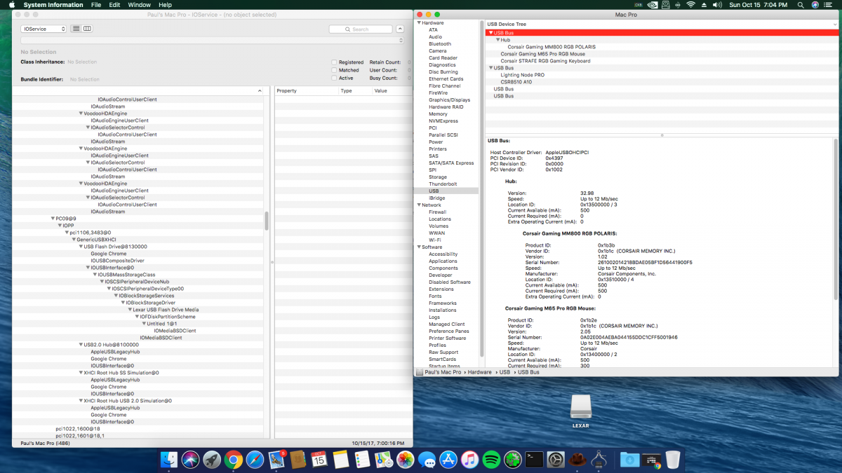

So I've reinstalled 3 times now and I'm still showing a blank "no information found" under USB in System Report.  I'm not using any dummy kext or patched CoreMediaIO/SPUSBReporter. All my USB connection are working although I need to run a few more tests to check speeds.  Not sure what I can do at this point. I'm running the C6H.
Unfortunately, you're not running at 3.0 speed. Notice the host controller AppleUSBOHCIPCI, which is USB 1.1.
I've got 3.0 speeds on my front ports. The drives just don't show up in system reporter for some reason. But they mount normal when plugged in.

Speed for 3.0 is 5Gbps, if you can confirm this with a compatible usb 3.0 device, that would be rather odd.

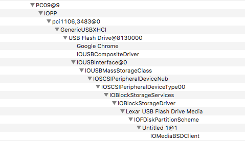

It seems to be using the genericusbxhci.kext extension but not reporting in system reporter.
These are the normal 3.0 speeds for this flash drive when running windows also.

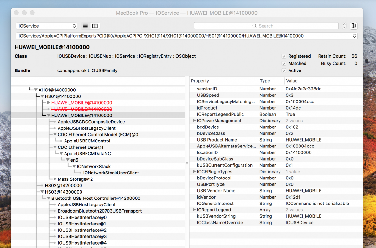

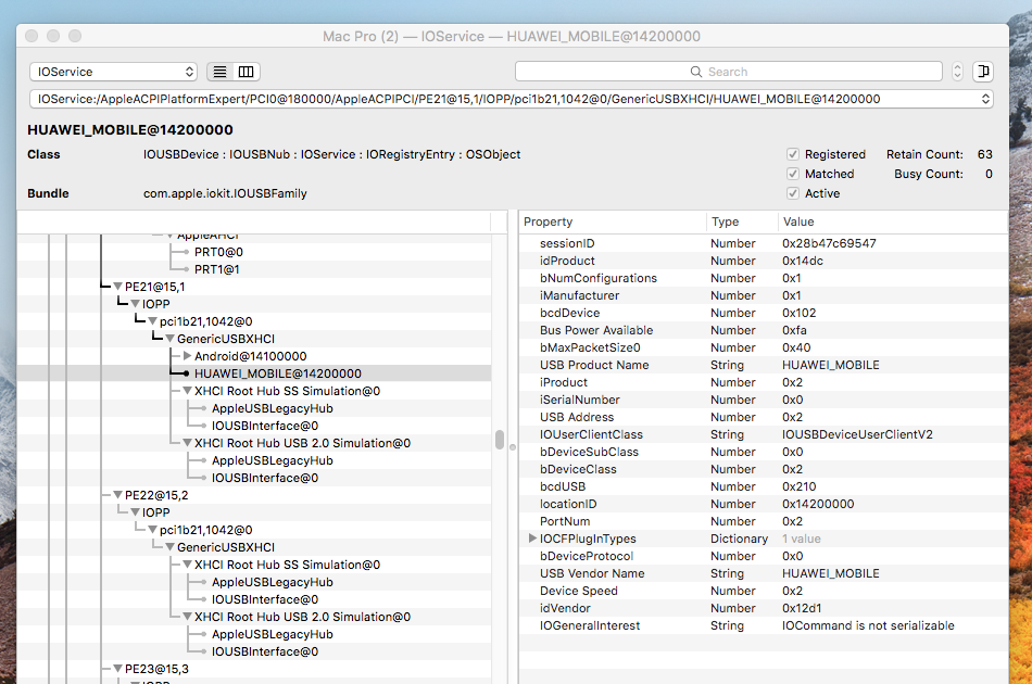

I just have a problem with USB CDC device. It works perfectly fine on original Mac but it doesn't work on hack. And I have no idea why it doesn't work. AppleUSBCDC and AppleUSBECM loads without errors. USB 3 port (GenericUSBXHCI) works with any other devices without any problem.

Looks like there is no error, warning or even any mention of AppleUSBCDC, AppleUSBECM. After i plug in USB CDC device I found only this messages that looks relevant:
