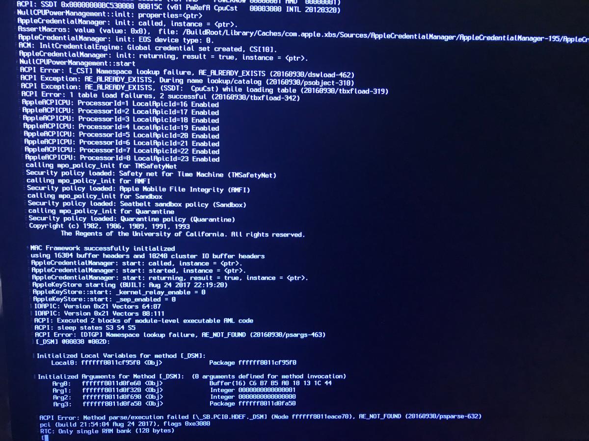

ok i made it... but have one problem on last step.. i install system copy all need files then boot now from my ssd and when kernel is loaded i see only message about IOGraphics x2 times and nothing... normally after that message i got login screen etc. but in this situation all just hang on -v mode... I put kext to clover but not all what  i need . so my question is can i mount efi form my high sierra usb installer on windows? to put extra kexts? without that i can't get in system. I put bootflag like nv_disable GraphicsEnabler=No but still not working. On installing i everything working perfect. I put only for graphics Lilu and NvidiaGraphicsFixUp. Nothing more. So what i need to enable my gaphics .
And it's another problem how to put that new kext to clover in usb? i must mount that efi partition but how? on windows / mac terminal (installer part). That's will be best answer for me how to mount USB EFI. On windows i try assign letter=X but ... won't work on removable device. on transmac i don't see EFI partition. Last chance i got on mac terminal but i don't know command to do that.
Edit: Ok i resolve that problem with mount efi etc... put more kext to clover but... still nothing installing system without problem then when i try boot form my ssd sierra still hang on IOConsoleUser :gIOscreenLockState.... this is last part to get GUI / nvidia working ... i even don't finish User Configuration Part ; / IDK i was thinking maybe it's kext problem but after put more kexts still nothing.. Any suggestions?  I don't know why my graphic won't start on Installed HDD. On usb and another installation process working perfect.
What is ur nvidia model?my nvidia tesla gpu 8500gt doesnt work using high sierra nvidia kexts,replace it with nvidia kexts found on sierra 10.12.6,,now i bypass the gioscreen lock error and reach the desktop

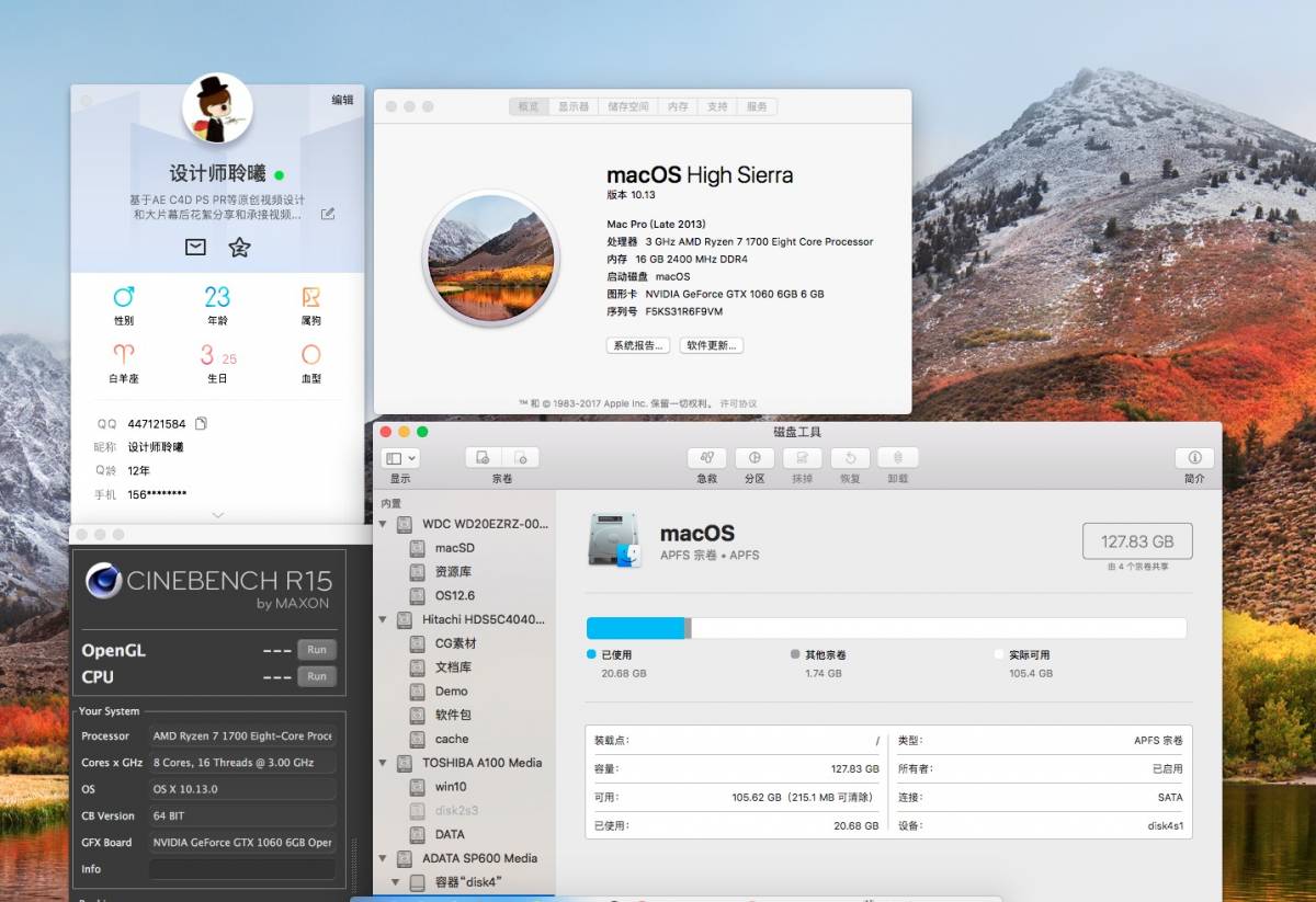

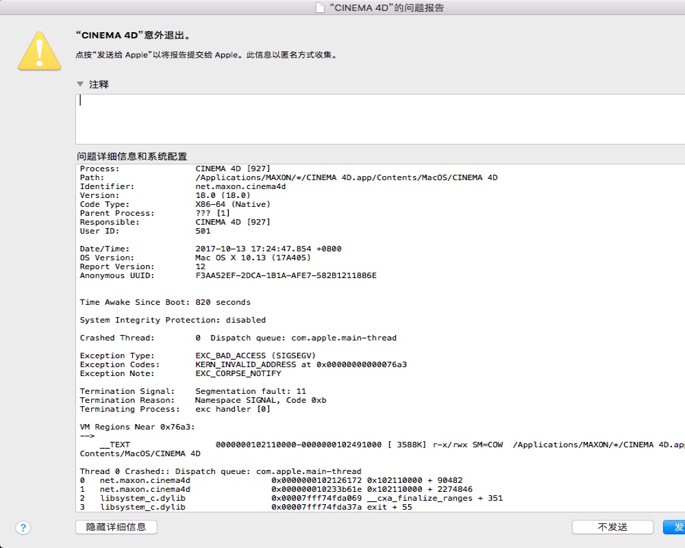

我用Intel笔记本安装10.13后,替换B的内核,重建缓存,然后把硬盘插在AMD尝试启动,结果成功了!所有USB都正常,但是使用软件CINEMA 4D的时候,R18版本闪退!R18 DEMO版本没问题!
After I installed 10.13 with Intel laptop, I replaced the B kernel, rebuilt the cache, and inserted the hard disk into the AMD to try to start. The result was successful! All USB is normal, but when using the software CINEMA 4D, the R18 version flashes back! There's no problem with R18 DEMO version!
But I test under 10.12.6, CINEMA 4D R18 can be opened, and I guess it can be repaired by kernel! Asking for help from Bronya and Shaneee!@Bronya @Shaneee
A lot of people from the Apple community forums are reporting issues with High Sierra performing/crashing on Professional grade applications. It might not be a kernel issue if it's happening to those on Intel machines. I can't confirm, but these are the rumors I've heard. Especially with the new APFS format, it's more likely issues will arise.

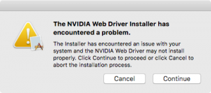

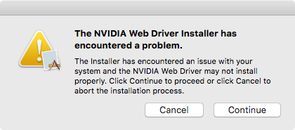

GTX 960 OC , but i even don't use NVIDIA Web . After install try to get second part (configuration , user etc). Hang on -v mode. Last try..
Use nv_disable=1 boot arg and check your clover boot manager screen and uncheck any Nvidia graphics commands. There are many with Intel systems that are having trouble loading the web drivers correctly. Look in to the web drivers threads on how they got them working. I recall something about enabling SIP loading drivers and then disabling SIP and activating them. There is a sequence that must be followed for them to load correctly.

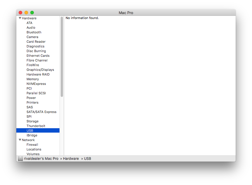

I tried several external USB-drives, and none of them was detected. I tried different USB 3.1 and USB 2.0 ports. Although mouse and keyboard was successfully detected when plug in to USB 2.0 port.
UPDATE:
I did some tests and find out that without this kexts stored in S\L\E (for some reason they doesn't work in clover kext directory) I cannot even boot system because of AppleUSBXHCI loop.
DummyUSBEHCIPCI.kext
DummyUSBXHCIPCI.kext
GenericUSBXHCI.kext
Also its looks like changes made in "SPUSBReporter.spreporter" and "VDC.plugin" doesn't affect my system at all (maybe problem is here?) . USB 3.1 ports doesn't work at all, USB 2.0 work only with mouse, keyboard and graphical tablet, any external USB drives aren't recognized.

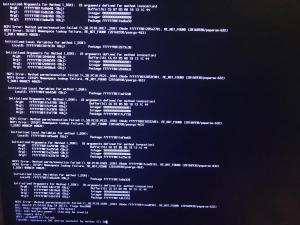

without those Dummy kexts on my system

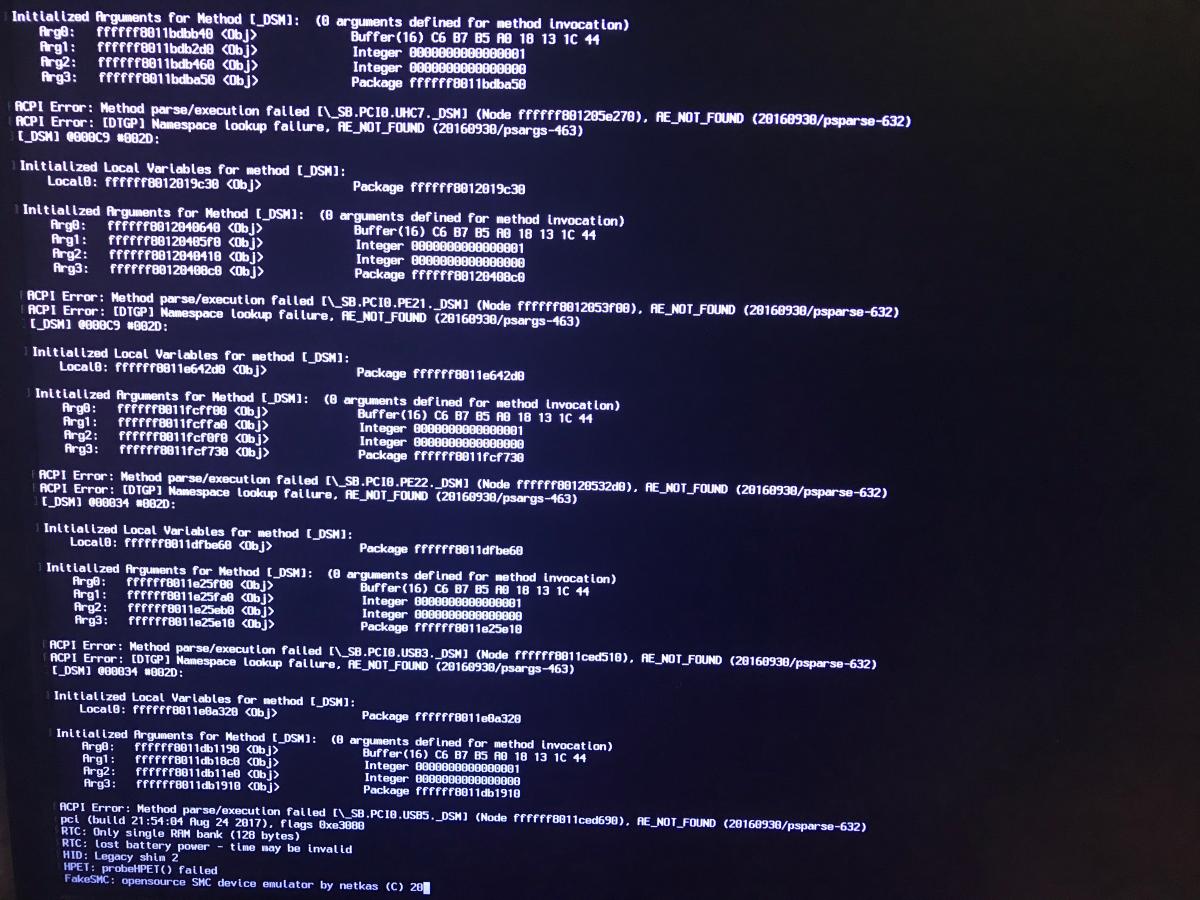

while boot it gets spams with AppleUSBXHCI loop trap errors .
- try deleting the /System/Library/Extensions/IOUSBHostFamily.kext/Contents/PlugIns/AppleUSBXHCI.kext  (back up it somewhere)
- then install the USBfix again
- fix the S/L/E permissions
- rebuild kernel cache
- and boot again.

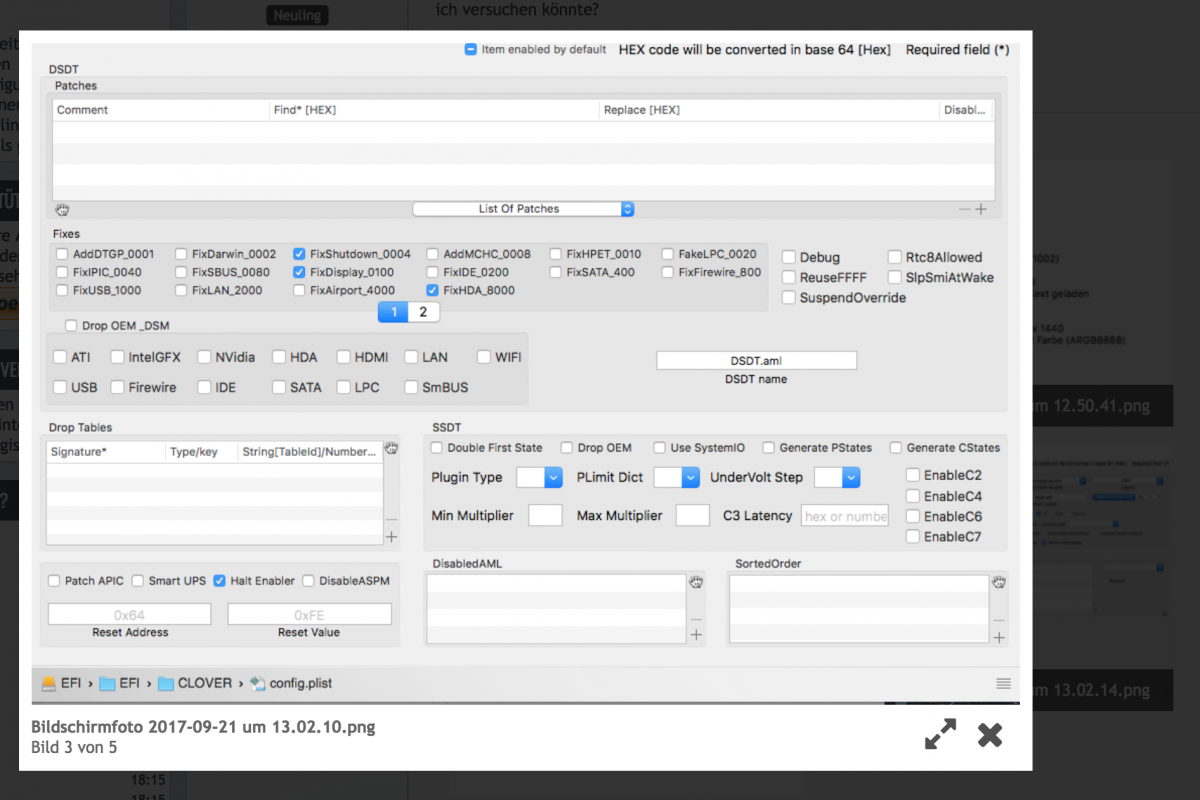

And if you have AHCI errors just change the Settings of Clover AHCI (for me the Settings in the Video simply caused it) (Screenshot of my working settings)

Could you share your clover config? I tried everything and I still cannot even run system without dummy kexts... (╯°□°)╯︵ ┻━┻
Tried run in safe mode and got this:
And this with config from tutorial:

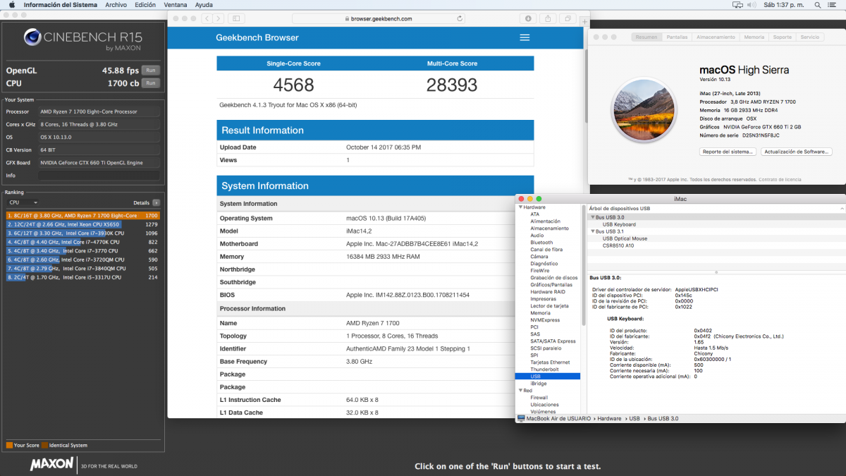

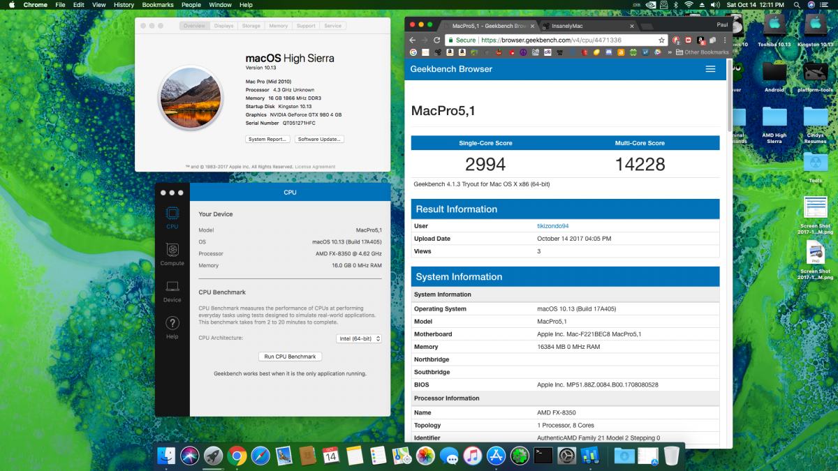

Thank you @bronya @gigamax and the other members for the help. testing hs in my ryzen 1700 @ 3.8ghz whit b350 mortar. no usb fixes or kexts all usb is working oob. for 660 ti use the lilu +NvidiaGraphicsFixup.kext without the inject Nvidia in clover and the hdmi audio works. ethernet works. shutdown. restart works. I don't test the sleep yet. and the integrated audio its not working. I know whit voodoohda he works but I use the audio of the 660 ti. sorry for the bad English.
edit1. the sleep is working perfect. only left to make work the internal audio (the voodoohda its not my first option I prefer dsdt edit, clover injection or some kexts) and try to make work the FaceTime and iCloud.
