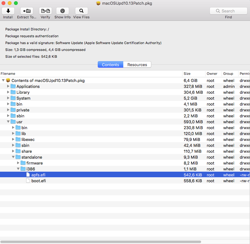

abdouoi Posted July 24, 2017 Share Posted July 24, 2017 Where can I find the new apfs.efi ? Link to comment https://www.insanelymac.com/forum/topic/324194-pre-release-macos-high-sierra/page/85/#findComment-2468645 Share on other sites More sharing options...
fantomas Posted July 24, 2017 Author Share Posted July 24, 2017 Where can I find the new apfs.efi ? I'll do like I didn't understand. 2 Link to comment https://www.insanelymac.com/forum/topic/324194-pre-release-macos-high-sierra/page/85/#findComment-2468651 Share on other sites More sharing options...

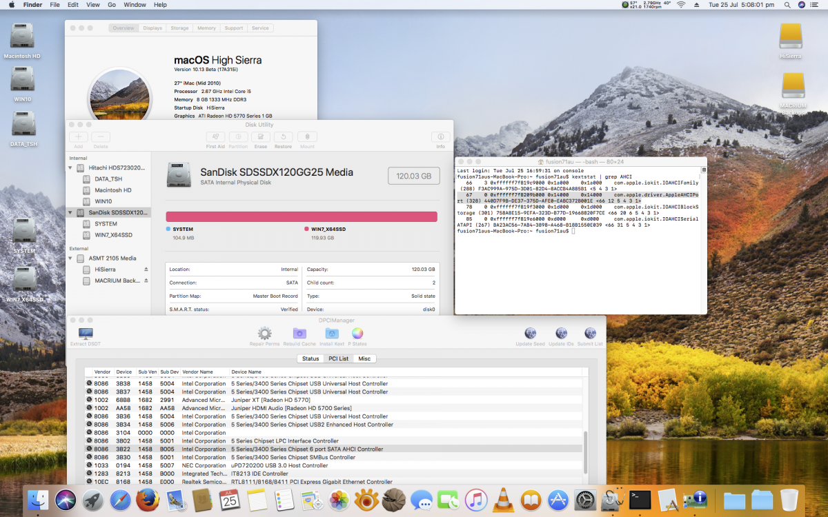

griven Posted July 24, 2017 Share Posted July 24, 2017 Update went fine with OZ on my Desktop but struggled on my Thinkpad with Clover. If you use VoodooPS2 with HighSierra make sure to remove the kext before the 2nd Stage installer begins otherwise it'll freeze before entering the 2nd stage. Once the install finished you may put it back it'll work as before... Link to comment https://www.insanelymac.com/forum/topic/324194-pre-release-macos-high-sierra/page/85/#findComment-2468663 Share on other sites More sharing options...

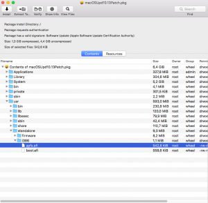

abdouoi Posted July 24, 2017 Share Posted July 24, 2017 I'll do like I didn't understand. here.png I'm not a registered developer to grab the pkg. Can you please upload the apfs.efi ? Thanks! Link to comment https://www.insanelymac.com/forum/topic/324194-pre-release-macos-high-sierra/page/85/#findComment-2468666 Share on other sites More sharing options...
fantomas Posted July 24, 2017 Author Share Posted July 24, 2017 I'm not a registered developer to grab the pkg. Can you please upload the apfs.efi ? Thanks! apfs.efi_beta4.zip 3 Link to comment https://www.insanelymac.com/forum/topic/324194-pre-release-macos-high-sierra/page/85/#findComment-2468669 Share on other sites More sharing options...

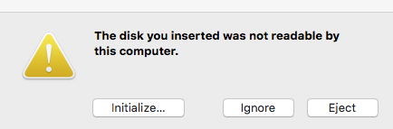

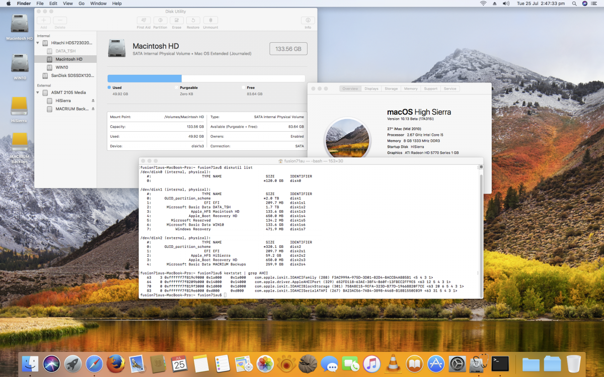

fusion71au Posted July 25, 2017 Share Posted July 25, 2017 Any news about ICH10 and problem with waiting for root device? DB4 still not working. Unfortunately, DB4 still uses AppleAHCIPort.kext ver329 which malfunctions on ICH10 chipsets and also on my 5 series LGA1156 motherboard (GA-P55aUD3). I get an error that the disk attached to my SATA0 port is unable to be read.... Fixed by replacing with AppleAHCIPort.kext ver328 from DB2/Public Beta1... AppleAHCIPort_v328.kext.zip 2 Link to comment https://www.insanelymac.com/forum/topic/324194-pre-release-macos-high-sierra/page/85/#findComment-2468788 Share on other sites More sharing options...

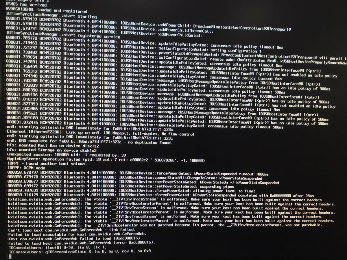

arsradu Posted July 25, 2017 Share Posted July 25, 2017 Here... Sadly that didn't work for me... It hangs on boot. Looks like it cannot get the Nvidia patch done. Link to comment https://www.insanelymac.com/forum/topic/324194-pre-release-macos-high-sierra/page/85/#findComment-2468798 Share on other sites More sharing options...
