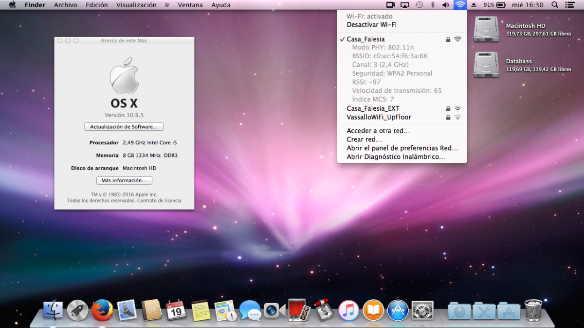

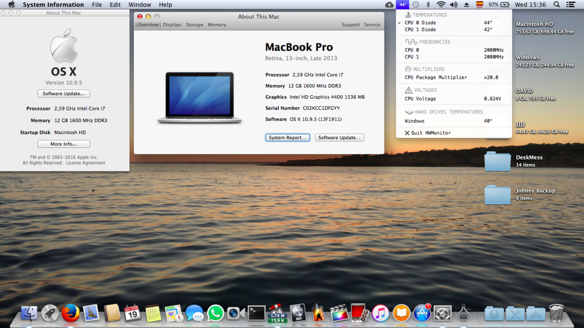

kosakgroove Posted July 19, 2017 Share Posted July 19, 2017 Seeing what Apple holds for our future on older machines like mine, I am staying in Mavericks... Regression complete, and I am truly happy I did, it works 20x faster than versions after Yosemite... Got my setup nice and done already in my Lenovo L420 and Asus X550 , and I will stick to it until HFS+ dies, which is around 2040.. 23 years of enjoyment left , Background is a sunset in the Algarve by me 2 Link to comment https://www.insanelymac.com/forum/topic/324194-pre-release-macos-high-sierra/page/83/#findComment-2465771 Share on other sites More sharing options...

kosakgroove Posted July 19, 2017 Share Posted July 19, 2017 Cool i want to know your Lenovo Thinkpad L420 device. does your l420 have a whitelist in bios? if there is no whitelist, just replace ar9285? ar9285 has bt? combo card? how about fan noise? i love snow leopard. i want to back sl. but now i can't. i'm considering to buy sandy laptop. Yes I patched the BIOS myself really easy, I hosted it in my guide for the laptop. I am actually really happy with this laptop, but I am unsure if it runs Snowy, since the SMBIOS is MacbookPro8,1 minimum. I have a PCI USB 3.0 card and an Atheros AR 9285, which I bought for 5$ Bluetooth works OOTB since it is built in the computer (some Broadcom one) ! I think it is a very good and cheap laptop ! Fan noise is minimum, and I have tweaked a button to toggle full speed fan, so that is really awesome Best Regards Sherlocks Taken from the L420 in Mac OS X 10.9.5 Link to comment https://www.insanelymac.com/forum/topic/324194-pre-release-macos-high-sierra/page/83/#findComment-2465828 Share on other sites More sharing options...

Sherlocks Posted July 19, 2017 Share Posted July 19, 2017 Yes I patched the BIOS myself really easy, I hosted it in my guide for the laptop. I am actually really happy with this laptop, but I am unsure if it runs Snowy, since the SMBIOS is MacbookPro8,1 minimum. I have a PCI USB 3.0 card and an Atheros AR 9285, which I bought for 5$ Bluetooth works OOTB since it is built in the computer (some Broadcom one) ! I think it is a very good and cheap laptop ! Fan noise is minimum, and I have tweaked a button to toggle full speed fan, so that is really awesome Best Regards Sherlocks Captura de pantalla 2017-07-19 a la(s) 16.30.53.png Taken from the L420 in Mac OS X 10.9.5 sorry off-topic i will check your guide. thank you 1 Link to comment https://www.insanelymac.com/forum/topic/324194-pre-release-macos-high-sierra/page/83/#findComment-2465837 Share on other sites More sharing options...
