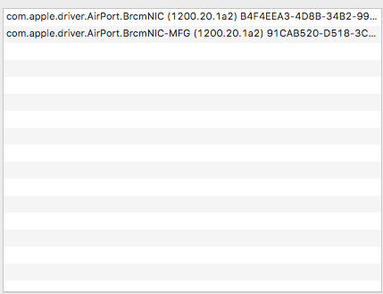

New Patch for Broadcom BCM94352. There are changes only in com.apple.driver.AirPort.BrcmNIC kext. For NICMFG kext is the same patch as in DP1.
I've merged 3 patches into one now! So you don't need PCIe2 and PCIe3 patches! They are all included in one new patch!
What does this patch do? My aw-ce123h is BCM94352 and works using same patches from sierra.
Sent from my SM-G930F using Tapatalk
In Sierra there were VCM94352cards, that refused to work with an error: "Failed PCIe configuration". In first developer beta of HS it has caused a KP. These are the patches for this situation. There is no connection to vendor because I had thisproblem on AzureWave and Dell
Gesendet von iPhone mit Tapatalk
The patches used in Sierra and previous versions were for AirportBrcm4360.kext, which is not used anymore, it has been replaced by two new kexts:
So we can delete all the old patches from the config plist and use the ones Sherlocks provided :D
