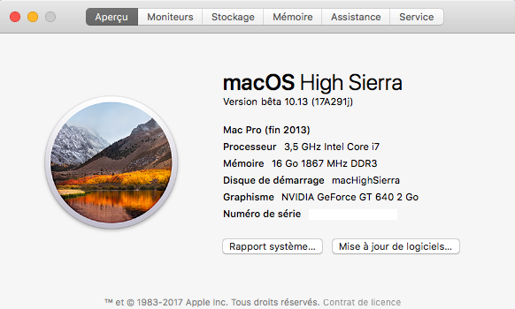

I use AGDPFix v1.3 to patch AppleGraphicsDevicePolicy.kext in macOS 10.13 Beta 2: my SMBIOS Macpro6,1 don't have Black screen, now.
Waiting for Lilu  et NvidiaGraphicsFixup, ALC,... new release for High Sierra.
Ehm. If you just simply patched AppleGraphicsDevicePolicy.kext (from 10.13 Beta 2 instead of 10.12.5 like @fabiosun mentioned) with AGDPFix, then Lilu & NvidiaGraphicsFixup should work properly, but you need these boot arguments besides them for them to work under 10.13:
-lilubeta -ngfxbeta
