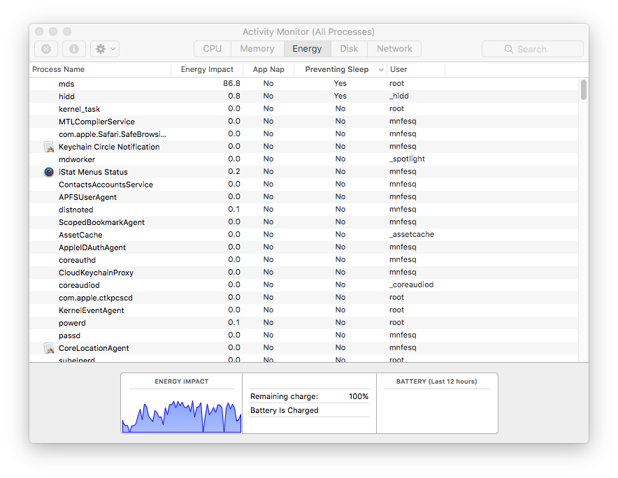

mnfesq Posted June 22, 2017 Share Posted June 22, 2017 I have 2 system processes preventing my laptop from going to sleep. One is MDS. The other is hidd. I believe that hidd is a process that may involve my trackpad or VoodooPS2Controller.kext. I use RehabMan's 5/27 version of that kext. Any ideas what to do to prevent those processes from disabling sleep? Thanks. Link to comment https://www.insanelymac.com/forum/topic/324194-pre-release-macos-high-sierra/page/41/#findComment-2449260 Share on other sites More sharing options...
SavageAUS Posted June 22, 2017 Share Posted June 22, 2017 I have 2 system processes preventing my laptop from going to sleep. One is MDS. The other is hidd. I believe that hidd is a process that syncs my address book but I'm not 100% sure about that. Any ideas what to do to prevent those processes from disabling sleep? Thanks. Untitled.png MDS from my research seems to be spotlight related. Metadata Server. HIDD may be usb peripherals? Mouse, Keyboard. Human Interface Device Daemon? Link to comment https://www.insanelymac.com/forum/topic/324194-pre-release-macos-high-sierra/page/41/#findComment-2449262 Share on other sites More sharing options...
mnfesq Posted June 22, 2017 Share Posted June 22, 2017 MDS from my research seems to be spotlight related. Metadata Server. HIDD may be usb peripherals? Mouse, Keyboard. Human Interface Device Daemon? I'm actually getting several processes that prevent sleep - more than just the ones in the photo I posted. They seem to come and go as they are operating. The one that doesn't seem to go away at all is the hidd process. I just installed RehabMan's VoodooPS2Controller.kext properly for HS. Previously, I just used the kext and did not have the launch daemon plist or the daemon in usr/bin. I added those files but still have the same issue. I have nothing plugged into my external USB ports and, internally, I have my webcam, bluetooth chip and wireless audio chip powered by USB. I'm not sure how internal USB devices would be preventing sleep. I thought all my sleep problems would be resolved by a working SSDT. Link to comment https://www.insanelymac.com/forum/topic/324194-pre-release-macos-high-sierra/page/41/#findComment-2449263 Share on other sites More sharing options...
SavageAUS Posted June 22, 2017 Share Posted June 22, 2017 I'm actually getting several processes that prevent sleep - more than just the ones in the photo I posted. They seem to come and go as they are operating. The one that doesn't seem to go away at all is the hidd process. I just installed RehabMan's VoodooPS2Controller.kext properly for HS. Previously, I just used the kext and did not have the launch daemon plist or the daemon in usr/bin. I added those files but still have the same issue. I have nothing plugged into my external USB ports and, internally, I have my webcam, bluetooth chip and wireless audio chip powered by USB. I'm not sure how internal USB devices would be preventing sleep. I thought all my sleep problems would be resolved by a working SSDT. On my Haswell laptop which has High Sierra running at the moment it shows hidd as preventing sleep but when i close the lid it still sleeps. Link to comment https://www.insanelymac.com/forum/topic/324194-pre-release-macos-high-sierra/page/41/#findComment-2449269 Share on other sites More sharing options...
mnfesq Posted June 22, 2017 Share Posted June 22, 2017 But On my Haswell laptop which has High Sierra running at the moment it shows hidd as preventing sleep but when i close the lid it still sleeps. Thanks for the tip. For now, lid sleep does not work at all. Period. However, menu sleep does work. But when I wake the laptop from sleep, all I get is my cursor on a black screen. I guess that's progress but problems with wake from sleep are a whole different issue and I will need to do some diagnostic work before I ask any questions about it. Link to comment https://www.insanelymac.com/forum/topic/324194-pre-release-macos-high-sierra/page/41/#findComment-2449274 Share on other sites More sharing options...

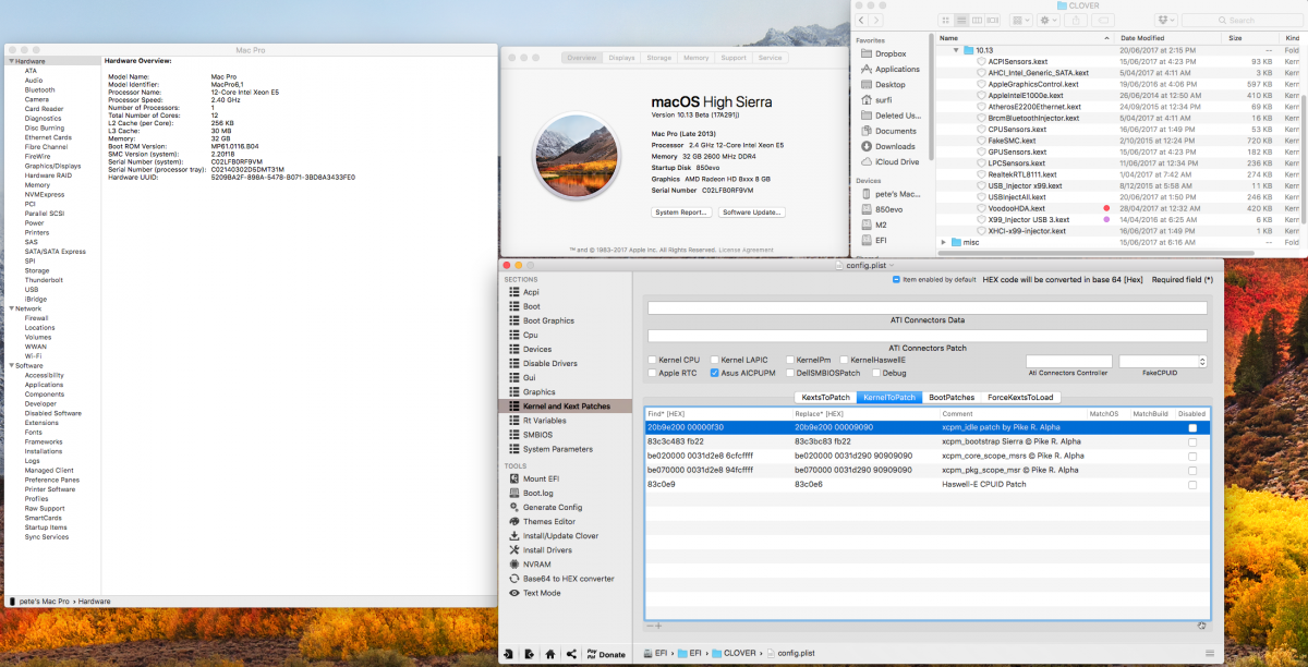

surfinchina Posted June 22, 2017 Share Posted June 22, 2017 I have updated via software update from beta 1. But it hangs at ++++++++ phase , maybe unsupported cpu need new patches for new beta 2 kernel? in beta 1 I am using these patches 5d750004723cd077500fb6c0 > 5d7500046a3cd077500fb6c0 89d804c43c227722 > 89d804c33c227722 be0b0000005de9080000000f1f840000000000554889e54157 > be0b0000005de9080000000f1f840000000000c34889e54157 89d8c1e0084863d0 > b8003000004863d0 My beta 2 went through no problem. I'm not good with this stuff and just have various patches and kexts from my other (5960x) computer on this computer, which has some 12 core ES I'm not sure which one lol. I've done a screen shot so you can see what I did. One thing I noticed was that a whole different set of USBs is working now. beta 1 had my USB2 and 3.1, now I only have USB3 and the USB header working. Just in case you're using a portable hard drive to run it... I can't fix it because 10.13 seems to have extra protection and the patches break the apple kexts. And the X99 usb kext no longer works. Link to comment https://www.insanelymac.com/forum/topic/324194-pre-release-macos-high-sierra/page/41/#findComment-2449304 Share on other sites More sharing options...
surfinchina Posted June 22, 2017 Share Posted June 22, 2017 Thank you if I don't mind you have in signature two Hasvell E/EP rig, mine is a broadwell EP I can't see very well your attached picture, if you can share your config.plist i will try to boot with some of your Patches Here you go. config.plist.zip Link to comment https://www.insanelymac.com/forum/topic/324194-pre-release-macos-high-sierra/page/41/#findComment-2449317 Share on other sites More sharing options...
PMheart Posted June 22, 2017 Share Posted June 22, 2017 I have updated via software update from beta 1. But it hangs at ++++++++ phase , maybe unsupported cpu need new patches for new beta 2 kernel? in beta 1 I am using these patches 5d750004723cd077500fb6c0 > 5d7500046a3cd077500fb6c0 89d804c43c227722 > 89d804c33c227722 be0b0000005de9080000000f1f840000000000554889e54157 > be0b0000005de9080000000f1f840000000000c34889e54157 89d8c1e0084863d0 > b8003000004863d0 Hi, the patches has been changed since DP2 indeed, try this one instead: 750004723cd077500fb6c0 > 7500046a3cd077500fb6c0 89d804c43c227722 > 89d804c33c227722 be0b0000005de9080000000f1f840000000000554889e54157 > be0b0000005de9080000000f1f840000000000c34889e54157 89d8c1e0084863d0 > b8003000004863d0 As you can see, I've just removed a redundant byte for the 1st patch, and it will be fine for DP2. So. Just removing '75' for the first patch (find/replace), and then enjoy! 2 Link to comment https://www.insanelymac.com/forum/topic/324194-pre-release-macos-high-sierra/page/41/#findComment-2449328 Share on other sites More sharing options...
surfinchina Posted June 22, 2017 Share Posted June 22, 2017 Thank you for me it is not working also with your patches Sorry I couldn't help! Hopefully PMheart can I noticed some new kexts in beta 2. Link to comment https://www.insanelymac.com/forum/topic/324194-pre-release-macos-high-sierra/page/41/#findComment-2449341 Share on other sites More sharing options...
