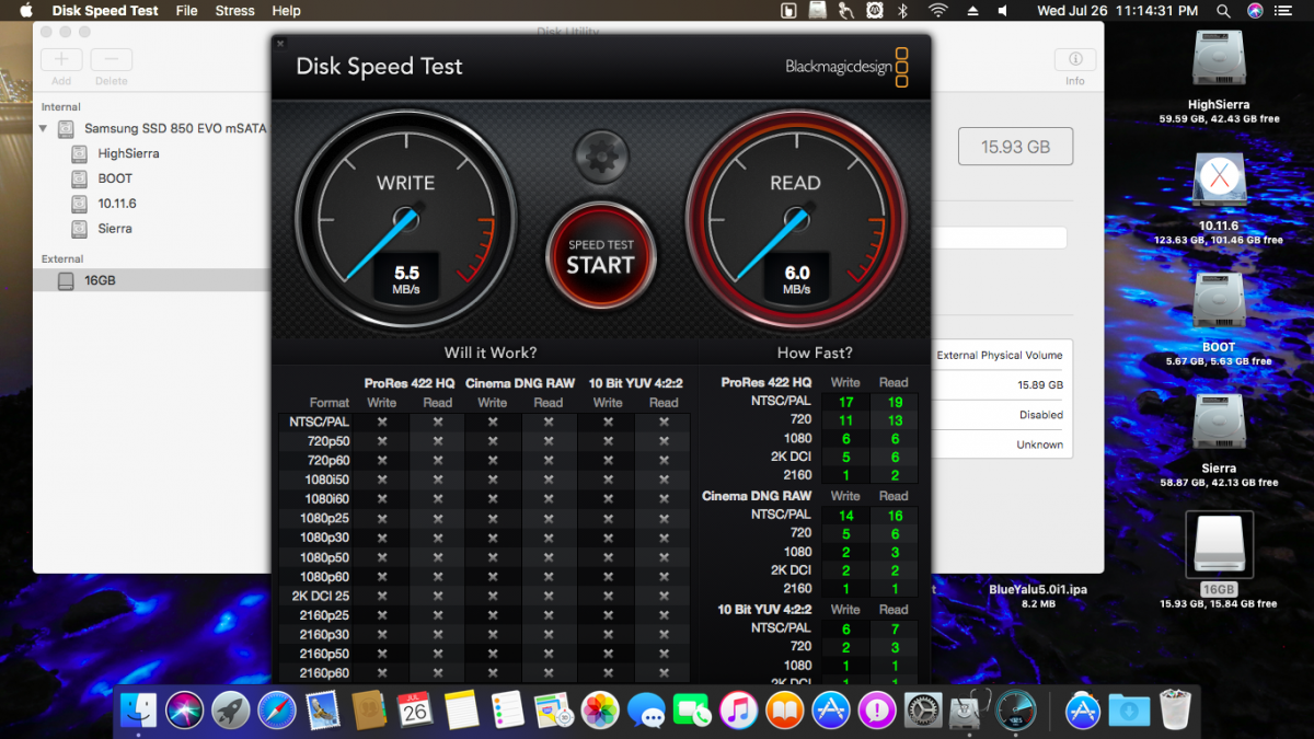

Black7ML1082 Posted July 27, 2017 Share Posted July 27, 2017 @Sinetek Keep at it buddy, Got the card reader working on my Envy 15T-J000 with the 5227 ID, I purchased a 16gb SD card with read speeds of up to 80MB/s but when I bench it on BlackMagic Disk Speed test it only shows speeds shown an not what the card can do... it is a Class 10, I know its a BETA release an I applaud your work on it. Keep it up sir 1 Link to comment https://www.insanelymac.com/forum/topic/321080-sineteks-driver-for-realtek-rtsx-sdhc-card-readers/page/6/#findComment-2469866 Share on other sites More sharing options...

yungyulli Posted August 31, 2017 Share Posted August 31, 2017 okay so it works after I restarted my laptop like twice but on another note the read/write speed are only like 8mbps ? is that normal? I mean I guess it doesn't truly matter as long as I can get my photos off of my sd card. just wanted to know if that is normal? Link to comment https://www.insanelymac.com/forum/topic/321080-sineteks-driver-for-realtek-rtsx-sdhc-card-readers/page/6/#findComment-2487958 Share on other sites More sharing options...
