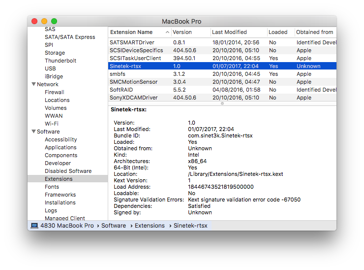

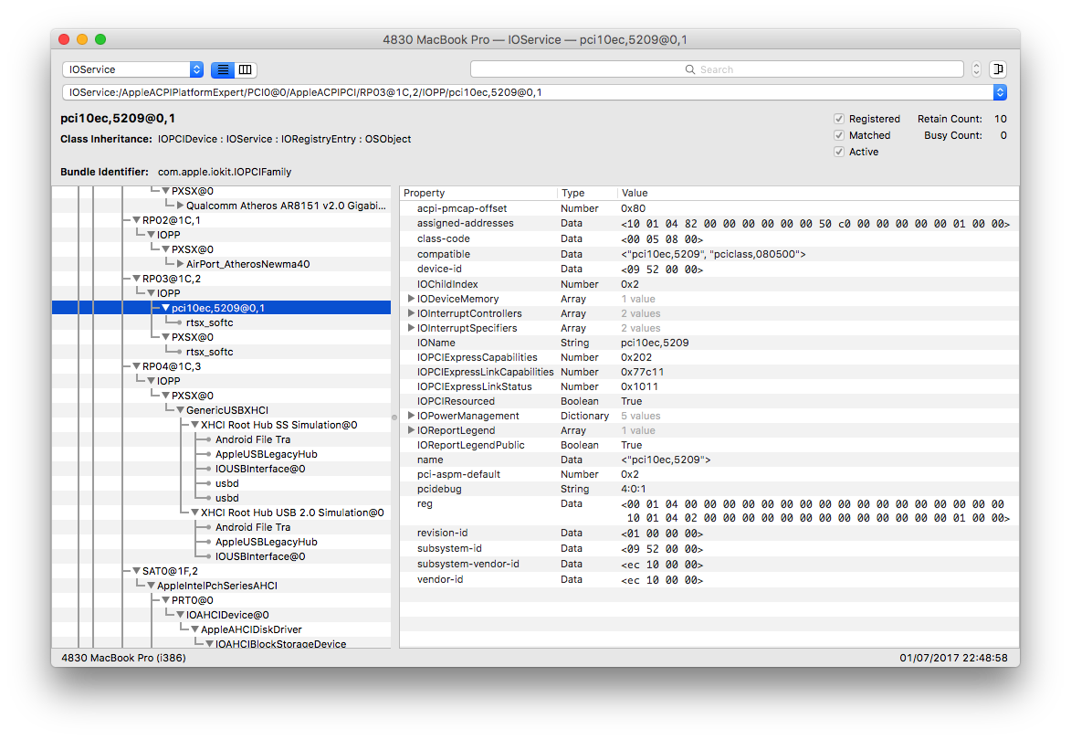

MacNB Posted July 1, 2017 Share Posted July 1, 2017 Great initiative Sinetek. I have an Acer 4830T. It has Realtek RTS5209 (0x520910EC). I have installed your kext in /L/E and rebuild cache. It's loaded but does not work: No SD cards are recognised. There's no trace of 'rtsx' in the logs or dmesg output. Found the logs traces: kernel: rtsx_softc::probe(PXSX) kernel: rtsx_softc::start(PXSX) <5> kernel: PXSX: rtsx_softc (0x142ae05d700ca90d) is already a child kernel: rtsx_softc::probe(pci10ec,5209) kernel: rtsx_softc::start(pci10ec,5209) <7> kernel: pci10ec,5209: rtsx_softc (0x142ae05d705fcd0d) is already a child kernel: pci10ec,5209: rtsx_softc (0x142ae05d705fcd0d) is already a child kernel: (Sinetek-rtsx) : 4-bit kernel: (Sinetek-rtsx) rtsx: cannot write phy register kernel: (Sinetek-rtsx) kernel: (Sinetek-rtsx) rtsx: card inserted kernel: (Sinetek-rtsx) rtsx: attach card kernel: (Sinetek-rtsx) rtsx: voltage change ocr=0x403c0000 kernel: (Sinetek-rtsx) rtsx: executing cmd 52 kernel: (Sinetek-rtsx) rtsx: soft reset kernel: (Sinetek-rtsx) rtsx: cmd 52 arg=0x80000c08 data=0x0 dlen=0 flags=0x1c01 proc="" (error 60) kernel: (Sinetek-rtsx) rtsx: executing cmd 5 kernel: (Sinetek-rtsx) rtsx: soft reset kernel: (Sinetek-rtsx) rtsx: cmd 5 arg=0 data=0x0 dlen=0 flags=0x1031 proc="" (error 60) kernel: (Sinetek-rtsx) rtsx: executing cmd 0 kernel: (Sinetek-rtsx) rtsx: cmd 0 arg=0 data=0x0 dlen=0 flags=0x21 proc="" (error 0) kernel: (Sinetek-rtsx) rtsx: executing cmd 55 kernel: (Sinetek-rtsx) rtsx: soft reset kernel: (Sinetek-rtsx) rtsx: cmd 55 arg=0 data=0x0 dlen=0 flags=0x1c01 proc="" (error 60) kernel: (Sinetek-rtsx) rtsx: executing cmd 1 kernel: (Sinetek-rtsx) rtsx: soft reset kernel: (Sinetek-rtsx) rtsx: cmd 1 arg=0x40000000 data=0x0 dlen=0 flags=0x1031 proc="" (error 60) kernel: (Sinetek-rtsx) rtsx: can't read memory OCR kernel: (Sinetek-rtsx) rtsx: voltage change ocr=0x0 kernel: (Sinetek-rtsx) rtsx: host reset kernel: (Sinetek-rtsx) rtsx: soft reset kernel: (Sinetek-rtsx) rtsx: can't enable card kernel: (Sinetek-rtsx) rtsx: detach card kernel: (Sinetek-rtsx) rtsx: voltage change ocr=0x0 kernel: (Sinetek-rtsx) rtsx: host reset kernel: (Sinetek-rtsx) rtsx: soft reset What's strange, is that in the IOREG tree, I see TWO occurrence of rtsx_softc: Any suggestions ? What can I do to debug this kext further ? Link to comment https://www.insanelymac.com/forum/topic/321080-sineteks-driver-for-realtek-rtsx-sdhc-card-readers/page/5/#findComment-2455523 Share on other sites More sharing options...
