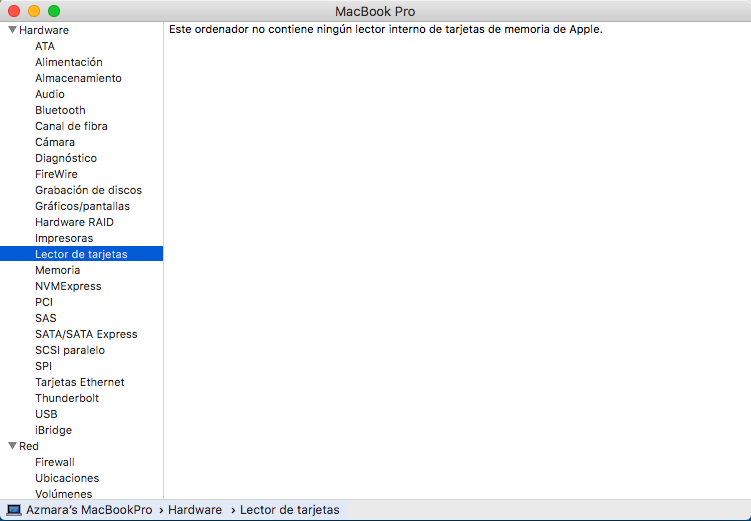

foskvs Posted December 3, 2017 Share Posted December 3, 2017 Only one question... How I can see my card reader as default in system? I edited info.plis from AppleUSBCardReader.kext and set External in to AppleSDCardReader/Physical Interconnect Location, I edited VenID/DevID too in Apple_Internal_SD_Card_Reader_1_00/2_00/3_00 with no result... Any suggestion? Apple PCIe SD card readers are under AppleSDXC.kext and not AppleUSBCardReader.kext. 1 Link to comment https://www.insanelymac.com/forum/topic/321080-sineteks-driver-for-realtek-rtsx-sdhc-card-readers/page/7/#findComment-2543381 Share on other sites More sharing options...
Komar aka Kali Posted December 3, 2017 Share Posted December 3, 2017 Apple PCIe SD card readers are under AppleSDXC.kext and not AppleUSBCardReader.kext. Thanks for reply... An can I edit this kext to see card reader in system...? If yes... How I can do it? Link to comment https://www.insanelymac.com/forum/topic/321080-sineteks-driver-for-realtek-rtsx-sdhc-card-readers/page/7/#findComment-2543800 Share on other sites More sharing options...
foskvs Posted December 3, 2017 Share Posted December 3, 2017 I've never tried it. You might edit Info.plist with this patch in config.plist -> KextsToPatch: Name: AppleSDXC Find: 3c737472 696e673e 70636931 3465342c 31366263 3c2f7374 72696e67 3e Replace: 3c737472 696e673e 70636931 3065632c 35323237 3c2f7374 72696e67 3e InfoPlistPatch=true This will load AppleSDXC.kext, but i don't know if it will show you card reader in System Report. 1 Link to comment https://www.insanelymac.com/forum/topic/321080-sineteks-driver-for-realtek-rtsx-sdhc-card-readers/page/7/#findComment-2543804 Share on other sites More sharing options...

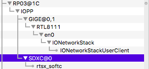

Komar aka Kali Posted December 3, 2017 Share Posted December 3, 2017 I've never tried it. You might edit Info.plist with this patch in config.plist -> KextsToPatch: Name: AppleSDXC Find: 3c737472 696e673e 70636931 3465342c 31366263 3c2f7374 72696e67 3e Replace: 3c737472 696e673e 70636931 3065632c 35323237 3c2f7374 72696e67 3e InfoPlistPatch=true Schermata 2017-12-03 alle 21.52.35.png This will load AppleSDXC.kext, but i don't know if it will show you card reader in System Report. Test and tell you... No luck... But don´t worry, I´m happy with my new full hack with no issues... 100% OSx Sierra... Link to comment https://www.insanelymac.com/forum/topic/321080-sineteks-driver-for-realtek-rtsx-sdhc-card-readers/page/7/#findComment-2543821 Share on other sites More sharing options...
TheRacerMaster Posted December 4, 2017 Share Posted December 4, 2017 IIRC the SPReporter for Card Readers will only look for AppleSDXC. Link to comment https://www.insanelymac.com/forum/topic/321080-sineteks-driver-for-realtek-rtsx-sdhc-card-readers/page/7/#findComment-2543867 Share on other sites More sharing options...

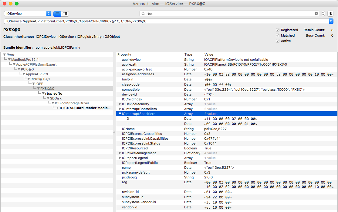

foskvs Posted December 4, 2017 Share Posted December 4, 2017 I tried on my laptop. I don't know if System Report look only for AppleSDXC.kext but i can see many differences between my ioreg and an actual iMac14,1 ioreg (with PCIe card reader). Maybe we just need more properties to be injected. Hack: iMac14,1: Link to comment https://www.insanelymac.com/forum/topic/321080-sineteks-driver-for-realtek-rtsx-sdhc-card-readers/page/7/#findComment-2543951 Share on other sites More sharing options...
TheRacerMaster Posted December 7, 2017 Share Posted December 7, 2017 rtsx is not AppleSDXC, obviously the classes in IORegistryExplorer will look different. Injecting properties for AppleSDXC won't do anything useful. I tried on my laptop. I don't know if System Report look only for AppleSDXC.kext but i can see many differences between my ioreg and an actual iMac14,1 ioreg (with PCIe card reader). This is what I said in #158. SPCardReaderReporter (component that updates the Card Reader section in System Information) only looks for AppleSDXC and com_apple_driver_AppleUSBCardReaderSBC: v3 = kIOMasterPortDefault; v4 = IOServiceMatching("AppleSDXC"); if ( !(unsigned int)IOServiceGetMatchingServices(v3, v4, &v43) ) { v33 = v3; v5 = IOIteratorNext(v43); if ( v5 ) { ... v17 = IOServiceMatching("com_apple_driver_AppleUSBCardReaderSBC"); if ( !(unsigned int)IOServiceGetMatchingServices(v3, v17, &v43) ) { v18 = IOIteratorNext(v43); if ( v18 ) { ... 1 Link to comment https://www.insanelymac.com/forum/topic/321080-sineteks-driver-for-realtek-rtsx-sdhc-card-readers/page/7/#findComment-2545418 Share on other sites More sharing options...
