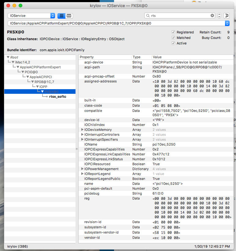

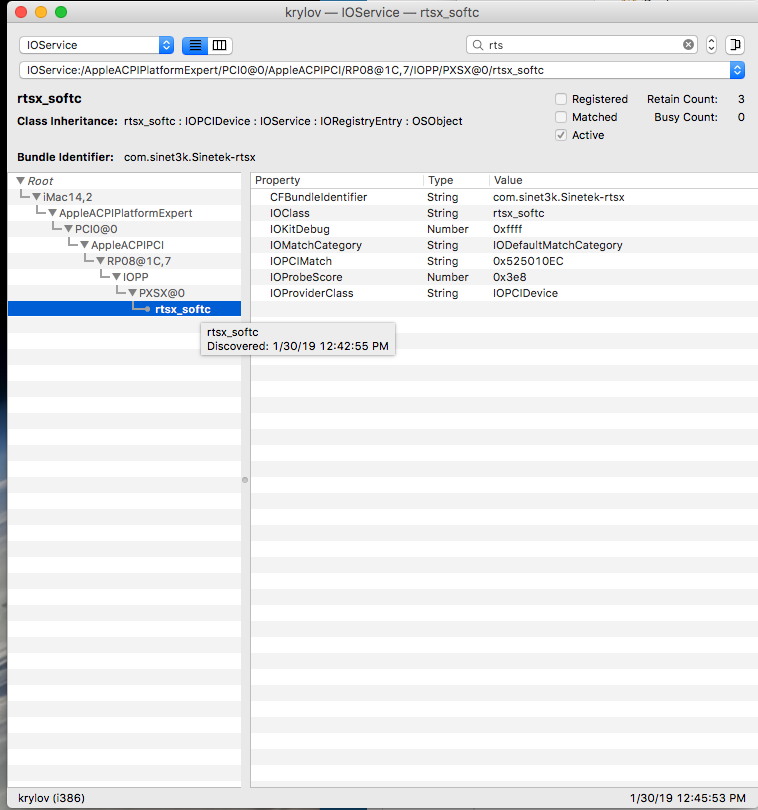

telicha Posted January 30, 2019 Share Posted January 30, 2019 Hello Sinetek thanks for the great work! I have a RTS5250 on a Clevo/Eurocom laptop running sierra ... I got your kext (not sure where is the repository, could only find sources, but found a copy on another thread).. put it in CLOVER/kexts/Other and did not work, kextstat would not even show the kext loaded. Then I edited the Info.plist on your kext and replaced the IOPCIMatch with the right key (I think - got this from lspci on linux: product: RTS5250 PCI Express Card Reader [10EC:5250]) <key>IOPCIMatch</key> <string>0x525010EC</string> Now the kext is definitely loaded, kextstat says: 63 0 0xffffff7f83a25000 0xd000 0xd000 com.sinet3k.Sinetek-rtsx (1) 61964645-BA77-3017-A03C-DFE13E6AD014 <17 12 7 5 4 3 1> but I cannot see any devices in the PCI or Card Readers ... when I plug in a SD card in the slot nothing happens either ... here is what appears on IOREg ....... this laptop is awesome (6700k chip 64GB memory), sierra works beautifully with it, it is my workhorse but still struggling with Thunderbolt hotplug and the SD slot... if you can tell me any suggestion to make it work, I'd appreciate, thanks! Link to comment https://www.insanelymac.com/forum/topic/321080-sineteks-driver-for-realtek-rtsx-sdhc-card-readers/page/10/#findComment-2662063 Share on other sites More sharing options...

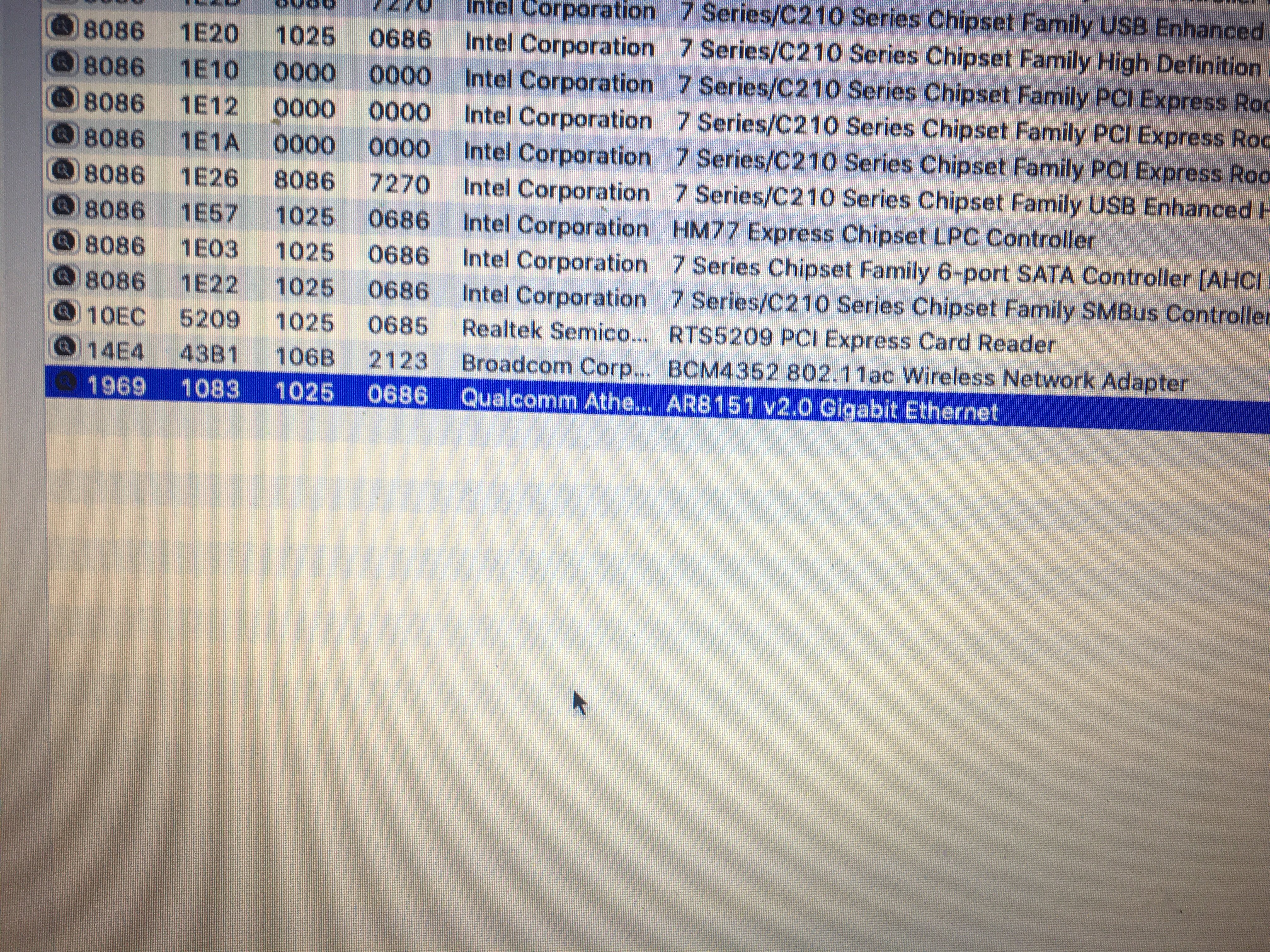

BillyGoatGruff Posted April 3, 2019 Share Posted April 3, 2019 On 7/1/2017 at 5:59 PM, MacNB said: Great initiative Sinetek. I have an Acer 4830T. It has Realtek RTS5209 (0x520910EC). I have installed your kext in /L/E and rebuild cache. It's loaded but does not work: No SD cards are recognised. There's no trace of 'rtsx' in the logs or dmesg output. Found the logs traces: kernel: rtsx_softc::probe(PXSX) kernel: rtsx_softc::start(PXSX) <5> kernel: PXSX: rtsx_softc (0x142ae05d700ca90d) is already a child kernel: rtsx_softc::probe(pci10ec,5209) kernel: rtsx_softc::start(pci10ec,5209) <7> kernel: pci10ec,5209: rtsx_softc (0x142ae05d705fcd0d) is already a child kernel: pci10ec,5209: rtsx_softc (0x142ae05d705fcd0d) is already a child kernel: (Sinetek-rtsx) : 4-bit kernel: (Sinetek-rtsx) rtsx: cannot write phy register kernel: (Sinetek-rtsx) kernel: (Sinetek-rtsx) rtsx: card inserted kernel: (Sinetek-rtsx) rtsx: attach card kernel: (Sinetek-rtsx) rtsx: voltage change ocr=0x403c0000 kernel: (Sinetek-rtsx) rtsx: executing cmd 52 kernel: (Sinetek-rtsx) rtsx: soft reset kernel: (Sinetek-rtsx) rtsx: cmd 52 arg=0x80000c08 data=0x0 dlen=0 flags=0x1c01 proc="" (error 60) kernel: (Sinetek-rtsx) rtsx: executing cmd 5 kernel: (Sinetek-rtsx) rtsx: soft reset kernel: (Sinetek-rtsx) rtsx: cmd 5 arg=0 data=0x0 dlen=0 flags=0x1031 proc="" (error 60) kernel: (Sinetek-rtsx) rtsx: executing cmd 0 kernel: (Sinetek-rtsx) rtsx: cmd 0 arg=0 data=0x0 dlen=0 flags=0x21 proc="" (error 0) kernel: (Sinetek-rtsx) rtsx: executing cmd 55 kernel: (Sinetek-rtsx) rtsx: soft reset kernel: (Sinetek-rtsx) rtsx: cmd 55 arg=0 data=0x0 dlen=0 flags=0x1c01 proc="" (error 60) kernel: (Sinetek-rtsx) rtsx: executing cmd 1 kernel: (Sinetek-rtsx) rtsx: soft reset kernel: (Sinetek-rtsx) rtsx: cmd 1 arg=0x40000000 data=0x0 dlen=0 flags=0x1031 proc="" (error 60) kernel: (Sinetek-rtsx) rtsx: can't read memory OCR kernel: (Sinetek-rtsx) rtsx: voltage change ocr=0x0 kernel: (Sinetek-rtsx) rtsx: host reset kernel: (Sinetek-rtsx) rtsx: soft reset kernel: (Sinetek-rtsx) rtsx: can't enable card kernel: (Sinetek-rtsx) rtsx: detach card kernel: (Sinetek-rtsx) rtsx: voltage change ocr=0x0 kernel: (Sinetek-rtsx) rtsx: host reset kernel: (Sinetek-rtsx) rtsx: soft reset What's strange, is that in the IOREG tree, I see TWO occurrence of rtsx_softc: Any suggestions ? What can I do to debug this kext further ? @MacNB I am building an Dell Optiplex 9010 all-in-one which has a 5209 card reader. I am getting the same result... TWO occurrences of rtsx_softc, and same sequence of messages on the console. Did you find a solution? This is nearly the last item on my list to have every component working on this build (Mojave 10.4.3, Clover, i7-3770S, HD4000 with built-in display). Link to comment https://www.insanelymac.com/forum/topic/321080-sineteks-driver-for-realtek-rtsx-sdhc-card-readers/page/10/#findComment-2668969 Share on other sites More sharing options...
MacNB Posted April 3, 2019 Share Posted April 3, 2019 3 hours ago, BillyGoatGruff said: @MacNB I am building an Dell Optiplex 9010 all-in-one which has a 5209 card reader. I am getting the same result... TWO occurrences of rtsx_softc, and same sequence of messages on the console. Did you find a solution? This is nearly the last item on my list to have every component working on this build (Mojave 10.4.3, Clover, i7-3770S, HD4000 with built-in display). No sorry I gave up when there were no responses from the original developer of this code. It's a dead project. Don't waste your time. Much easier to use USB-to-SD card reader. Link to comment https://www.insanelymac.com/forum/topic/321080-sineteks-driver-for-realtek-rtsx-sdhc-card-readers/page/10/#findComment-2668995 Share on other sites More sharing options...
