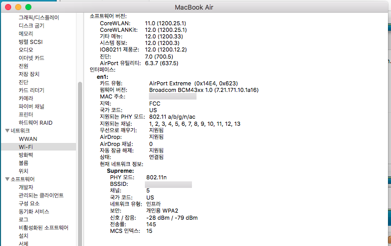

Sherlocks Posted September 21, 2016 Share Posted September 21, 2016 anyone have 5g connection lost after wakeup? fresh boot, i can use 5g wifi. and go sleep, wakeup, 5g wifi is gone, can only use normal wifi. Link to comment https://www.insanelymac.com/forum/topic/312759-fix-macos-sierra-dp1-bcm94532z-wifi/page/3/#findComment-2281147 Share on other sites More sharing options...
Sherlocks Posted September 21, 2016 Share Posted September 21, 2016 anyone have 5g connection lost after wakeup? fresh boot, i can use 5g wifi. and go sleep, wakeup, 5g wifi is gone, can only use normal wifi. 스크린샷 2016-09-21 오후 3.26.08.png https://github.com/toleda/wireless_half-mini if you have issue like me, download config-bcm94352-120.plist.zip and input 10.12 patch and you have to input MatchOS 10.12.x. also previous patch 10.11 input MatchOS 10.11.x Thanks toleda and darkvoid Link to comment https://www.insanelymac.com/forum/topic/312759-fix-macos-sierra-dp1-bcm94532z-wifi/page/3/#findComment-2281308 Share on other sites More sharing options...

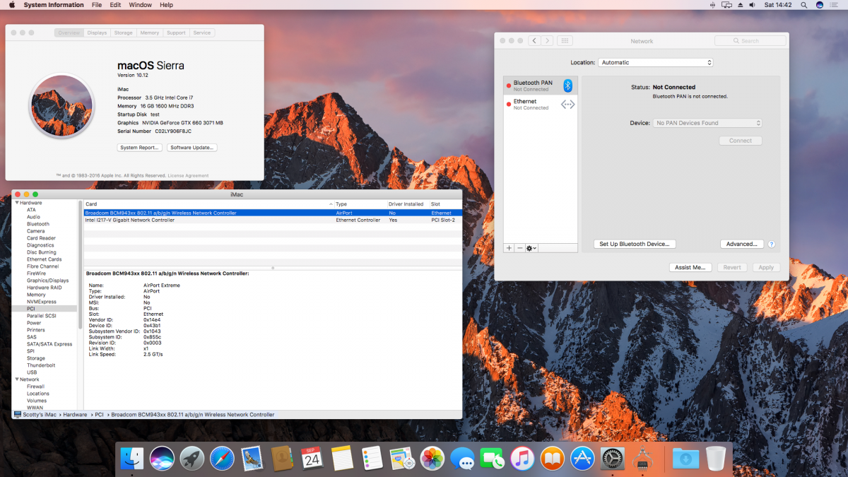

scott_donald Posted September 24, 2016 Share Posted September 24, 2016 Really not sure if this is the right place or not... Successful booting the app store Sierra on my setup except WIFI, i use an USB BT adapter. in last 3 versions of OSX used - bcm4352bt.kext from Feb 1 2014 to get WiFi.... for some reason in Siera i dont get it anymore - can anyone here help so i can install to my main drive??? Link to comment https://www.insanelymac.com/forum/topic/312759-fix-macos-sierra-dp1-bcm94532z-wifi/page/3/#findComment-2284104 Share on other sites More sharing options...
