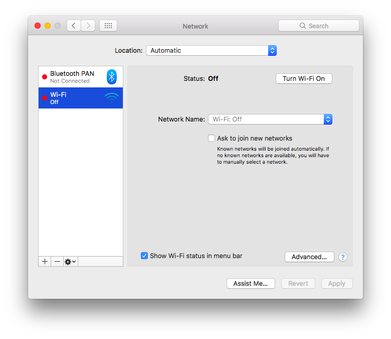

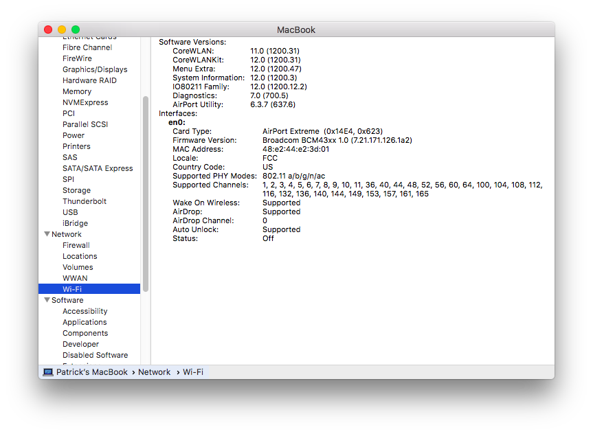

PatrickX64 Posted May 27, 2017 Share Posted May 27, 2017 I applied the patch, and it allowed my hardware to be identified. However, Wi-Fi status is permanently off and I can't enable it through the Menu Bar or System Preferences. Link to comment https://www.insanelymac.com/forum/topic/312759-fix-macos-sierra-dp1-bcm94532z-wifi/page/6/#findComment-2431523 Share on other sites More sharing options...

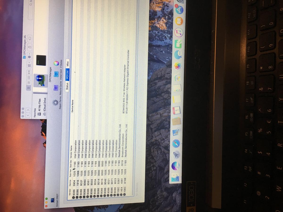

wikedone Posted December 1, 2017 Share Posted December 1, 2017 i cant get my wifi to work i have a bcm4352z bluetooth seems to be working but wifi isnt pics show what im looking at Link to comment https://www.insanelymac.com/forum/topic/312759-fix-macos-sierra-dp1-bcm94532z-wifi/page/6/#findComment-2542550 Share on other sites More sharing options...

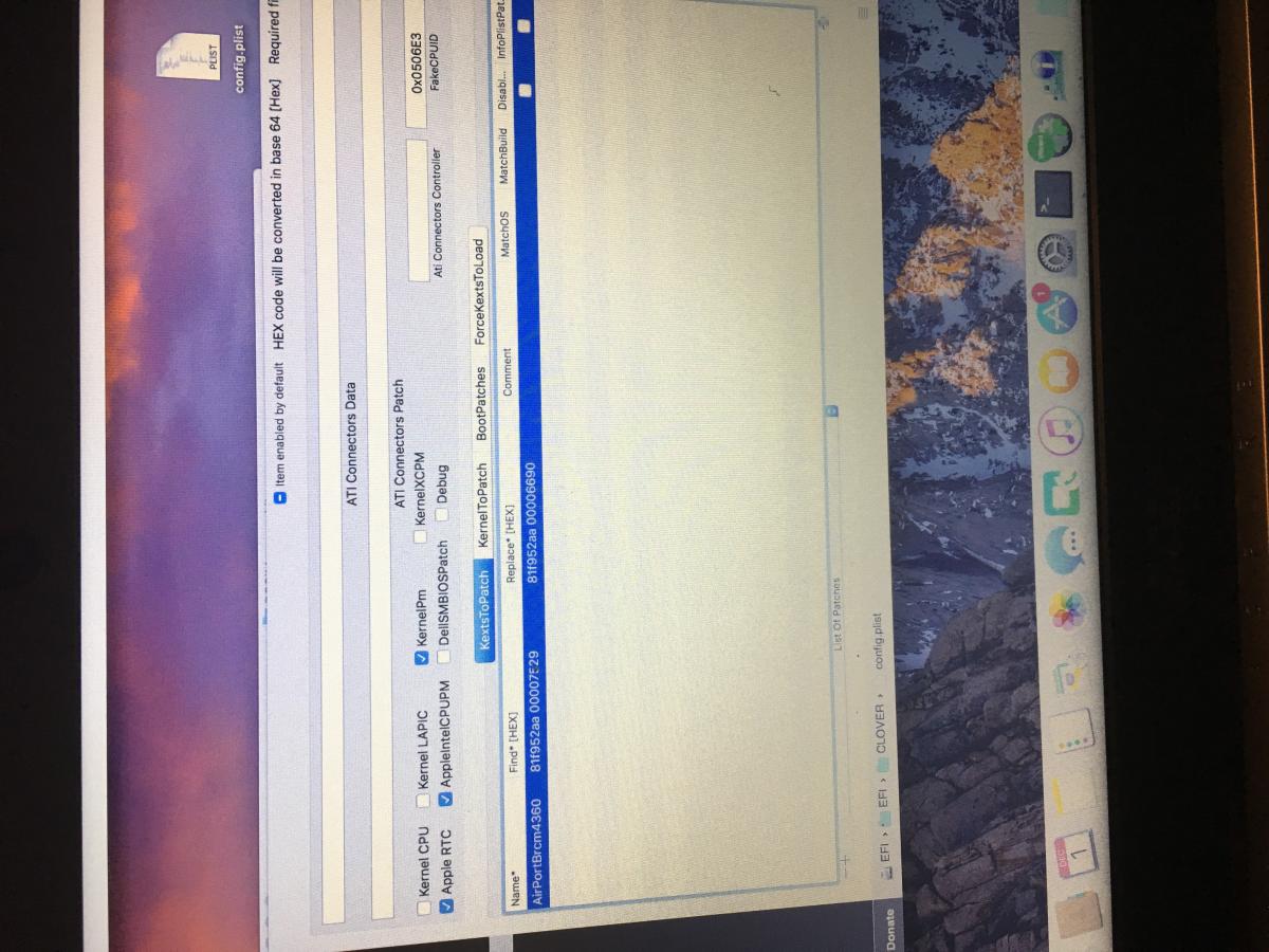

Dniel97 Posted June 30, 2020 Share Posted June 30, 2020 On 1/8/2018 at 11:17 PM, b0fh said: what did the trick for me was to use [com.apple.driver.AirPort.Brcm4360] as the driver name instead of [AirPortBrcm4360] got this tip from RehabMan himself! WOW thank you so much! That did the trick. I installed FakePCIID_Broadcom_WiFi.kext and FakePCIID.kext in /L/E and I added this KextPatch in Clover: Kext: com.apple.driver.AirPort.Brcm4360 Find: 81F952AA00007529 Replace: 81F952AA00006690 Link to comment https://www.insanelymac.com/forum/topic/312759-fix-macos-sierra-dp1-bcm94532z-wifi/page/6/#findComment-2728103 Share on other sites More sharing options...
