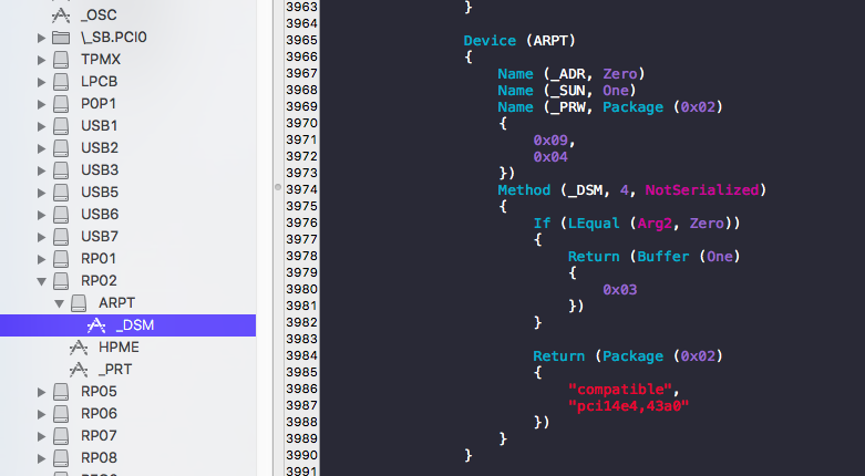

artur_pt Posted July 19, 2016 Share Posted July 19, 2016 hello injected in rp2 DSDT.aml.zip good hack Link to comment https://www.insanelymac.com/forum/topic/312759-fix-macos-sierra-dp1-bcm94532z-wifi/page/2/#findComment-2254537 Share on other sites More sharing options...

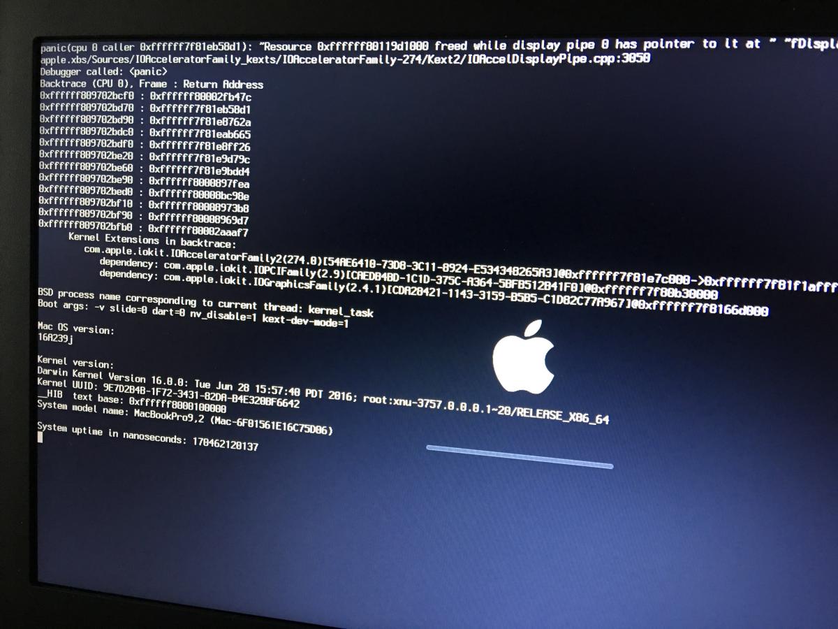

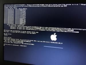

FredWst Posted July 19, 2016 Share Posted July 19, 2016 can you make a log or a picture of KP ? Fred Link to comment https://www.insanelymac.com/forum/topic/312759-fix-macos-sierra-dp1-bcm94532z-wifi/page/2/#findComment-2254809 Share on other sites More sharing options...
ITABRA Posted July 19, 2016 Share Posted July 19, 2016 can you make a log or a picture of KP ? Fred Edit: hello Fred I am not sure but this is Kp after the kernel cache Link to comment https://www.insanelymac.com/forum/topic/312759-fix-macos-sierra-dp1-bcm94532z-wifi/page/2/#findComment-2254960 Share on other sites More sharing options...
artur_pt Posted July 20, 2016 Share Posted July 20, 2016 hello what is in the dsdt .. good hack Link to comment https://www.insanelymac.com/forum/topic/312759-fix-macos-sierra-dp1-bcm94532z-wifi/page/2/#findComment-2255109 Share on other sites More sharing options...
ITABRA Posted July 20, 2016 Share Posted July 20, 2016 Update: hello now wifi works was a graphics card patches Kp but now does not work I usb3.0 ports and bluetooth Thanks, Arthur_PT,FredWst,Macq Link to comment https://www.insanelymac.com/forum/topic/312759-fix-macos-sierra-dp1-bcm94532z-wifi/page/2/#findComment-2255130 Share on other sites More sharing options...
ITABRA Posted July 20, 2016 Share Posted July 20, 2016 hello what is in the dsdt .. Captura de ecrã 2016-07-20, às 07.45.26.png good hack Hello Arthur_PT Thank you for your help but now I have another problem the port USB3.0 does not work and that's not bluetooth and recognized how do Link to comment https://www.insanelymac.com/forum/topic/312759-fix-macos-sierra-dp1-bcm94532z-wifi/page/2/#findComment-2255224 Share on other sites More sharing options...
