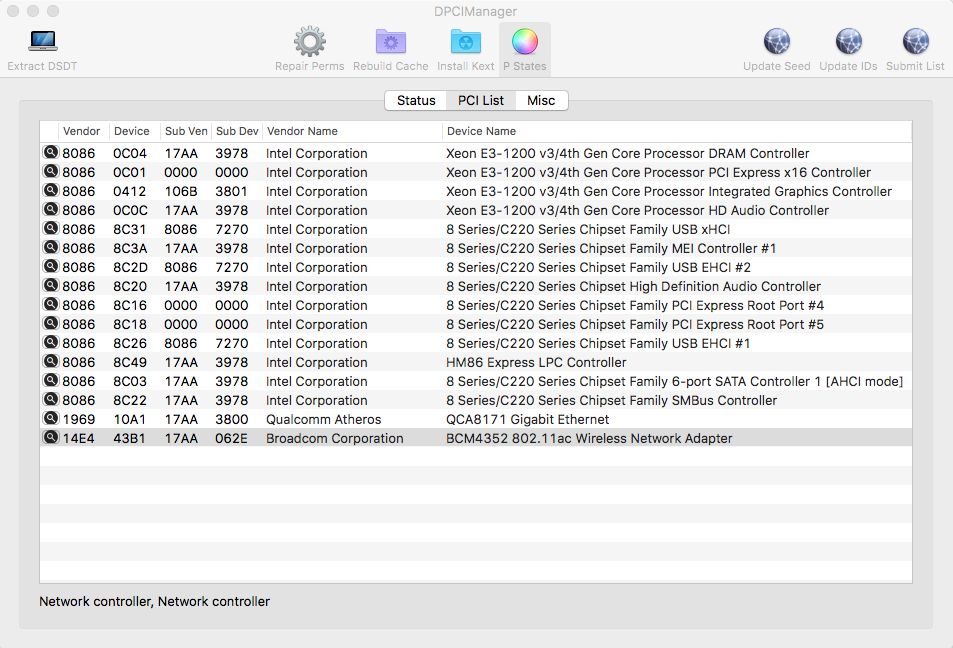

beBoss Posted October 28, 2016 Share Posted October 28, 2016 so this is my ID: 14E443B117AA062E base64: MTRFNDQzQjExN0FBMDYyRQ== but what I have to do, this is for replace string, but for what to put in find pattern? Can't get it at all. Link to comment https://www.insanelymac.com/forum/topic/312759-fix-macos-sierra-dp1-bcm94532z-wifi/page/5/#findComment-2308246 Share on other sites More sharing options...

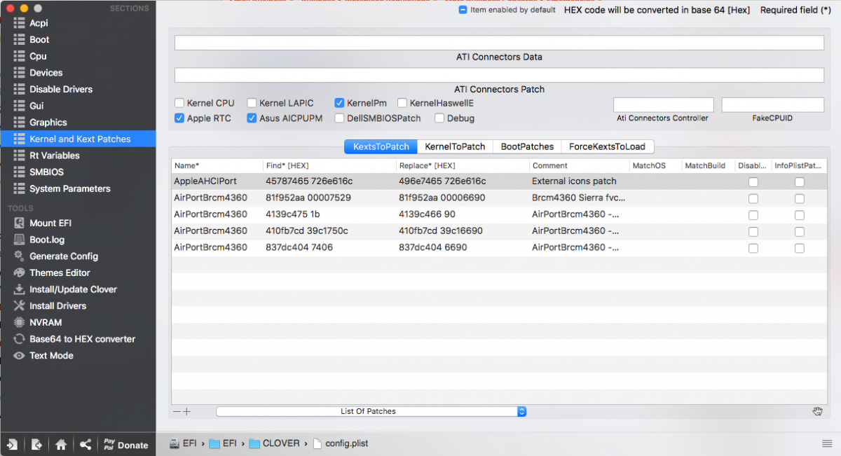

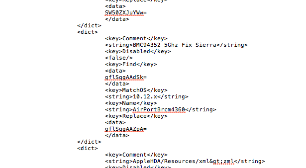

beBoss Posted October 28, 2016 Share Posted October 28, 2016 Finally found what I needed. But for all of you that have the same card as mine: Broadcom BCM4352, and after updating from 10.12 to 10.12.1 your WIFI stopped working just add these three patches to your config, and restart the computer: <dict> <key>Comment</key> <string>AirPortBrcm4360 - PCI Error 1</string> <key>Disabled</key> <false/> <key>Find</key> <data> QTnEdRs= </data> <key>Name</key> <string>AirPortBrcm4360</string> <key>Replace</key> <data> QTnEZpA= </data> </dict> <dict> <key>Comment</key> <string>AirPortBrcm4360 - PCI Error 2</string> <key>Disabled</key> <false/> <key>Find</key> <data> QQ+3zTnBdQw= </data> <key>Name</key> <string>AirPortBrcm4360</string> <key>Replace</key> <data> QQ+3zTnBZpA= </data> </dict> <dict> <key>Comment</key> <string>AirPortBrcm4360 - PCI Error 3</string> <key>Disabled</key> <false/> <key>Find</key> <data> g33EBHQG </data> <key>Name</key> <string>AirPortBrcm4360</string> <key>Replace</key> <data> g33EBGaQ </data> </dict> 2 Link to comment https://www.insanelymac.com/forum/topic/312759-fix-macos-sierra-dp1-bcm94532z-wifi/page/5/#findComment-2308428 Share on other sites More sharing options...
Denicio Posted October 28, 2016 Share Posted October 28, 2016 Screen Shot 2016-10-28 at 16.47.51.pngScreen Shot 2016-10-28 at 16.48.06.png so this is my ID: 14E443B117AA062E base64: MTRFNDQzQjExN0FBMDYyRQ== but what I have to do, this is for replace string, but for what to put in find pattern? Can't get it at all. You got the same ID as mine, the patch should work AS IS. Link to comment https://www.insanelymac.com/forum/topic/312759-fix-macos-sierra-dp1-bcm94532z-wifi/page/5/#findComment-2308446 Share on other sites More sharing options...
krbuck Posted October 28, 2016 Share Posted October 28, 2016 Finally found what I needed. But for all of you that have the same card as mine: Broadcom BCM4352, and after updating from 10.12 to 10.12.1 your WIFI stopped working just add these three patches to your config, and restart the computer: <dict> <key>Comment</key> <string>AirPortBrcm4360 - PCI Error 1</string> <key>Disabled</key> <false/> <key>Find</key> <data> QTnEdRs= </data> <key>Name</key> <string>AirPortBrcm4360</string> <key>Replace</key> <data> QTnEZpA= </data> </dict> <dict> <key>Comment</key> <string>AirPortBrcm4360 - PCI Error 2</string> <key>Disabled</key> <false/> <key>Find</key> <data> QQ+3zTnBdQw= </data> <key>Name</key> <string>AirPortBrcm4360</string> <key>Replace</key> <data> QQ+3zTnBZpA= </data> </dict> <dict> <key>Comment</key> <string>AirPortBrcm4360 - PCI Error 3</string> <key>Disabled</key> <false/> <key>Find</key> <data> g33EBHQG </data> <key>Name</key> <string>AirPortBrcm4360</string> <key>Replace</key> <data> g33EBGaQ </data> </dict> This actually worked for me. Thanks beBoss! Link to comment https://www.insanelymac.com/forum/topic/312759-fix-macos-sierra-dp1-bcm94532z-wifi/page/5/#findComment-2308489 Share on other sites More sharing options...

toleda Posted October 29, 2016 Share Posted October 29, 2016 Finally found what I needed. But for all of you that have the same card as mine: Broadcom BCM4352, and after updating from 10.12 to 10.12.1 your WIFI stopped working 1. Not your work, credit: Neo.aka.Darkman/Post #15/http://www.insanelymac.com/forum/topic/316060-pre-release-macos-sierra-10121/?p=2281834 2. BCM4352: no PCI Error. Actual problem: Clover/config.plist/ACPI/DSDT/Fixes/FixAirport_4000/Yes stopped working. 3. Neo.aka.Darkman is using a fake AW-CE123H (4352) Device ID: 2154. 4. Remove Clover Airport injection. Use kext (RehabMan) injection or ssdt/dsdt injection/add: "compatible", Buffer (0x0D) { "pci14e4,43a0" } 5. The only 4352 patch required is 5 GHz patch, Post #1. 2 Link to comment https://www.insanelymac.com/forum/topic/312759-fix-macos-sierra-dp1-bcm94532z-wifi/page/5/#findComment-2309191 Share on other sites More sharing options...

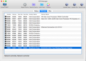

sahib1989 Posted May 19, 2017 Share Posted May 19, 2017 I am using the same patch for handoff/hotspot that I use with El Capitan and it is working fine for me. Untitled.png would you please upload your config.plist file for your efi folder, because i want to copy the section you are using to activate your dw1550(i am using the same card), normally i have to edit kext file manually after every update and thanks Link to comment https://www.insanelymac.com/forum/topic/312759-fix-macos-sierra-dp1-bcm94532z-wifi/page/5/#findComment-2427555 Share on other sites More sharing options...

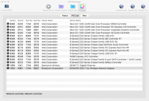

tluck Posted May 25, 2017 Share Posted May 25, 2017 @Da Pupster what does the card/device look like to the system? meaning did you add a FakeID or DSDT/SSDT to make the device look like a 4360? if i run "dspci" to list my PCI devices: i see this for my 1560 04:00.0 Network controller [0280]: Broadcom Corporation BCM4360 802.11ac Wireless Network Adapter [14e4:43a0] (rev 03) (subsys 106b:0019) and you may want to put those FakePCIID kexts on the HD in /Library/Extensions BrcmFirmwareRepo.kext: Install to /Library/Extensions. This kext is much more memory efficient than BrcmFirmwareData.kext and is the preferred configuration. BrcmFirmwareData.kext: Most appropriate for EFI/Clover/kexts. BrcmFirmwareRepo.kext, while much more memory efficient, cannot be injected as can BrcmFirmwareData.kext Link to comment https://www.insanelymac.com/forum/topic/312759-fix-macos-sierra-dp1-bcm94532z-wifi/page/5/#findComment-2430657 Share on other sites More sharing options...
