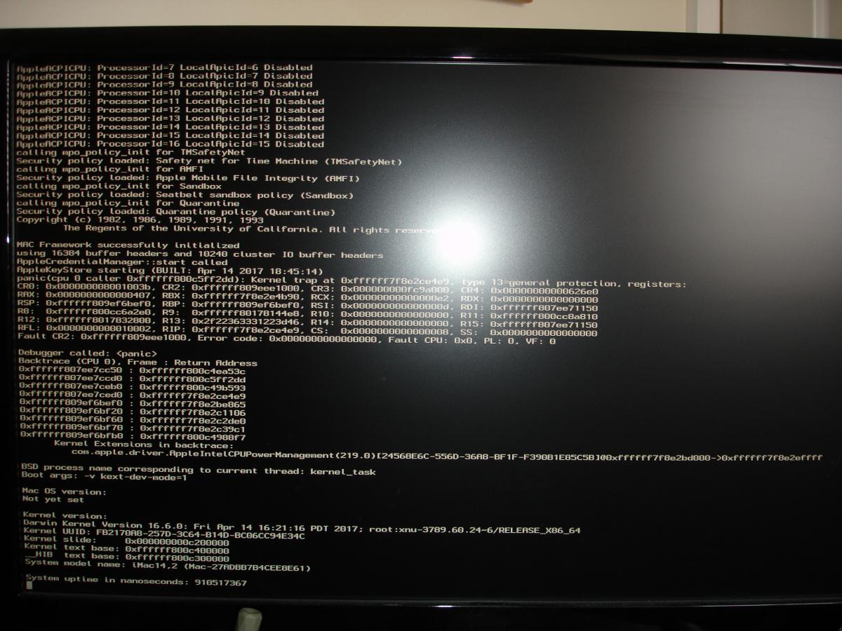

Hello guys,
Whenever I use the DSDT from the first page, my Optiplex 780 either panics with this message or it boots up but neither mouse nor keyboard work.  The minute I boot without the DSDT, everything works great but unfortunately that disables sleep/wake.  Any thoughts ?   Here is my config.plist
Thank you

Obviously, you didn't follow the guide to the letter…
Your config.plist i wrong. Use files from DSDT_and_config_for_Optiplex990.zip (DSDT.aml goes to CLOVER/ACPI/patched) and put kexts from 10.12.zip in CLOVER/Other.

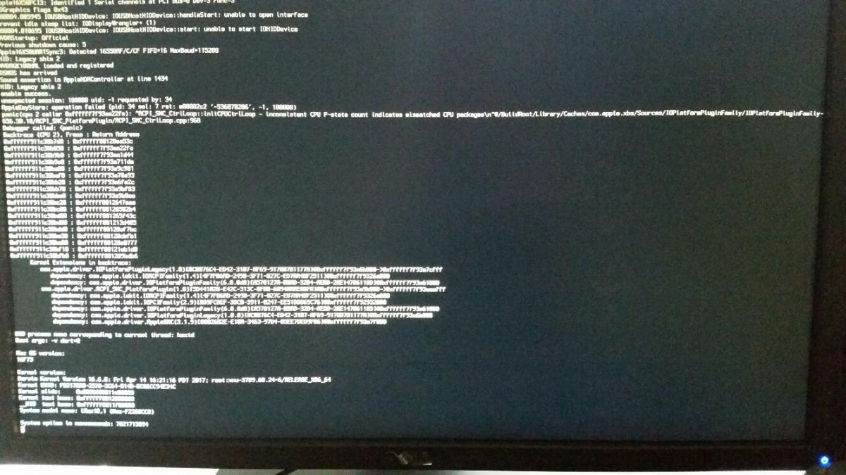

I've now managed to get Sierra 10.12.5 installed (Optiplex 790 i3-2120 HD5450) using the legacy method and the 790 DSDT & config files. Its working well but I do have two problems:-
1) It goes to sleep but wakes up with no video.
2) It will only boot using the nullcpumanagement kext, if I remove it I get a kernel panic (see pic). Do I need to create an SSDT ??
Can anybody help with this ? I been trying for 3 days to sort these problems with no luck.
Thank you

Remove NULCPU
config.plist / Under
<key>KernelAndKextPatches</key>
<dict>
<key>AsusAICPUPM</key>
<true/>

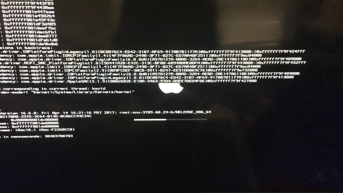

Guys, my 780 MT doesn't seem to be stable. Before I updated from 10.12.3 to 10.12.5, everything was stable. Now I get random kp upon boot. It's a hit or miss with it idk why. I've already tried other versions of fakesmc.kexts and that doesn't seem to fix my issue. I really don't wanna have to do a fresh install again because I have everything working with iMessage and FaceTime. Here's a screen of the kp

polyzargone,
I used the DSDT and kext you linked to before and it still panics.  DSDT for Optiplex 990 is compatible with my 780 ?
Guest ricoc90
polyzargone,
No, the DSDT for the 990 is not compatible with the 780. You'll need to use the one for 780, which you can find in #1
I did a fresh install with El Capitan this time around and the issue still lingers.. Anyone has any issues as to why that is?  It seems as though 90% of the time if I boot in verbose mode, I don't get the kp.

Sorry about that,  I have updated the signature.  I did try DSDT from the first page, unfortunately the same kernel panic.  Anyone can share a DSDT that works for you on a 780 and you are not using an ATI card.
Thank you
Thank you
Late reply, excuse-moi.
I had the same issue on my Optiplex 755, so I downloaded the P State Changer app, added the correct information to the CPU scope in the DSDT and that fixed it for me.
Alternatively, you can use NullCPUPM.kext, linked at the bottom of this post: http://www.insanelymac.com/forum/topic/312656-guide-macos-sierra-1012-dell-optiplex-780-760-755-790-990/?p=2444813
