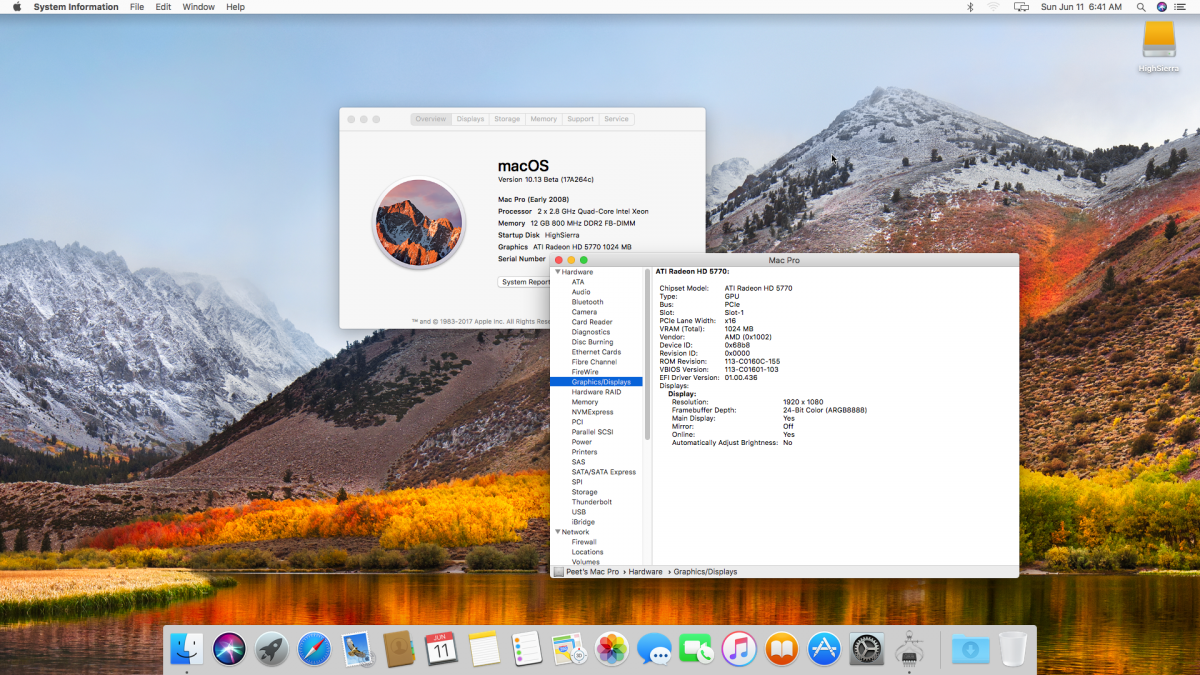

Only as info for the AMD problem:
The problem is not just for Hackintosh. My real MacPro3,1 with real HD5770 also Blackscreen. Only works without kext and without QE/CI.
With Sierra everything works.
With High Sierra - Blackscreen.
I hope the next beta's works better.

@polyzargone
The idea UEFI is good, but my real HD5770 in the real MacPro3,1 also has EFI bios and does not work anymore.
I've already tried rollback from Sierra, does not work either.
The problem is probably in coredisplay.framework.
